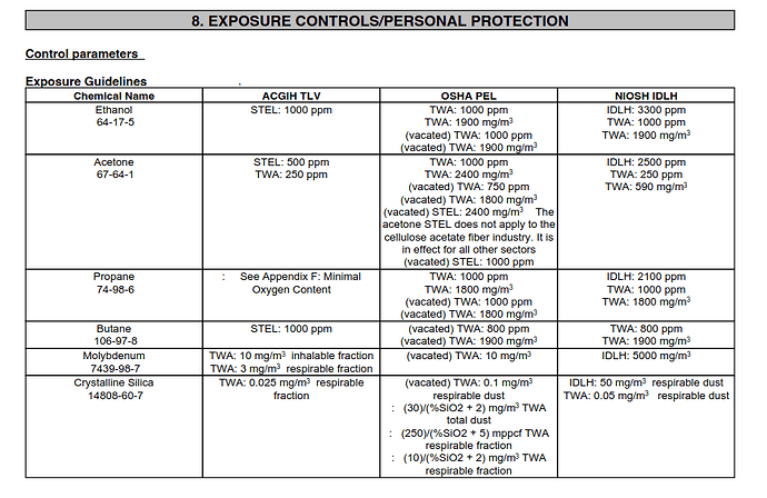

I have a 40W machine and have used LBT100 quite a bit on stainless mugs and porcelain tiles…
I think most of these use molybdenum…
This is from the safety sheet at Laser Bond Technology for LBT100 spray…
The only thing left after you lase it is molybdenum and crystalline silica.
Here’s a video you might like… on using molybdenum lube for marking metal instead of Cermark.
Good luck… let us know…

Read the first link… not a chemist, but I understand simple reactions and he seems to be correct…
I don’t think knowledge of something makes it less dangerous and in fact may help safeguard yourself.
How much are you going to be doing and how much does this produce to be a danger…
Read the link where the content information originated and they don’t recommend you eat it or breath it or it’s fumes… Wonder if the alcohol and propane isn’t as toxic :wink:
The facts are that when you lase anything, it’s not a good idea to breath it… I can attest to using a machine on vinyl and it’s results…
