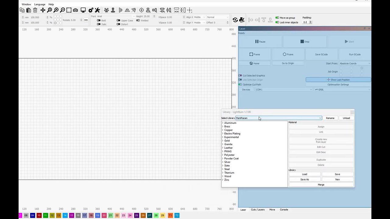

Updated to 1.6.00. Laser fire button will not work when lightburn is full screen. If I click the the two small squares in upper right of window and make lightburn smaller, the fire button works fine. Have gone back to earlier version and worked fine, Updated again and still will not fire on full screen. Windows 11, Atomstack S20 pro laser.
Hi Nels,
That is quite peculiar. Does the behavior persist if you maximize LightBurn but detach the move panel?
It does not. If I activate fire button with reduced screen and go to full screen, laser stays on but button will not turn it off until I reduce screen. If I move the move panel in full screen, fire button will work. I cannot then get the move panel to dock in place again so I can use the cut layers panel. Also when I try to get default layout it will first bring up a full library panel until I select default layout a second time. At times I will have to cycle through default layout a number of times as it will bring up lightburn in half screen, then full screen. My cuts/layers panel is extending into the laser panel on full screen and showing transparent where they overlap. I will try and take some screenshots after a bit and send them to you if that will help.

Question:
a) Window Menu > Reset Default Layout
b) maximize your Lightburn
c) take a full screenshot showing in view the move panel too please?
d) would you know what your screen resolution is ?
![Screenshot 2024-06-08 174042|690x387](upload://26wMXWzyajGlEPQ8V8ycOeDbuiB.png
Resolution 1366 x 768
Thank you NEls,
You have very little vertical pixels, I would suggest you stack on the right hand side tool bar in 1 instead of 2 sections that should help a lot
It was working fine with 1.5 versions. Is it something in the newer version? I am not familiar with stacking the panels, sorry.
If you click and hold the Label or the header of the Panels you can move them.
So click the Laser Red header and hold, then drag it up until you see a shadow above. then release and it should redock
Then you can also reorder the panels by dragging the label
Thank you for your help. I started using a new lap top at the same time lightburn update came out. Didn’t realize new laptop had such a low resolution. Thanks again.
