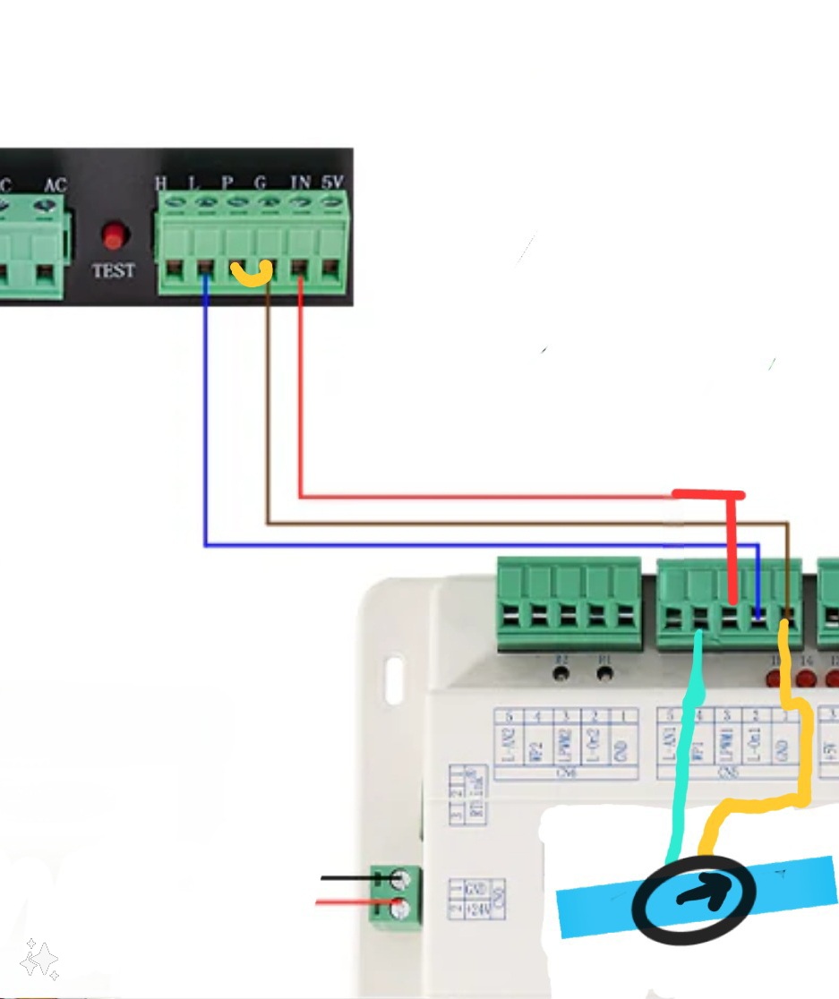

Upgraded from a MYJG60W LPS to a Cloudray M100.
-PROBLEMS START- Had to re-connect the high voltage to the tube. Not a huge fan of that process, but it’s on there solidly with an rtv silicone and tubing cap. The other (less terrifying) wire is just reconnected with a wire nut. It’s on/reconnected, and the laser still works…
But now it fires while doing a “home” or “frame” command, both via PC/LightBurn and directly from the controller screen.
After reading and watching every video I can find, it seems likely that the “L” port on the power supply may be bad. A few Amazon orders later, and it’s the same thing with two other new LPS: MYJGG100W & CLOUDRAY DY13
Well, maybe I messed something up on the tube? Went ahead and put in the upgraded 100w tube. (I know introducing a potential new set of problems isn’t the best, but I was out of ideas.) I 3d printed an extension box and low profile mounts to get it lined up with the current mirror height. Lined everything up, and got a nice focused pulse test dot.
Same thing. It’s firing the laser (at a low power) when doing a frame or home.
I then replaced every wire and end crimp in between the lps and controller. No change.
Upgraded the controller firmware. No change.
Reset to factory parameters. No change.
Checked that it’s set to “Low” instead of “High” in the vendor settings.
I’ve been down every forum post I can find, and here’s where I’m at:
- PWM is set to a low value by the machine while doing movements between cuts
- The L-ON1 connection from the Ruida controller, connected with the L port on the power supply is supposed to tell the laser when to engage.
- The LPWM1 connection on the controller tells the LPS what “percentage” to fire at (I know it’s not exactly that simple, pulse width and all that).
- The L-AN1 connection on the controller can be used instead of LPWM1, but it’s the analog version, some configurations I’ve seen use L-AN1, and some (including the original wiring in our machine before the LPS upgrade) use the LPWM1 connection.
- All of the connections on the controller side of the LPS wires are outputs, and the connections on the LPS side of the connection are inputs. The LPS is expecting “Fire / Don’t Fire” from on it’s “L” connection, and “How strong should I fire” on the “IN” connection.
When I do a “Check TL” test on the controller panel, I get “Power 1 Communication Failed”, but I haven’t been able to find much documentation on that particular test.
When I cut something, it will do the full cut, but leaves a ghost engraved line between shapes.
My current top suspect:
- I think the L–ON1 port on the controller (or the connector), or the L-ON logic on the board is dead or messed up.
The same thing happens with multiple LPS, multiple tubes, and completely new wiring. I would definitely prefer this to NOT be the case because controllers are expensive, so I’m hoping someone can help with any new ideas or troubleshooting to try!
I haven’t done any multimeter testing so far, since my electronics experience is firmly in the “not hooked up to any power” category. I think I have one, and can use to troubleshoot if needed, but I may ask some really basic questions on using it.
I also went down a 1am frenzied rabbithole trying to use the CN6 port on the controller, enabling only “Laser 2” to see if it’s the L-ON1 connection for just CN5. I wasn’t able to get it to fire at all that way, but it wasn’t the most coherent attempt, and I couldn’t find documentation on anyone using that configuration, so IDK if it would even work in a perfect world.
