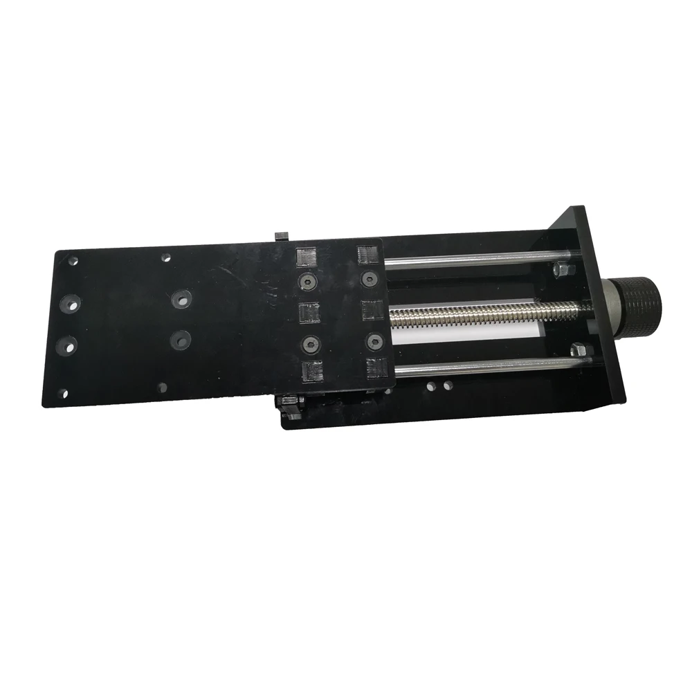

For my adjustable focus laser I did something like this:
But using this:
And for my fixed focus laser I use one of this:
Hi Tribo,
I have a variable focus CNC 3018 device. I hope to make an add-on focus wheel when Santa has been with my new 3D printer.
