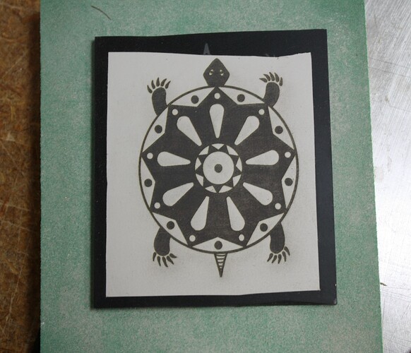

It would be near impossible to burn away the mirror backing without etching the glass. To get the image into the mirror with the glass staying window-clear, I basically burned a mask.
For this test sample, on a scrap of mirror (standard home center mirror tile), I applied some common contact vinyl shelf liner with a peel away backing that exposes an adhesive side.
The mirror with the masking film was placed under the laser with the power setting set such that the vinyl was mostly burned away.
The masking protects the area of mirror backing that I don’t want to remove.
You can see the backing (black area) exposed.
With some muriatic acid (pool/cement cleaner from the hardware store), I dripped the solution onto the burned areas, enough to cover the area but not start running all over the place.
As it began removing the remains of the vinyl adhesive and the mirror backing (aluminum I think) I would use a foam brush to gently sweep away the loose material. Occasionally I’d use a paper towel (wear gloves) to sop up the liquid then rinse the mirror off in the sink to check the progress. If the removal had not yet completed (looking for crisp edges), I’d apply more acid and work it some more.
The masking prevents the acid from getting to the mirror backing.
Here is a photo of the results with the outer area of the backing peeled off.
The tiny areas of masking take some more care with the tip of an Exacto knife to prevent scratching.

Note that since this image has interior details, I applied the vinyl to the mirror before burning with the laser.
If you job is a simple “hole” in the mirror, you could do it easily by placing the vinyl shelf liner directly under the laser and cut the opening out. Peel off the backing and stick this to the mirror, etch, and be done! I used an ink roller gently on the vinyl to make sure it had a good, smooth application with the mirror and there was a good seal around the etching area.
Nice thing about this second method is you don’t need to be as careful with the laser power setting as you are just trying to cut the vinyl cleanly.
