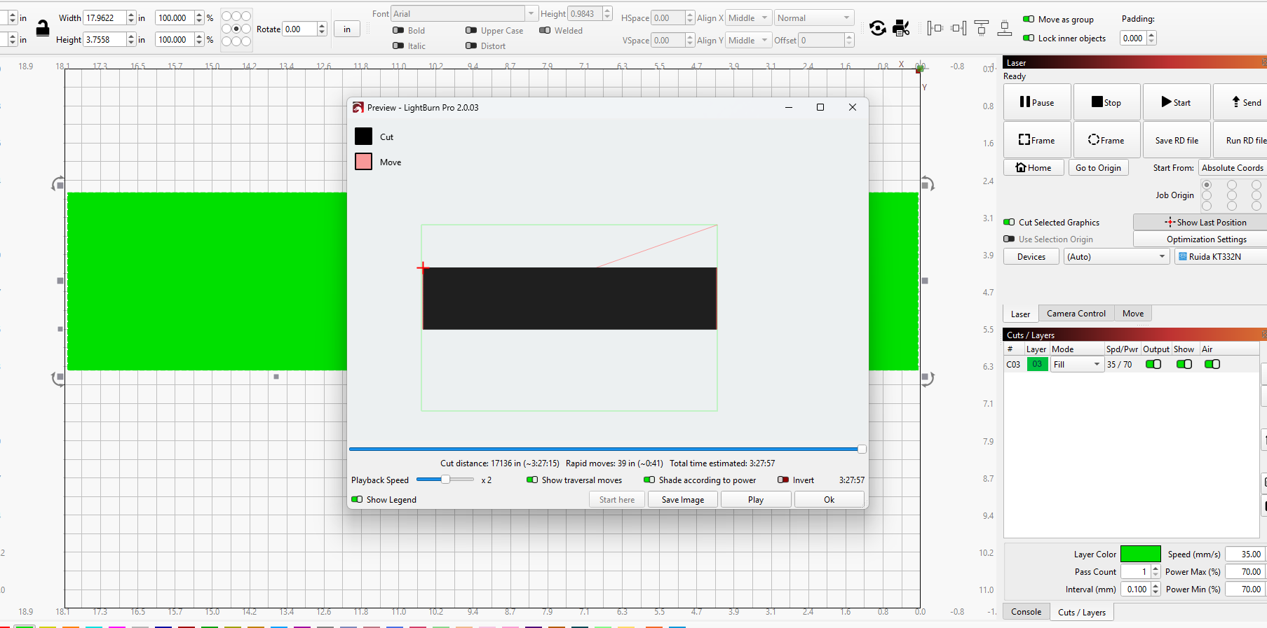

You can preview this on your computer to see how far it’s going. This shows how much overscan there is between 1000mm/s and 500mm/s. Both rectangles are 50x100mm.
If you look closely to the left one, you can see a green rectangle, this is your defined work area.
Without a screen to tell me what the error is, I’m guessing that this is it’s problem.

Thank you for your response. I checked the overscan to determine if that was the issue. In fact, I started a completely new project with a much smaller design and I am getting the same result.
