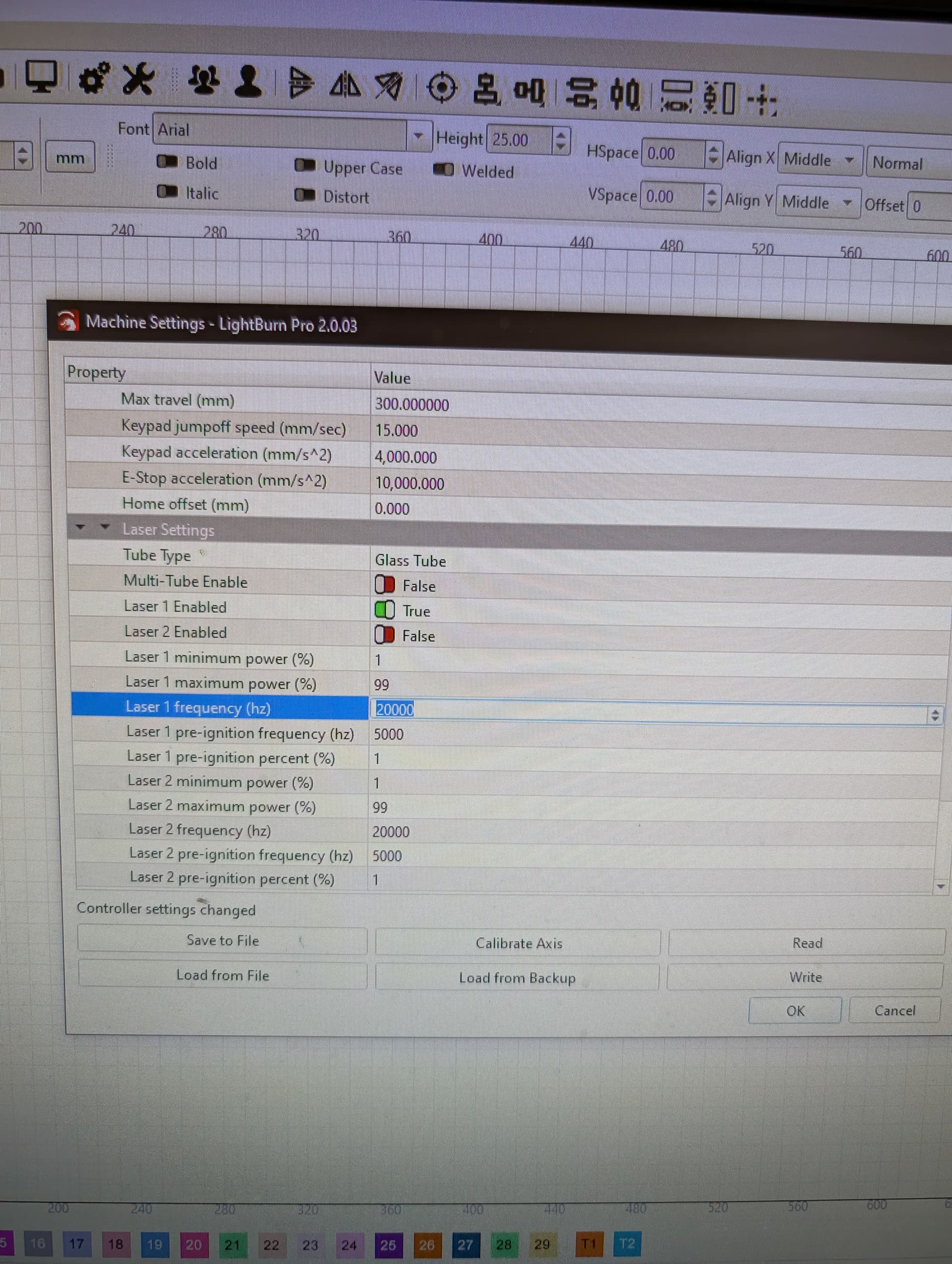

Laser frequency settings in lightburn
If we have a glass tube laser, do any of the settings in this page have an effect?PXL_20250930_105703153|376x500
If that is what is showing in your Lightburn, I would say all of them do. That is why they are there.
Those are set and forget settings. If you are thinking of changing them, DON’T! Not until you know what they are for and what will happen if you change them. And make a backup no matter what you do.
The Laser x frequency values control the corresponding carrier frequency for the LPWMx outputs to the high-voltage laser power supply IN terminal. The power supply isn’t too fussy about the PWM frequency, but the default works fine and there’s no reason to change it.
The pre-ignition entries apply to RF tubes and probably don’t affect the glass-tube output, but ya never know.
The Laser x min power and Laser x max power limit the power settings in the LightBurn layers. It is unclear whether the controller clamps the layer power or interpolates the entire layer range to fit, but there seems no good reason to change them.
The Ruida manual for your controller may include more verbiage about some settings:
Pre-generation pulse scale: When the laser is RF-laser and it’s need to pre-generate PWM, then set the Pre-generation Frequency and the Pre-generation pulse scale.

Well, we did change the frequency setting; we read somewhere that 20KHz was fine for acrylic, but that 5kHz or even 1kHz might be better for MDF.
So we tried it…:grin:…and it is! The cut edge seems far sharper and smoother. We cut hardly any Acrylic by comparison, so we’re sticking with it…just remind me in 12 months when I come back to say " acrylic is not cutting properly" that we need to changed it BACK to 2okHz!

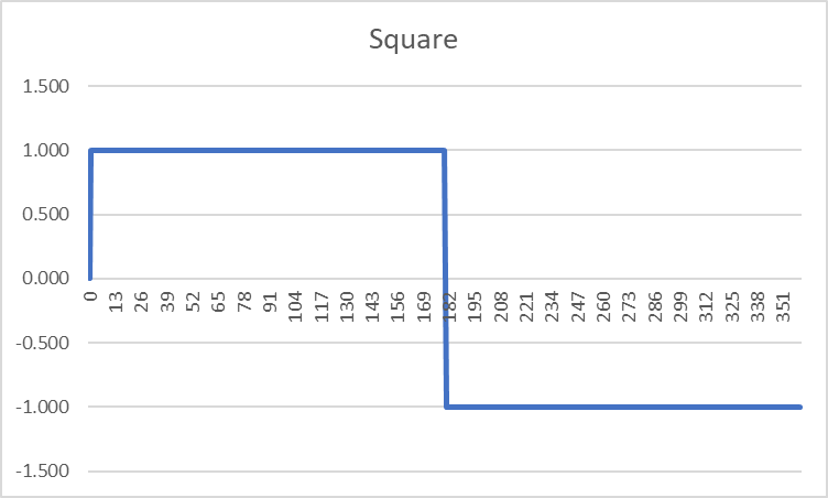

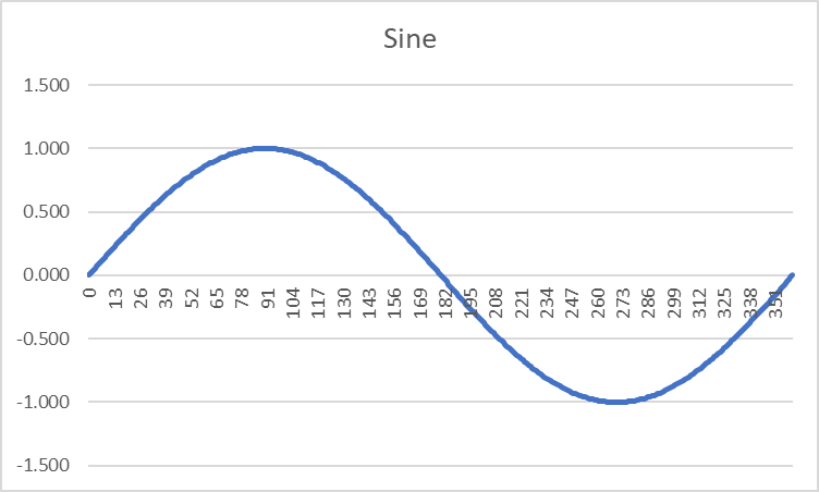

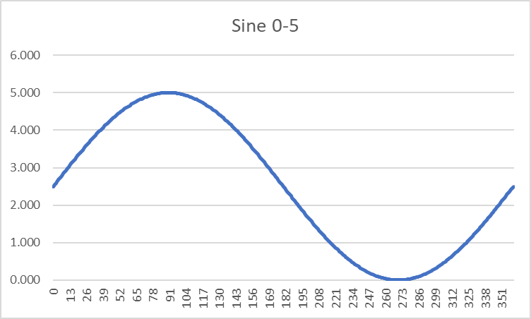

I was trying to make the adjustments to my Excel-generated graphs to give the correct 0-5 volt values. I understand maths more than electronics, so this helps me visualise what Ed and Mike have been kindly trying to teach me…
The sine wave was easy*; the excel formula is;
=(SIN(RADIANS(A2))+1)/2*5
All you need is to put the values 1-360 in column A starting at row 2 and the above one cell to the right in column B. and you get;

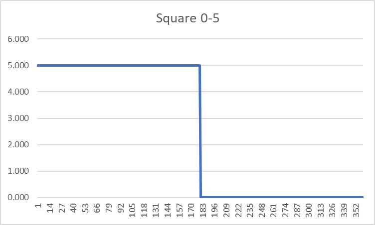

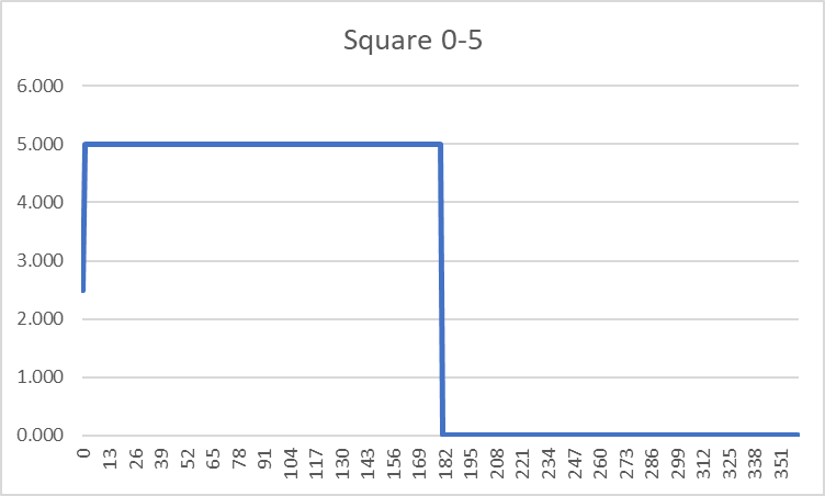

I’m struggling a bit more with the square wave…this formula;
=((ROUNDUP(SIN(RADIANS(A2)),0)+1)/2)*5
produces this graph
Which at first LOOKS right, but the values where sin() = 0 give a result of 2.5.
Now I THINK this may be closer to a “real life” interpretation of a square pulse wave rather than a precise mathematical one; in maths, the values should be 0 or 5…but in reality, there is no such thing as an “instant switch” from 0-5…it takes a non-zero amount of time, (even if it is measured milliseconds). Which gives rise to the other property we often see in Lightburn - “PWM Rising Edge Valid”.
Am I right?
*easy - for me. I’ll admit the need to convert to radians is a pain…I understand why Excel uses it, and it has it’s place…but it also adds a barrier to those with high school education who pretty much were taught exclusively in degrees.
If you were to write the formula in your maths text book it would be;
y=(sin(x)+1)/2*5
You can simplfy it further to
y=(sin(x)+1)*2.5
but I find leaving it as the original explains more what the maths is doing which is;
Sine values run from -1 to 1. We want a voltage output range of 0-5v. The easiest way to do that is to first get a range of 0-1, and then multiply by 5. (so now we know our last operator will be *5).
And to convert a range of -1 to 1 to a range of 0-1? Well first, we bump it up the axes by 1, so the range is 0-2…and then simply divide by two to get our 0-1 (which we can then multiply by 5)
Ha! “Pride cometh before a fall” says the Bible. The error was all mine…I’d put the values 0-360 in column A…but of course as far as the sine function is concerned, that’s a step too far since 0 and 360 are the same “point”.
1-360 and it works perfectly!
Looks kinda wrong though…your brain wants to “fill in” the missing rise or fall…but if you extend the graph to three cycles (1-1080) it looks like the pulse wave you’d expect…

I accept we have a glass tube not an RF laser…but is it beyond the realms of possibility that this “Pre-ignition” value is some sort of “warmup” value that might allow firing at lower power settings?
IMO, no.
The KT332N in my machine has three choices of Tube type:
Evidently you (well, I) must select RF (with pre-ignition) in order for those values to take effect, which suggests the controller does not apply them for the other two choices.
Given that the machine has a glass tube and I’ve never changed those values, if they are doing anything, then they should have been doing it all along.
However, none of the myriad scope shots I’ve taken show anything other than the ordinary 20 kHz PWM carrier. Nothing else appears at any point in a scan line.
The power supply doesn’t know anything other than what arrives on its enable (H or L) and IN inputs. The controller disables the power supply when it’s not supposed to be firing and that works exactly as you’d expect: an active PWM signal does not cause any tube activity when the supply is disabled.
Selecting RF (with pre-ignition) should apply them. Assuming:
  • The controller enables the power supply when the tube should be inactive
  • The pre-ignition percent is high enough to fire the tube
Then the (glass) tube will fire when it normally would not. However, because RF tubes do not fire under those conditions, I’m reasonably sure the laser head will be in the wrong place when the glass tube fires.
If you make the pre-ignition frequency low enough (under 100 Hz) to have the power supply regard the PWM signal as an analog input, then the tube will probably fire at the peaks of the PWM signal. The head will still be in the wrong place, but maybe it’d be close to what you want.
So, sure, try it and see, with the caveat you must survive a brutal case of confirmation bias while doing so.

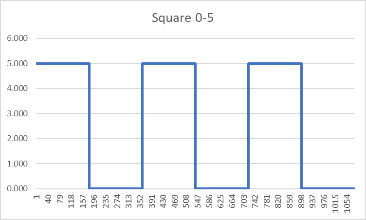

No, imagine the On time gets longer as the Off time gets shorter. The spacing of the pulse rises occurs at a constant width. with a constant frequency. I am pretty sure my Diode has a PWM frequency of 1500KHz.
Sorry, I answered this before seeing the other posts.
