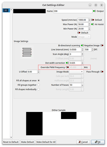

MikeyH had stated lightburn does not change the frequency, however when it does the material test it does burn in the words frequency 20kHz, and on the above override box on mine it has 20kHz if i turn it on……
was hoping a lightburn developer would chime in here?

If you want to change this, it’s best done via the Machine Settings gui under the Vendor settings tab.
I don’t know where Lightburn gets their period information.
All of the cut and lettering information in the material test allows a change of pwm period.

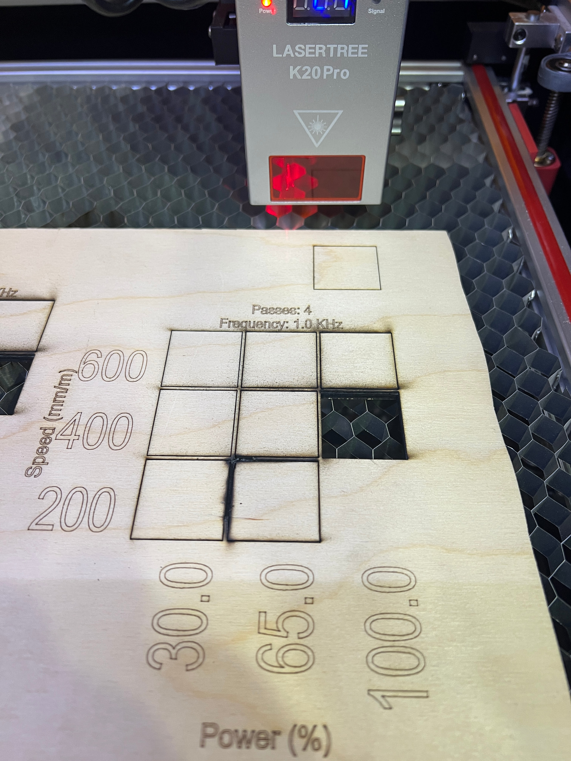

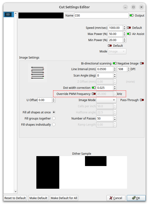

Ok was playing around some more this Am,
did a 3x3 grid of 30mm squares. selected 30-100 power and 200-600mm/m
best cut was at 400mm/m and 100% power, so i made a 30mm square and used those settings, did not cut even 1/2 way through? ( see box at top in pic) So something is defiantly different… I also went into the advance settings and enabled over ride freq set to 1k than disabled, this basically just changed what was written…..was engraving 20kHz, after the change engraved 1kHz, made no difference in the cut. So still at a loss as to why?

If you are using different values for minimum and maximum power these are controlled by the start speed setting. Have you checked those.
You are running very slow, the Ruida works in mm/s, I know yours is set to mm/m, so I don’t know what the Ruida is actually doing. Mine doesn’t have an option for mm/m, it’s all mm/s.
:grinning_cat:
Hi jack, yes i did state that i tried different power levels, even in the above pic it shows 3 different power levels being tried.
No different values for the different power levels.
As for mm/m, just easier for me to calculate, ruida still shows mm/s when running. So if I have at 200mm/m ruida shows 3mm/s.

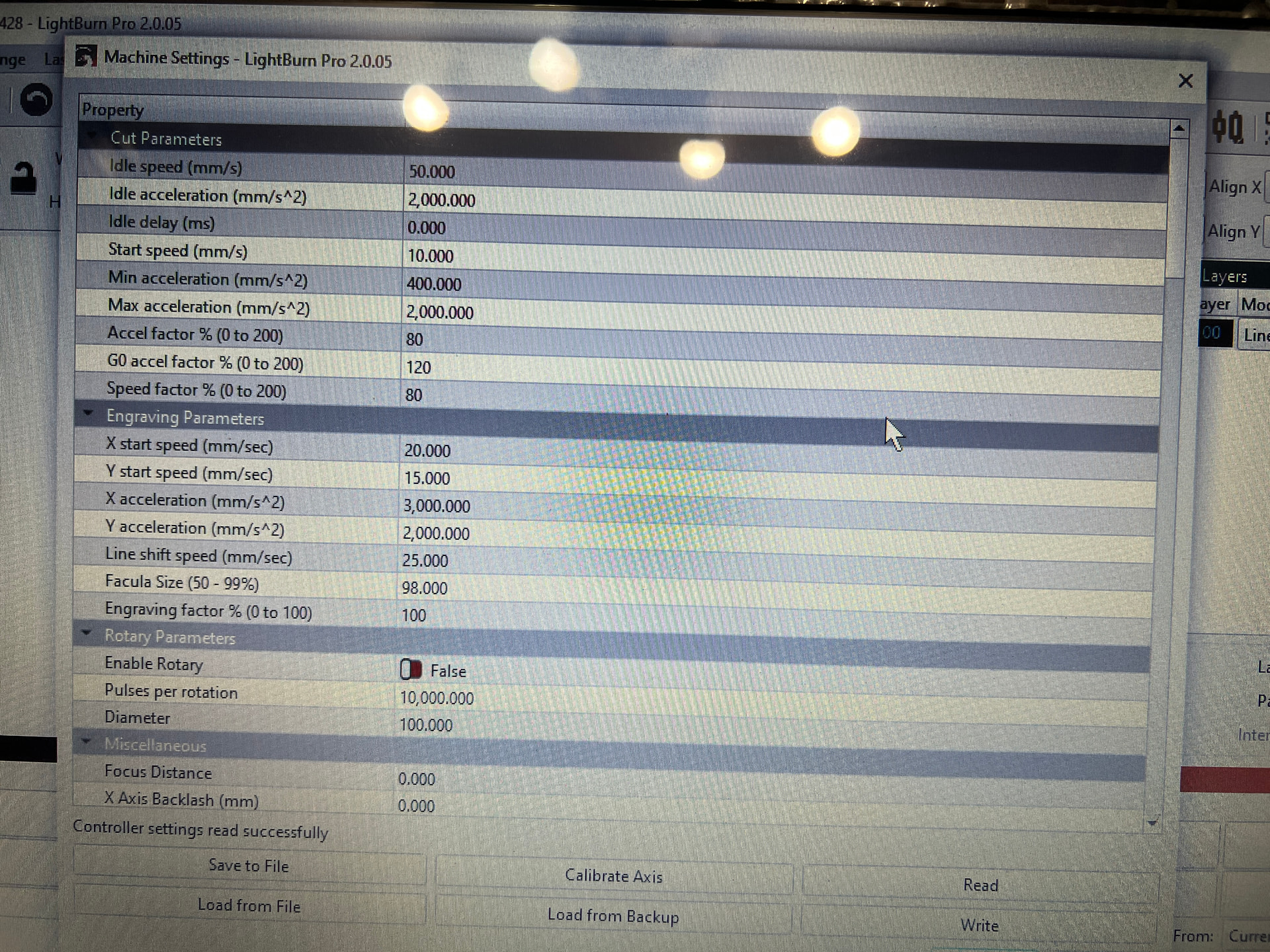

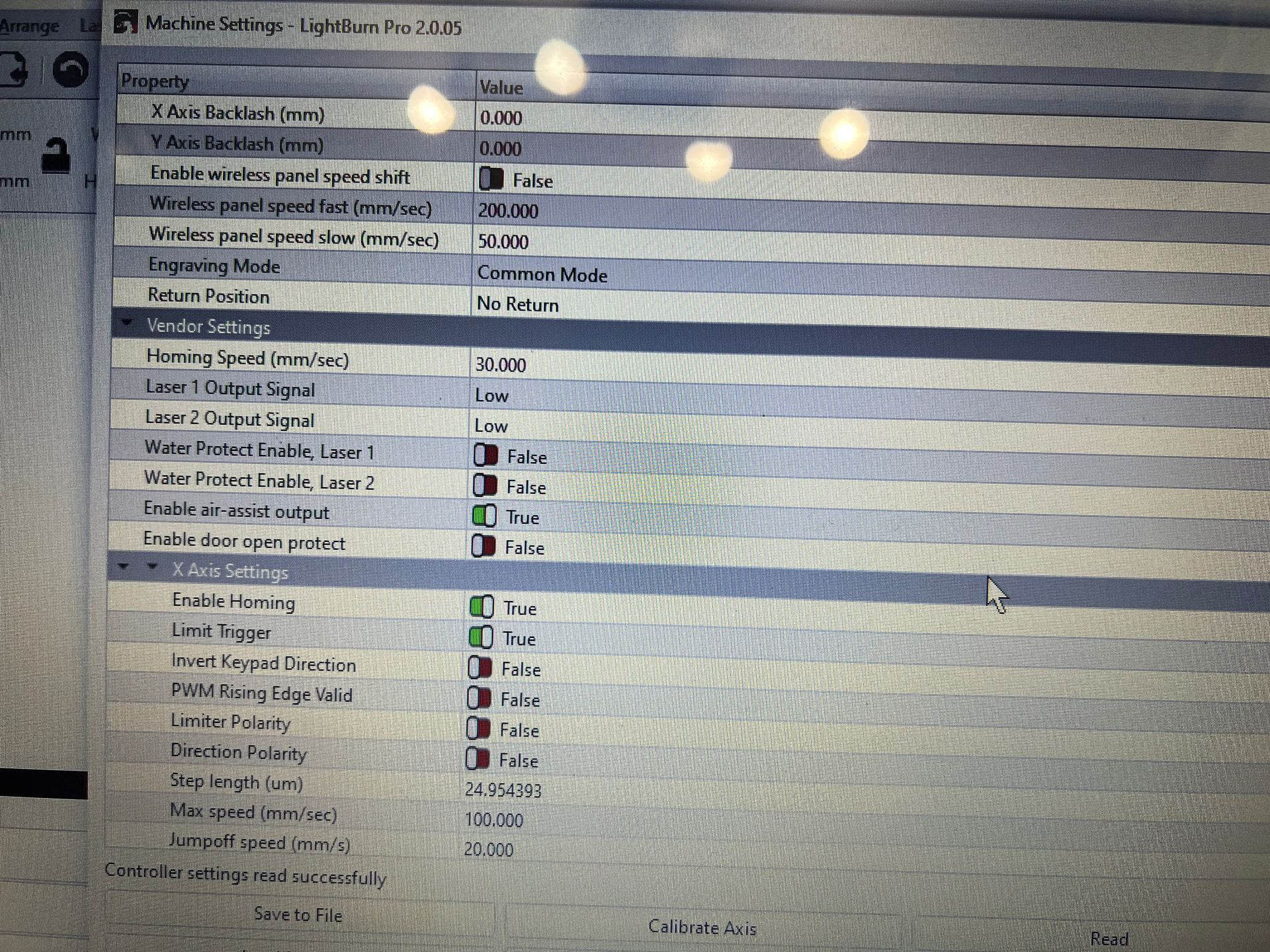

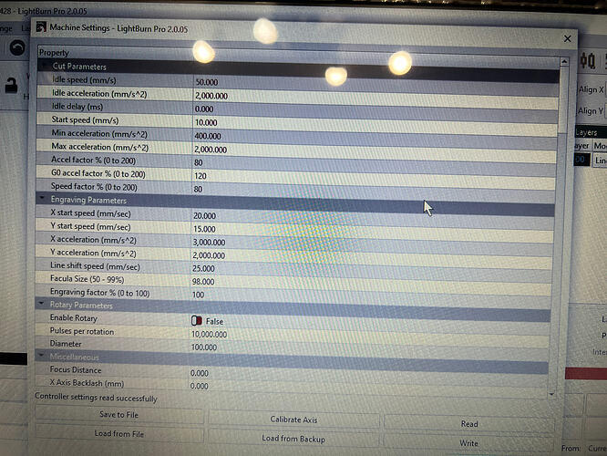

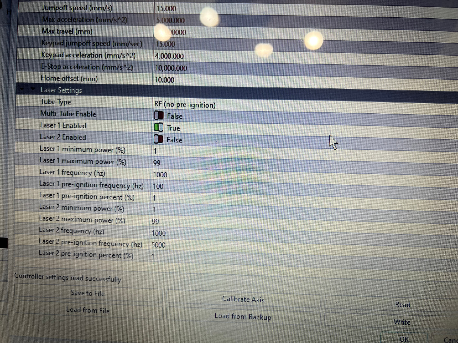

Here are the machine settings.. did not include x/y/z/u
randy
Suggest you set both X and Y axes start speeds to less than the 3mm/s you’re running. At this point, I’m still thinking about what could be going wrong.

Update to the solution for others that may run across this situation.
Lightburn disregards the material cut file section and any settings in the cut/layer section while performing a material test. It only powers the laser at the wanted power% and ignores the min setting.
So if you select 80% power, it will do the entire cut at that level and not lower to Min for corners etc. this is what had changed between the material test and the manual cut that was failing, by increasing my min to 50% from 20% corrected the cut.
