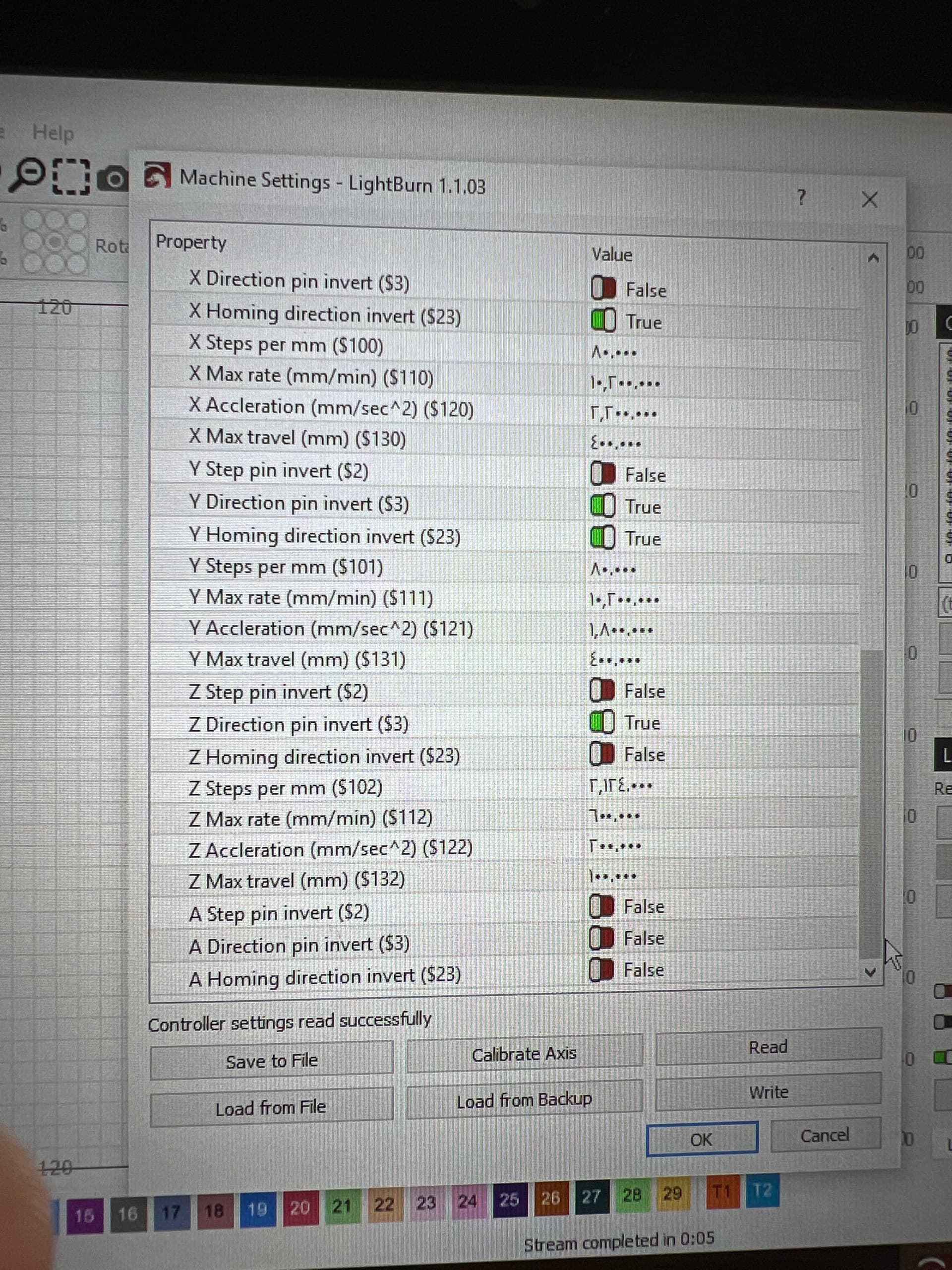

My laser homing is correct but once I try to start working in the midle it will move the laser head so far and start hitting the frame of cnc making loud noise
sounds like you have either the bed size set incorrectly, or the X and Y axis dimensions in machine settings. Assuming it’s only hitting the opposite sides to the limit switches. if it’s also hitting the side the limit switches are on then they are not working as intended
Could you please send me the correct setting
These are my settings
Have you made any configuration changes? Ortur lasers should work correctly out-of-the-box.
Was this working at one point? What’s the situation?

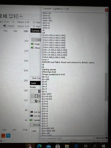

I enter some codes after watching a youtube video in cosole which is $22=0 then I enter the other one $22=1 and if it this issue hwo could I reverse these code
Is there a reason you were trying to change the homing direction? Normally there’d be no need to do this.

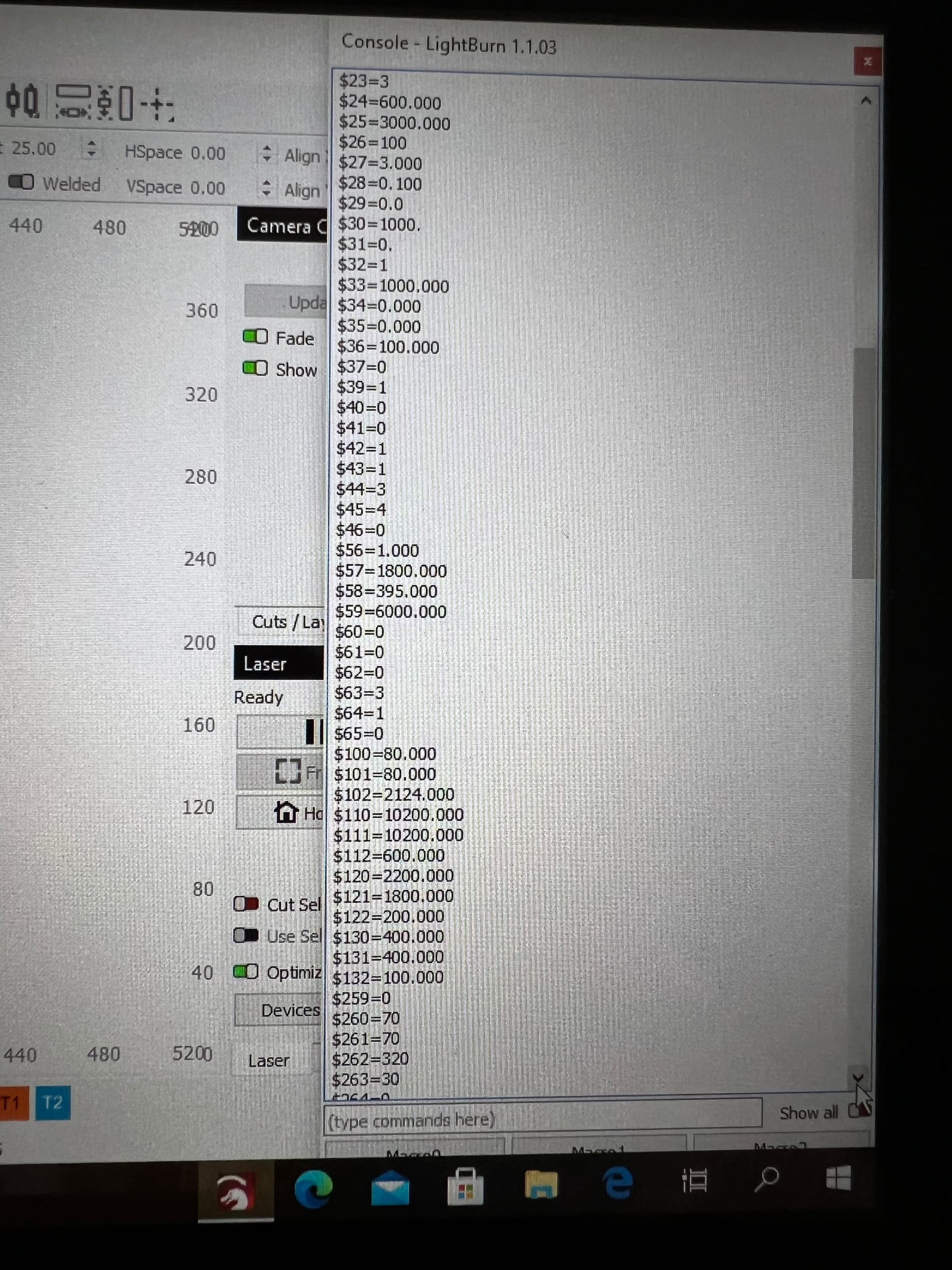

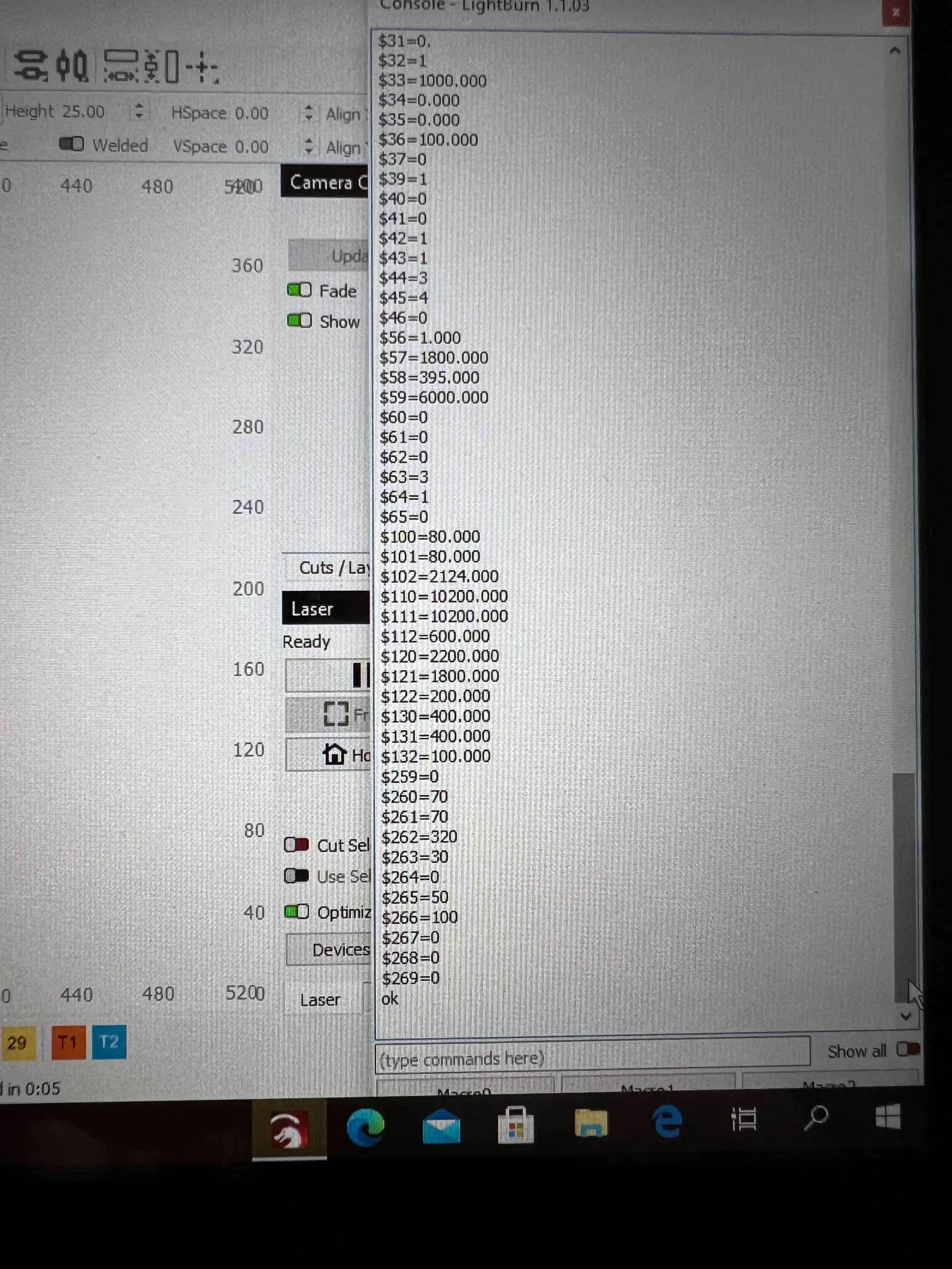

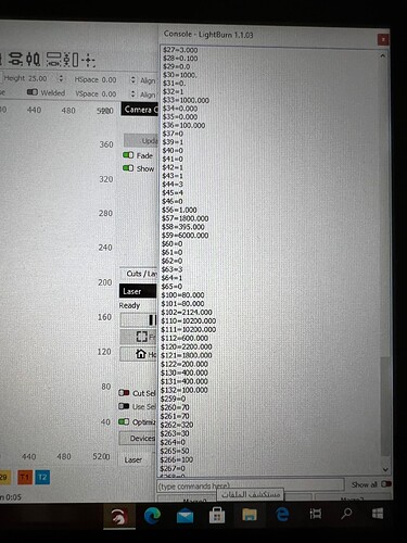

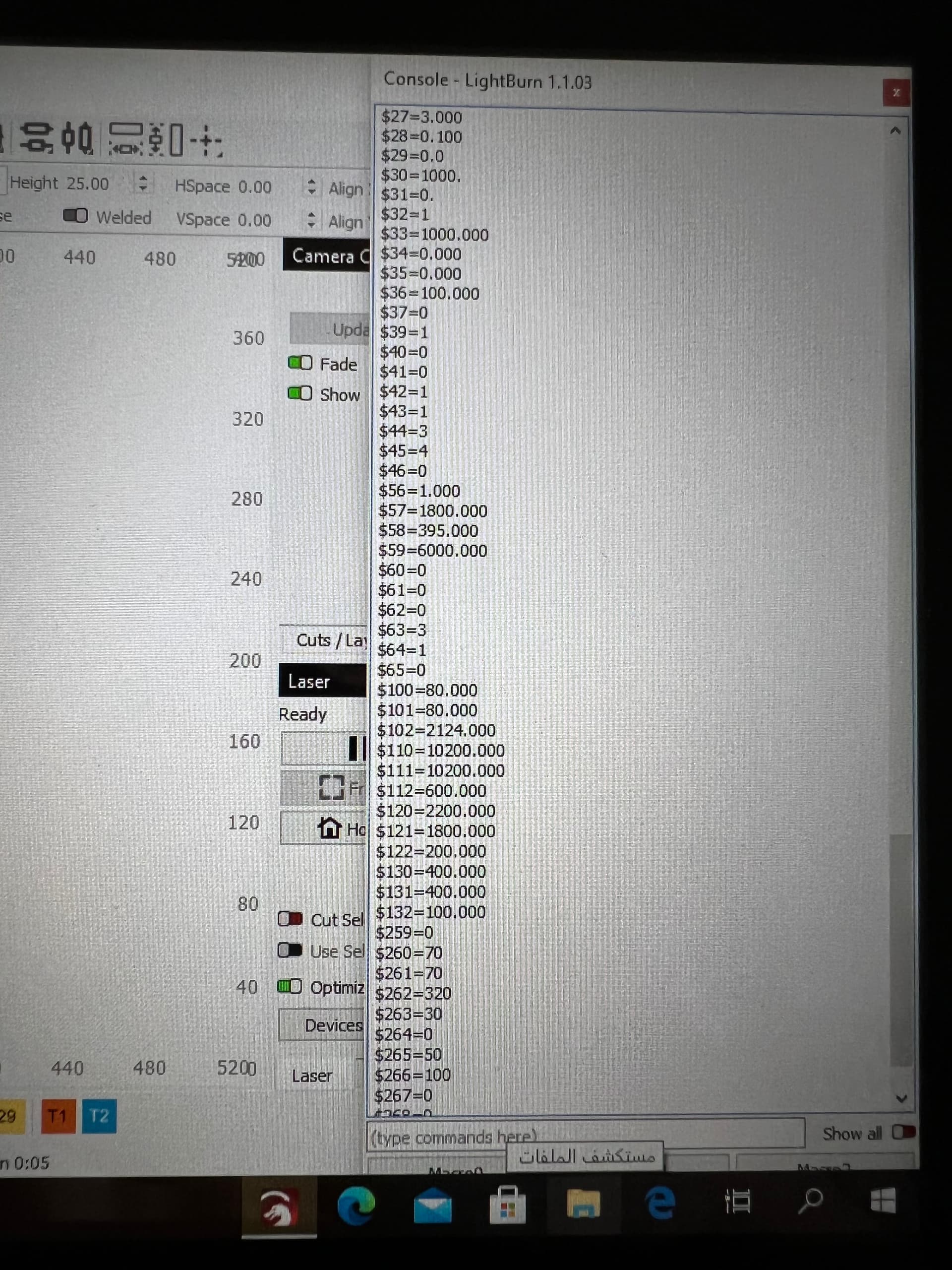

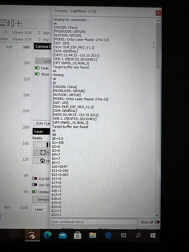

Can you run these commands in Console please:
$I
I enter all the codes but I still have
the same problem

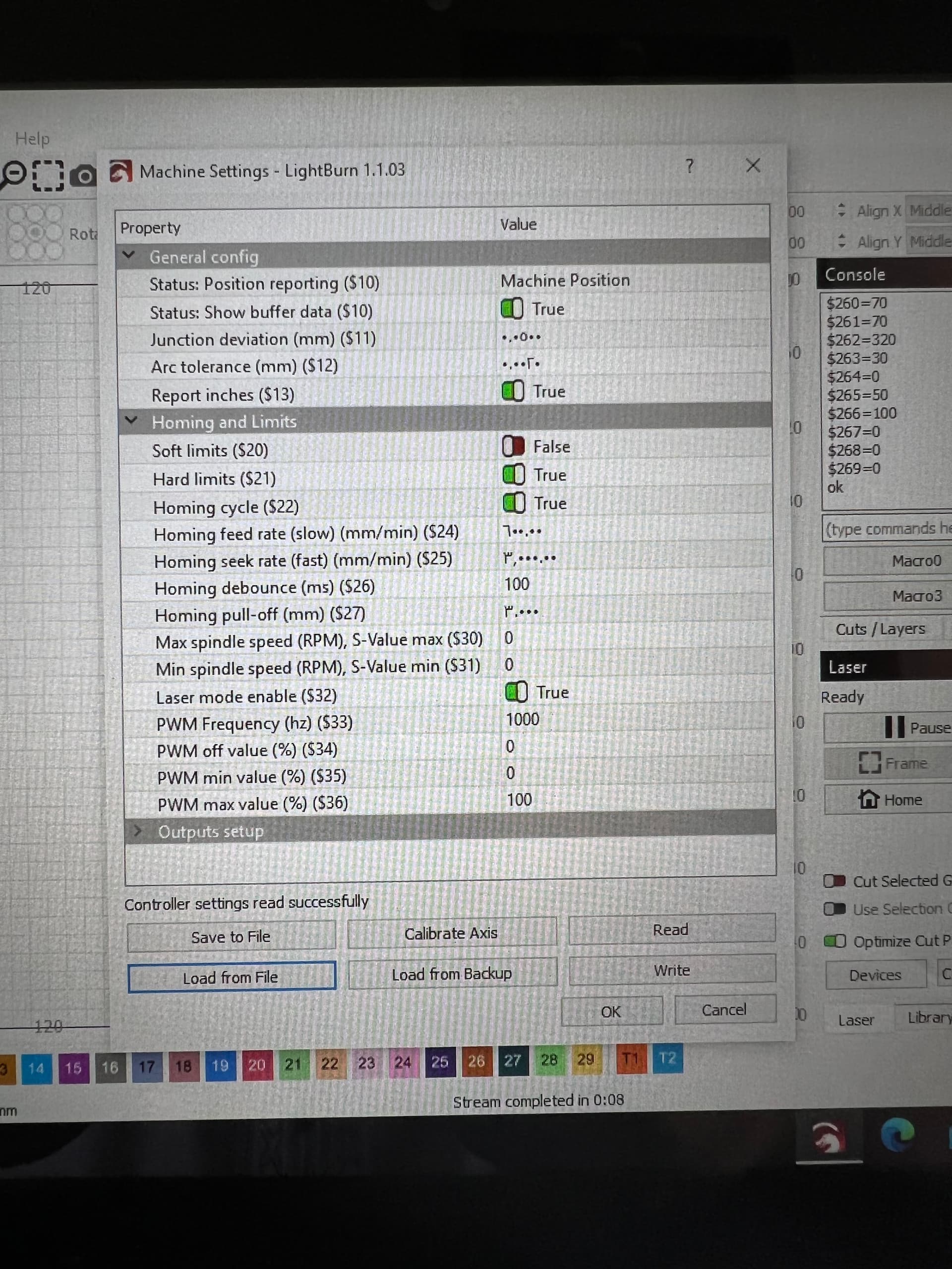

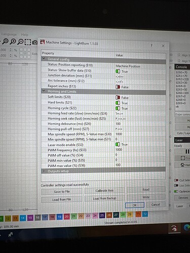

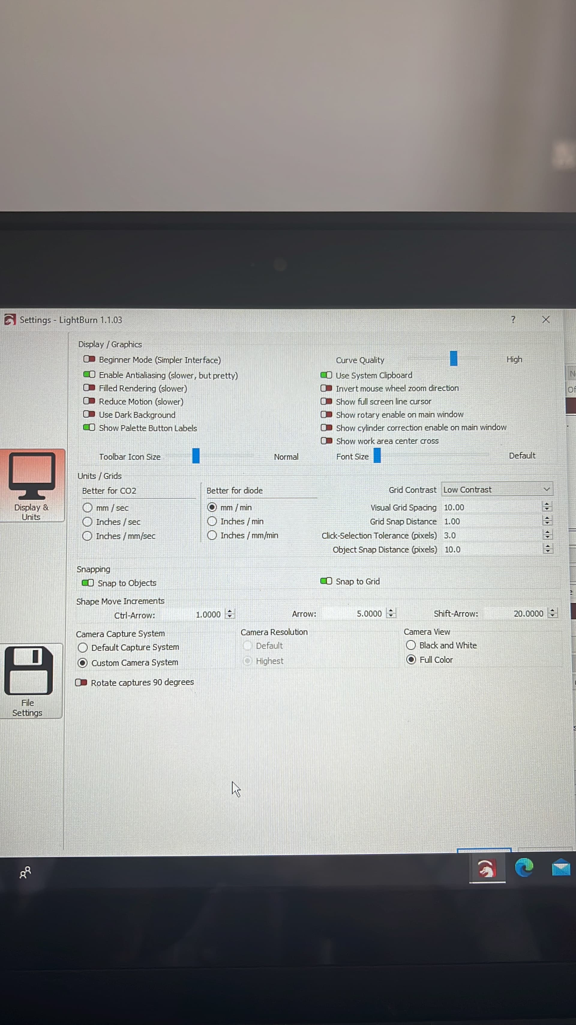

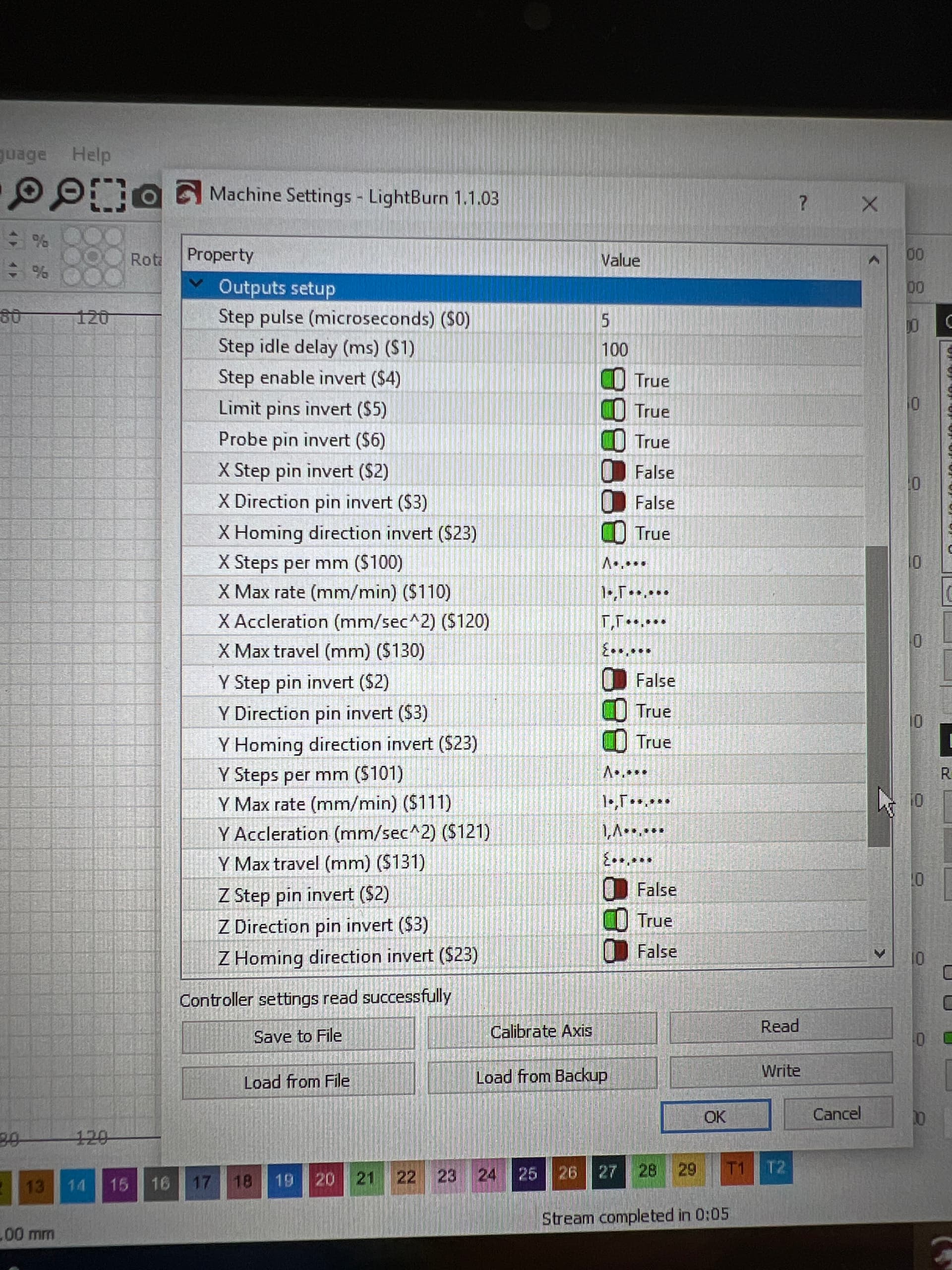

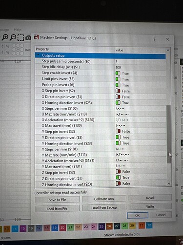

These are my machine settings
I wasn’t offering a fix, it was to get information to help troubleshoot the problem.
A few tips for going forward. If you need to get information from the computer screen, don’t take a photo, take a screenshot. If I ask for information that’s in the Console, copy the text into a reply, not a photo or a screenshot. Will make it much easier to get the details required.
I do not see anything majorly wrong with your settings from what I can see.
Minimally you should re-enable soft-limits. This will hopefully reduce the chance that you will crash into the walls. Enter this into Console:
$20=1

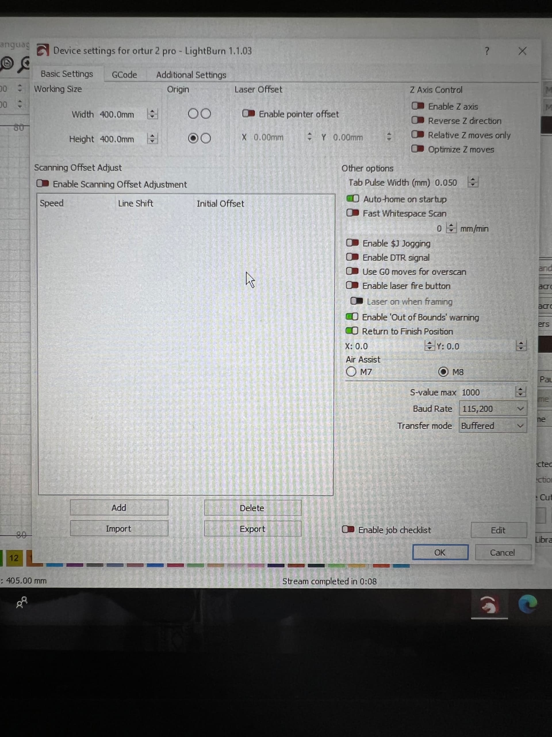

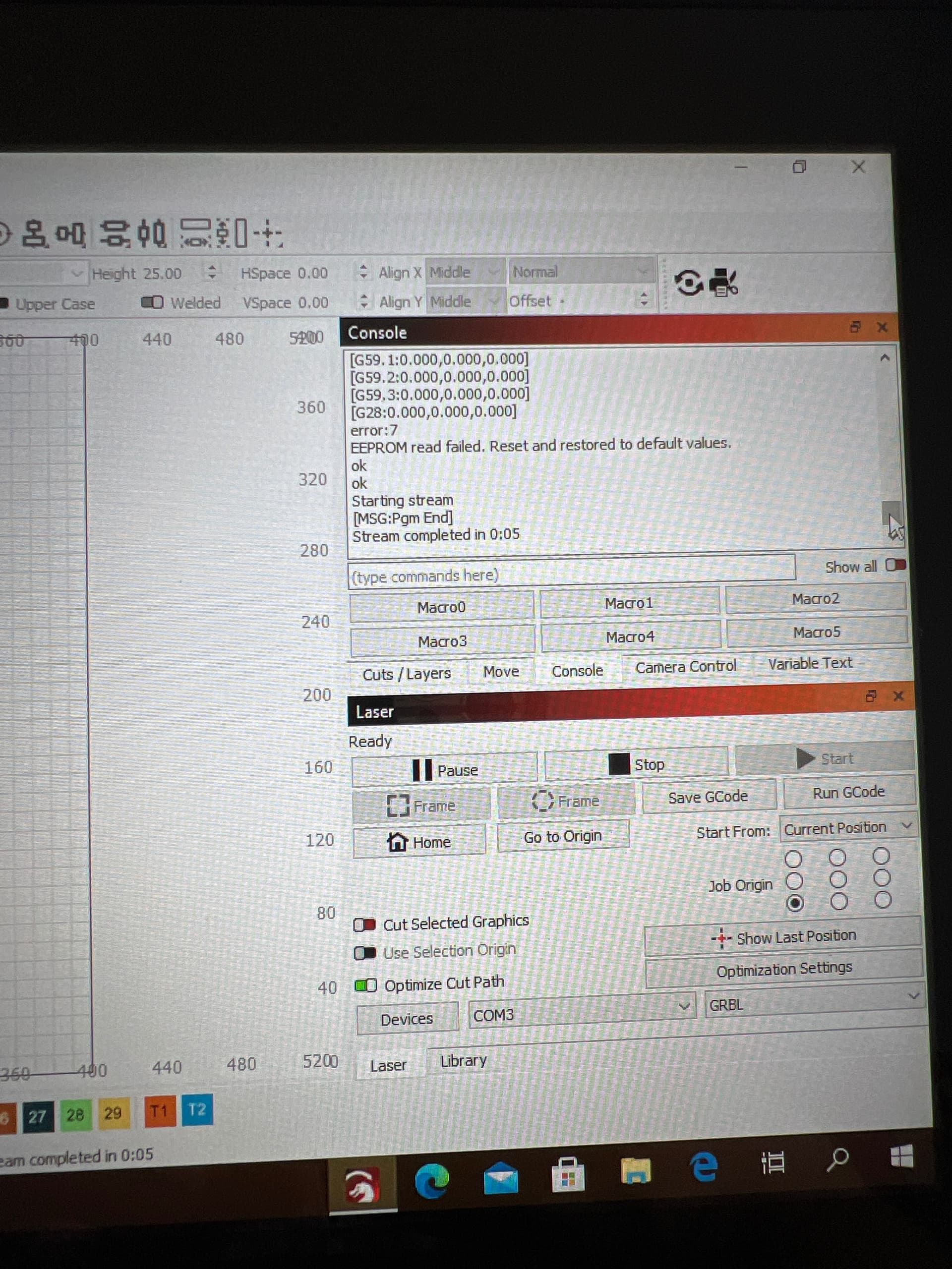

What exactly are you doing when the laser is hitting the frame? Can you explain step-for-step the setup?
Also, what is your setting for “Start From” in Laser window? Can you take a screenshot there?
