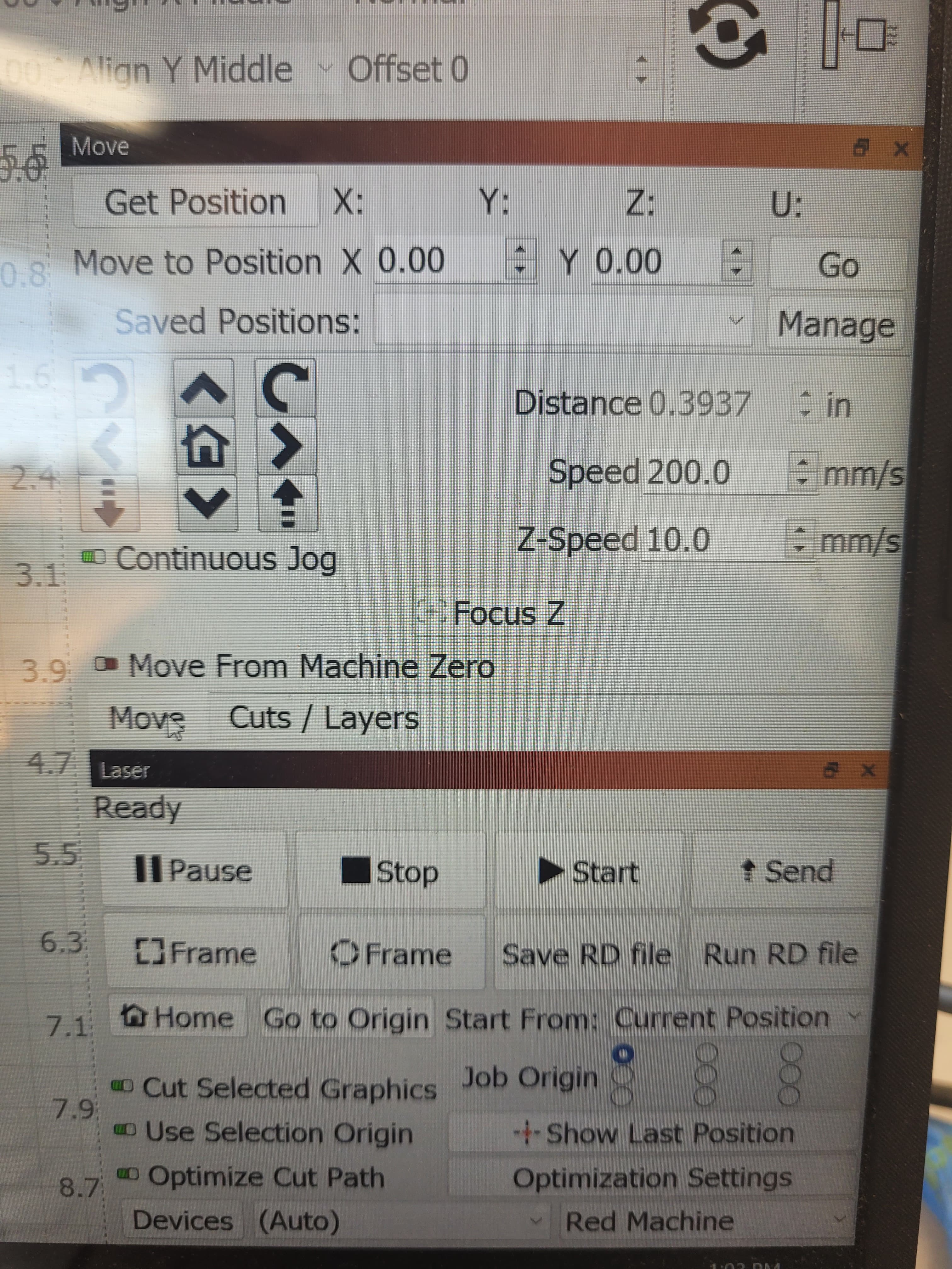

I have a omtech 100w machine with ruida controller.
I’m having difficulty with the laser movement between items.
Like doing a production run of smaller ornaments.
The Movement before it begins to cut, moving between the different areas is slow, and the return to start position as well.
Framing and toggle movements are fine I make those adjustments either on the controller or in the move category on Lightburn.
It does not seem to be a “White Space” issue. Unless i’m confused as to what the white space means.
How can i increase this speed? its got to be something easy that i’m just overlooking.
I’ll try and post some pictures/ video.
Thanks friends.

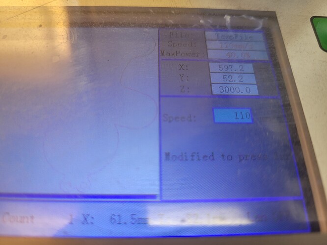

The toggle speed is set to 110 mm/s
Frame speed 200 mm/s
Run speed. 18 mm/s
Go to Edit->Machine Settings and check Idle Speed and Idle Acceleration. What are those set to?
Looks like 20 to me.
(I’m running 300 with no trouble)
Are you talking on the idle speed?
yep that was it. Not sure how it was changed. but i put it to 200 speed instead of 20. and that fixed me right up. Thanks
