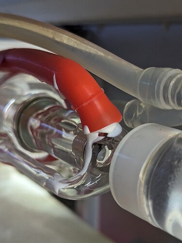

Update, i made it out to the city today a d found a aign place that had HV connector wires.
So I just replaced the whole HV cable going to the power supply with a brand new cable and it still has the same problem (just hissing and not firing, i haven’t let it arc).
Should i try to replace the red wire connected to the laser tube? That seems a bit trickier. Also was there always this white goo coming out of the laser tube connection point?
I disconnected and reconnected the ground wire too just for good measure, but no difference.
Is there any good way to double check the factory connections to the tube?
Cloudray still hasn’t gotten back to me, usually they have been quite responsive :confused:

It still sounds to me the lps is generating hv to cause the tube to lase, but it’s not occuring… That would indicate the tube has a problem…
Low chance of it being tube connections… I’d assume the anode (hv end, as in the photo) is ok…
If it goes through the insulation, it would definitely go across one of these poor connections…
I think you need to sit tight and wait for your vendor to advise you about a tube…
I know of no way to check these without the proper supplies and test equipment…
Check over the tube visually for any kind of deformation or crack that would allow the gas to escape.
After that, I’m not sure what to advise you… it’s unlikely that the hv from the lps is too low to allow lasing, so it almost has to be a failure with the tube.
Hopefully the vendor can assist… I think we’re at the end of the road here :crying_cat_face:

Cloud Ray just got back to me and they say that their technicians say this. Looks like there is a gas leak in the tube and they are sending me a new tube. So bummer, but overall resolved:)

it was definitely the tube that failed
cloudray sent me a new one for free
but then that one arrived shattered, hahahaha
and so they sent me another one for free
and then that one seems to work so far!
definitely was the tube failure, not any kind of secret leaking uninsulated wires
