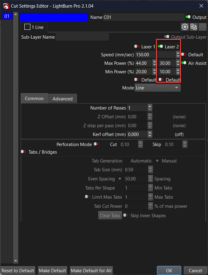

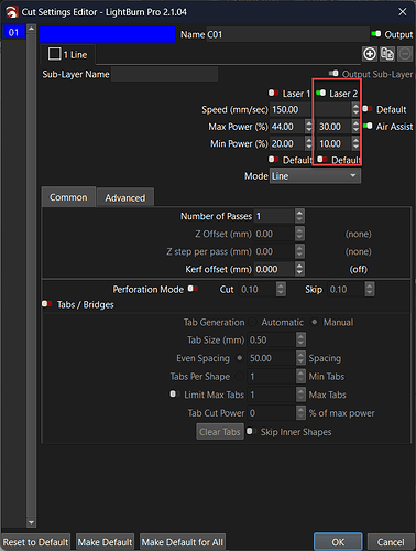

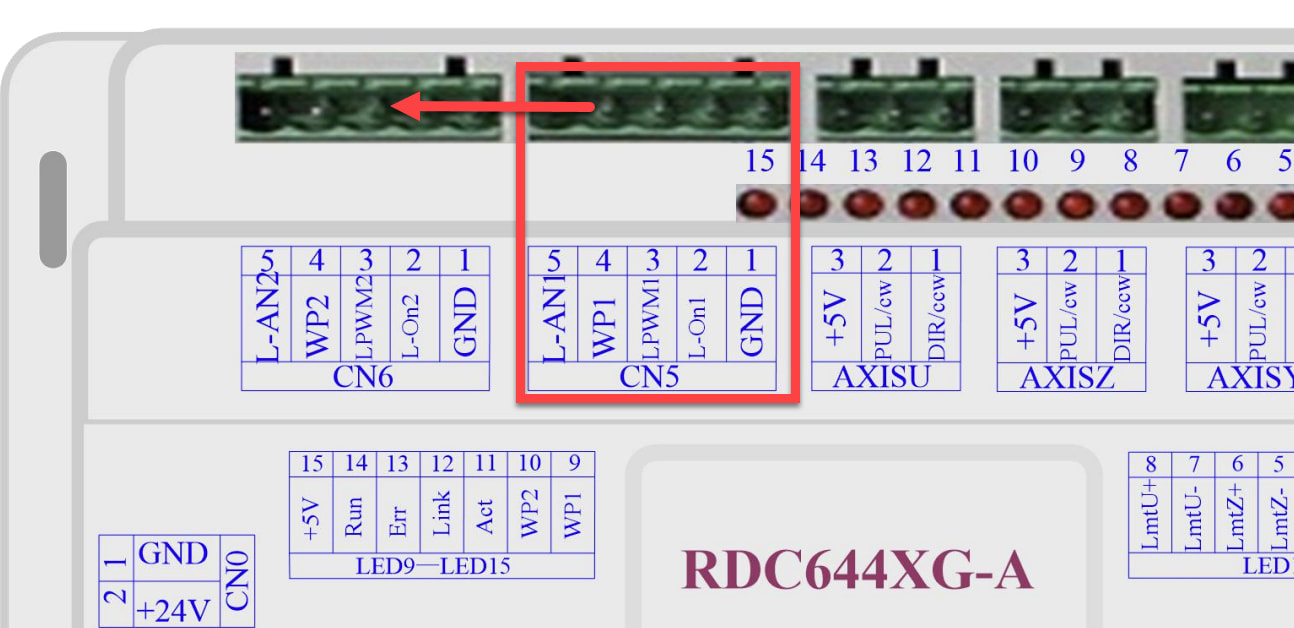

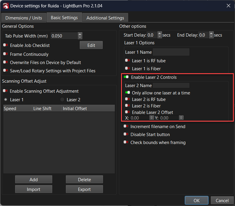

Before you do that, try using the “Laser 2” output in LightBurn, and move the wiring plug to the second (spare) signal output socket on the controller. The problem may be limited to the ‘CN5’ laser power signal interface.
At the controller, move this plug:
In LightBurn enable ‘Laser 2 Controls’, and use ‘Laser 2’ in Cut Settings:
I assumed the “Ruida 6640” in the profile was a Geweike-stripped custom version, but, yeah, if it has a spare output, go for it.
Case in point: LightBurn shows Laser 2 controls for the KT332N in my machine, but the hardware lacks the Laser 2 terminal block. :grin:
Yeah, that’s my case. No second socket to try.
