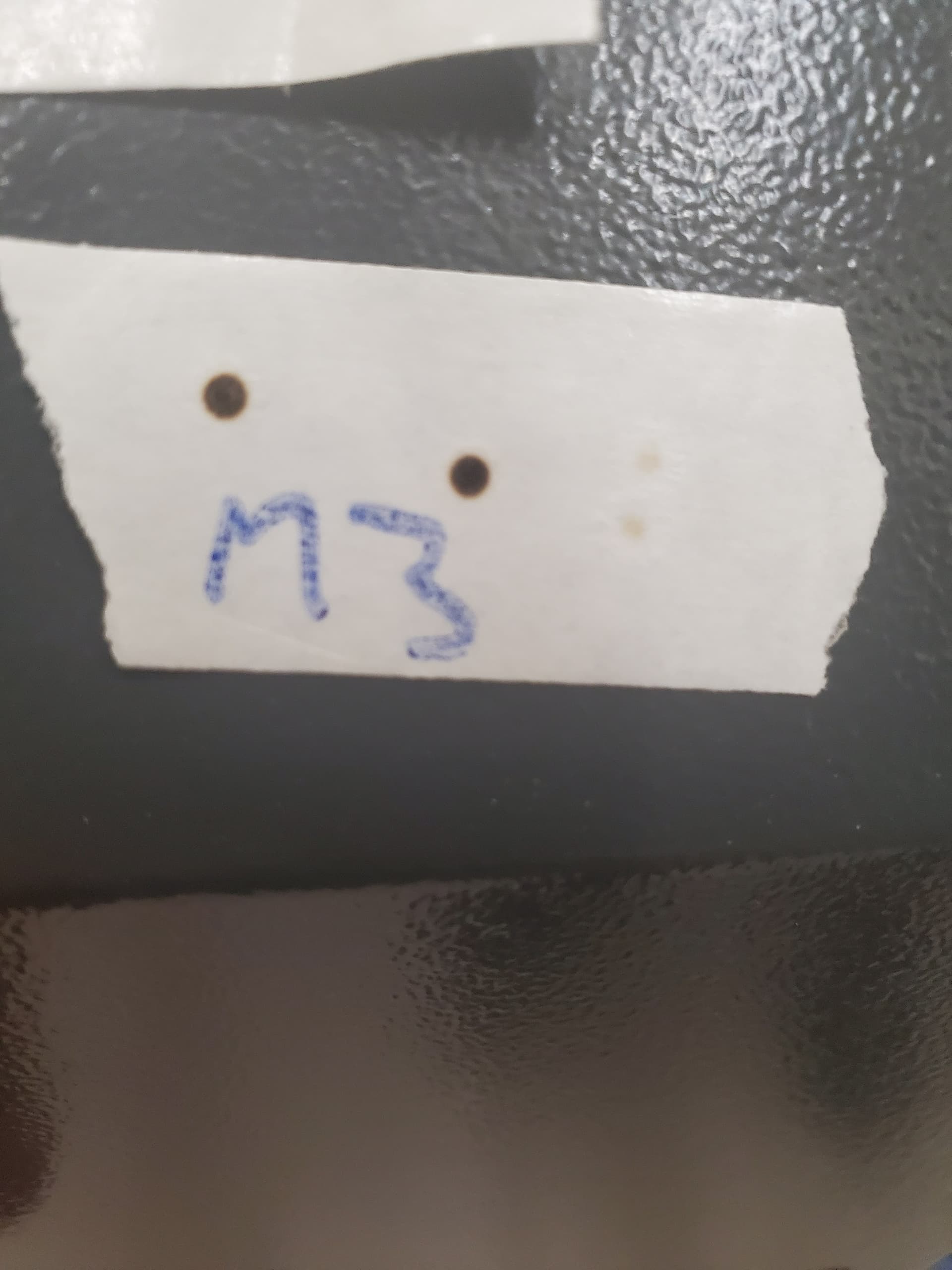

Hi! I recently bought a 60W omtech 2028 and have been having some issues. During initial testing, I started noticing that the cutting was significantly better in the top left corner compared to the rest of the bed.

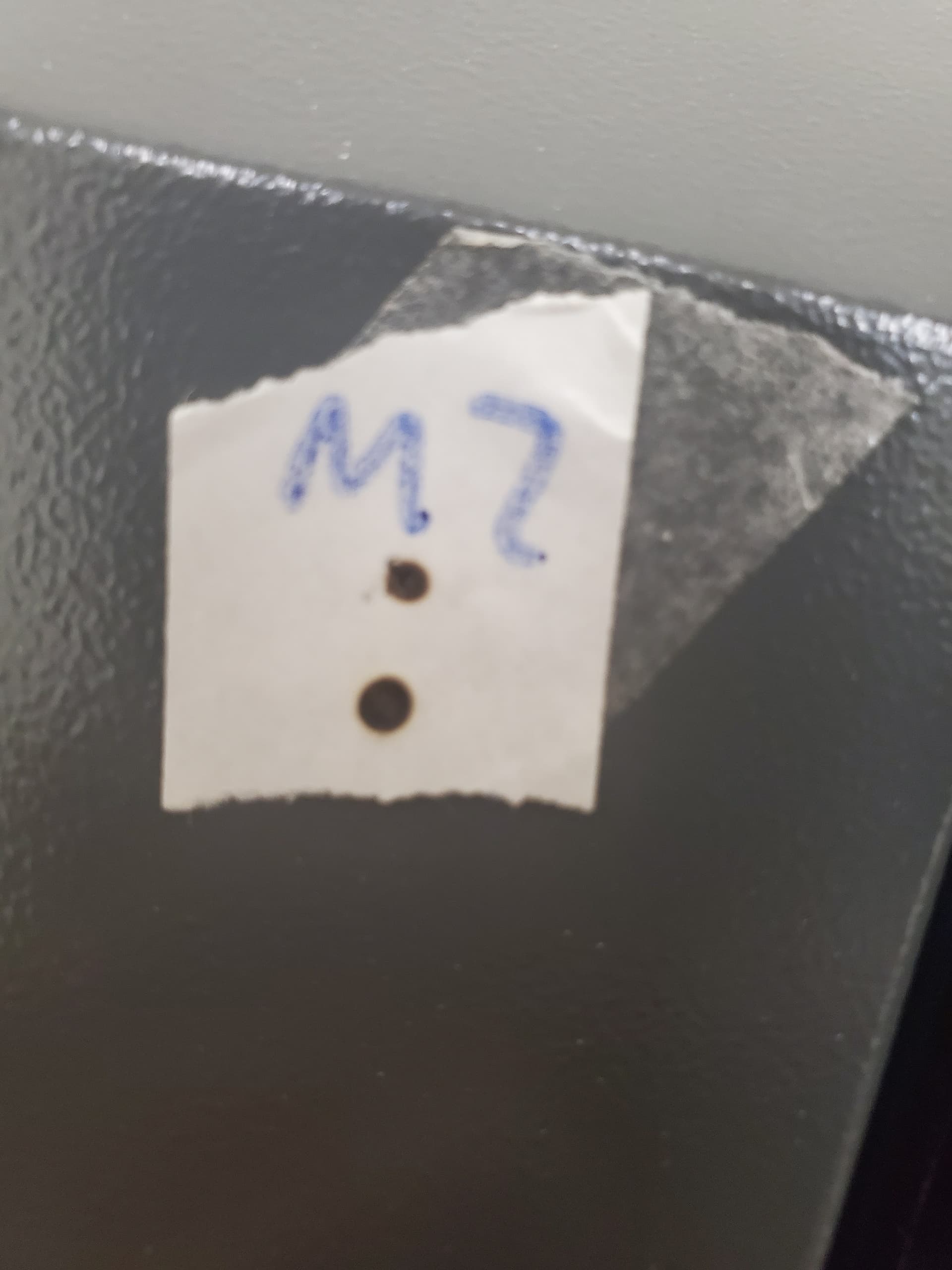

After troubleshooting mirror alignment and bed leveling, I noticed that when taping over mirror 3 and moving it across both the x and y-axis, the dot produced from the same pulse is much larger in the top left corner, when all the mirrors are closer together, and the dot barely shows up in the bottom right corner where all the mirrors are far apart. The effect is reproducible on the x and y axis, on both mirrors 3 and 2 (only the y-axis position affects it in the case of mirror 2, of course).
Has anyone had a similar issue or know what could be causing this? Thanks!

The power drop is quite significant from one corner to the other. When I tape over mirror 3 I am getting barely any marking on the tape at the bottom right corner, but full holes in the top left. In the pictures, the M3 you can see the two little light dots on the right are from the bottom right corner, the other two holes are from the top left corner. In the M2 photo the slightly larger hole is from the top left (4mm vs 3mm, but consistently different.

What you’re seeing is too severe to be attributed to normal power loss at those distances.
I’d suggest going through a full mirror alignment process to make sure you’re well tuned. Also clean the mirrors if you haven’t recently. You may be dealing with dirty mirrors.

After inspecting the mirrors more closely I found that they were cloudy. I was unable to clean them with alcohol, so I ordered a new set. I’ll update when they come in and I install them
If your mirrors are already a write-off then you may want to try something more aggressive. Do you have acetone to attempt a clean?
