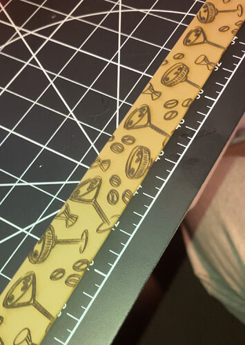

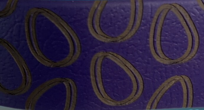

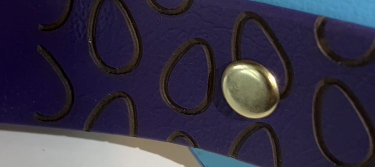

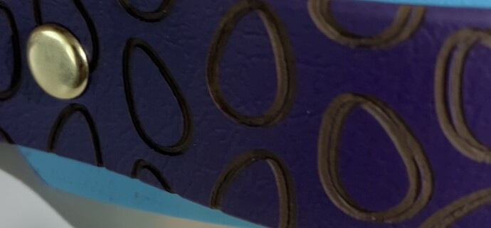

Has anyone encountered an issue where the engraving gets doubled on the X-axis but only in one 4-5 inch section. The rest is crystal clear. I have a creality falcon 10w laser. I’ve taken the whole rig apart and cleaned the rails, wheels, belts. Reassembled ensure it’s square and belts are tensioned. If you can see the picture it’s doubled on the left but clear on the right. This is one continuous engraving

I thought it felt a little sticky but very slight barely able to tell any difference from the rest of the travel. I did check all wheels to make sure they were secure and spin freely, no issues there. I made sure it was square when I reassembled after cleaning. The area that doubles is a little offset from centre towards the left, every other area engraves perfectly crisp and clear. You can see in the pictures on section is crisp and then it gradually gets worse and worse until it’s fully doubled. Then a few inches further it goes back to crisp clean engraving again.

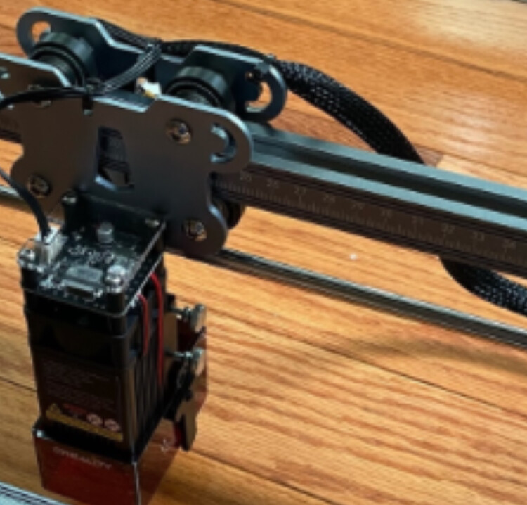

Looking that the Xtool D1 pro vs my unit, I don’t have the same guide rod as the D1. Mine is a solid aluminum rail with tapered inside edges for the wheels to rid in top and bottom. Here’s a picture from google. The rod you see beneath is the drive shaft for the y-axis. Because of this I don’t see how there could be any variation or bend/warp causing the issues as it’s a solid piece of extruded aluminum.

Looking at the design I immediately see an issue with how far cantilevered past the rail the entire mass of the head is. I imagine at high speed that thing swings back and forth like a pendulum. I see that they likely did it to provide additional vertical clearance to objects, but I feel they mechanically sacrificed…a lot.

If you grab the entire trolley/laser head module/skate, can you twist it along its axis? LIke back and forth like you’re adjusting a volume knob or something. If there is any play at all between your top and bottom guide wheels, I could easily see this generating wobble at specific speeds/geometry combinations.
In that picture the laser module is quite far down, mine sits much higher up than that providing more stability. I would also expect that if that was an issue I would see the effects regardless of what or where I was engraving rather than in one specific area. It’s also worth noting that it being one continuous engraving, the laser module is moving across the x-axis at a constant rate from before the problem area to well after it. There is no acceleration inside the problem area, only the diode firing.
There is zero play between the top and bottom wheels, attempting to move the laser module in any direction yields no movement.

I had the same problem. I also have creality falcon, but doubly as weak - 5 watt. The way I handled it is by adjusting tightness of wheels on top of laser moving assembly. Both of them, until it was not wobbling, but not tighter than that. (it was slightly tighter before that). Check it out and see if you can handle it by use of those two cam adjusters for the rollers.
