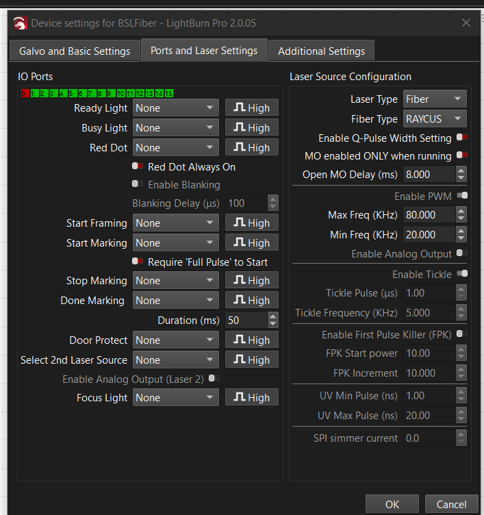

Trying to frame starts the laser even when “Cut selected graphics” is not selected. I’m sure there’s a setting somewhere I’m missing.

First time with this new software update. It seems the frame and fire dialog are now in the same place. When I try to frame the graphic to set up my piece. It actually burns the laser and does not frame anything. Here is what I’m doing now.
I don’t know if this helps

You mean, the framing preview is that strong that it already burns the material? It is normal that you will see a (red, usually) outline of the project, a galvo is much faster than a diode.
No, it’s just because you are now using a fundamentally different laser system. There is no “fire” for a galvo in that sense, only framing.
As said in the beginning, this does not start the laser, but the red dot pointer. Additionally, “cut selected graphics” has nothing to do with the laser firing or not. This is a completely different function. This just lets you select the objects you want to burn, if disabled, LB will send everything in the workspace.
