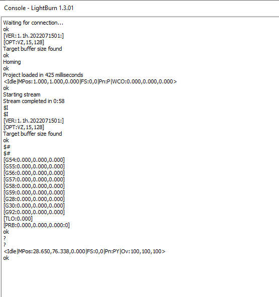

OK I am back I worked from 10pm to 1am and cut out 9 of the pieces I need in that time cutting 4 at a time. When I started my 3rd set the laser head started to jitter on the 4th image and would not move again so I powered the laser down. Exited lightburn rebooted my machine and cleared out temp files etc to be sure. Powered on the laser, started lightburn and it auto homed… Loaded up the same pattern and tried to FRAME it … it came across the front, up right side of the frame and once at the top started to jitter and would not move across again. I posted the images you asked for in the last chat … the output from the commands is attached
I checked the console and turned on SHOW ALL but it does not update the console while jittering. I don’t know what is causing this
Are you saying it’s moving to the top-right when trying to home? Does it first go bottom-left or does it immediately move top-right?
When you say the motor is jittering, do you mean to say that it’s crashing against the frame and making a buzzing noise? Or is it not crashed and jittering back and forth?
Can you isolate the jittering to a single motor? Of so, which one?
One thing that’s interesting is that you’re showing ā€œPn:PYā€ in the status report. That indicates that the Y limit switch is being activated. Try running various permutations of triggering the limit switches and running the status report ? command. It should show an X for x switch and a Y for y switch activation. Check to see if it’s properly showing on and off.
I’m tending to think this may be a mechanical or electrical issue given that it started mid-job and you’ve not made any configuration changes. But maybe we can isolate where the issue coming from.
it was 1:30am and I have to work today so I had to go to bed that is AWESOME! Thank You so much! Let me try again - the job was running like the 2 before it had run and it got to the far right end of the job at the top of it and the jittering began. When I say Jittering it is like the motor going left to right stops turning and starts instead to just shake. When you put your finger on the motor spindle you can tell it is not turning but rather if feels stuck on one step and goes left and right quickly on that same step. So I stopped the job and tried to home the laser which it appeared to do but when I try to frame the job the laser head moves Left to Right across the front of the job, then up towards top on the right side of the job. When it gets to the top right corner it starts to Jitter again and stays there. I shut it off turn it back on and when I try to HOME it now it goes all over the place and will eventually stop either at Right Front of the machine or it will jitter its way to center front. But it is as though the motor never gets a signal to turn but instead is getting 2 signals (1left and 1right) at same time. I woke up this morning wondering if the cold could be impacting it. It was very mild when I went into the garage at 10pm but when I came out it was -6 Celsius … I am going to mount a thermometer in the garage so I can see the temp inside. In all of this the front to back movement remains very smooth and works but left and right jitters.

Try swapping X and Y cables. Does the jitter move to front/back movements? If so, that places issues with controller or cable. If not, the issue is in the stepper motor.
To isolate if issue with controller or cable, take known working cable and motor and connect to suspect controller. What is the behavior? If issue is corrected then cable is bad. If issue persists the controller is bad.

I spoke to the Vendor today and they, after watching the videos and reading the descriptions have agreed to replace the Main Board. I will update this after I do the replacement and let everyone know how it is going.
