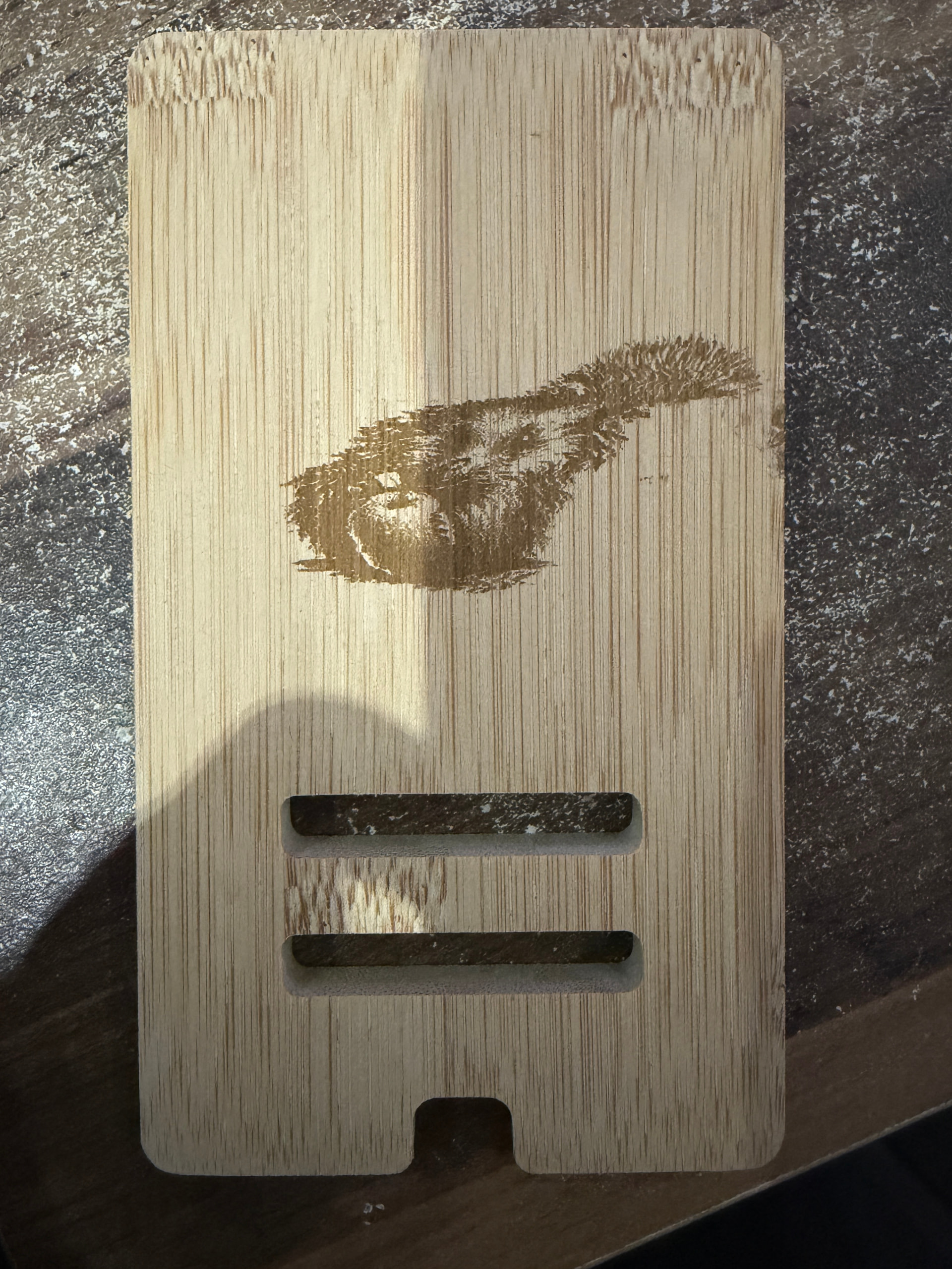

I cannot get any projects to work as they all seem to slip to the right after a couple of passes. Tried on wood and slate. I have cleaned the laser, checked the belt in case it was loose but unsure what to do next
You need to post a photo of your results. We can guess, but it’s much better to have the actual failure to examine.

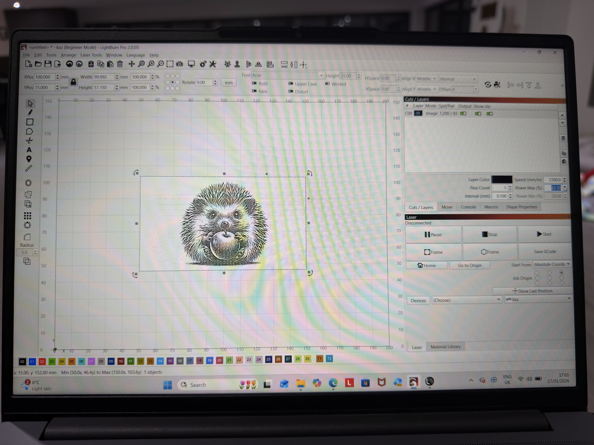

Post screenshots of your layers/cuts settings and a screenshot of your project and preview screens
speed i was using is 7200, 82.5%
i have cleaned the machine, checked the belts. it has just started to do this last night. all my other projects on slate and wood have been ok

Look closely at the laser head and check for anything that puts drag on it. From what I can see it’s an x axes issue, so it’s likely the head/bearing or if you have wheels, they may have change the pressure they apply.

Look into adding some overscan. Having a few extra % overhead for deceleration may help with the drift issue, too
I would say you have a loose hex screw on the drive pulley on your X axis. The one mounted to the laser module.
