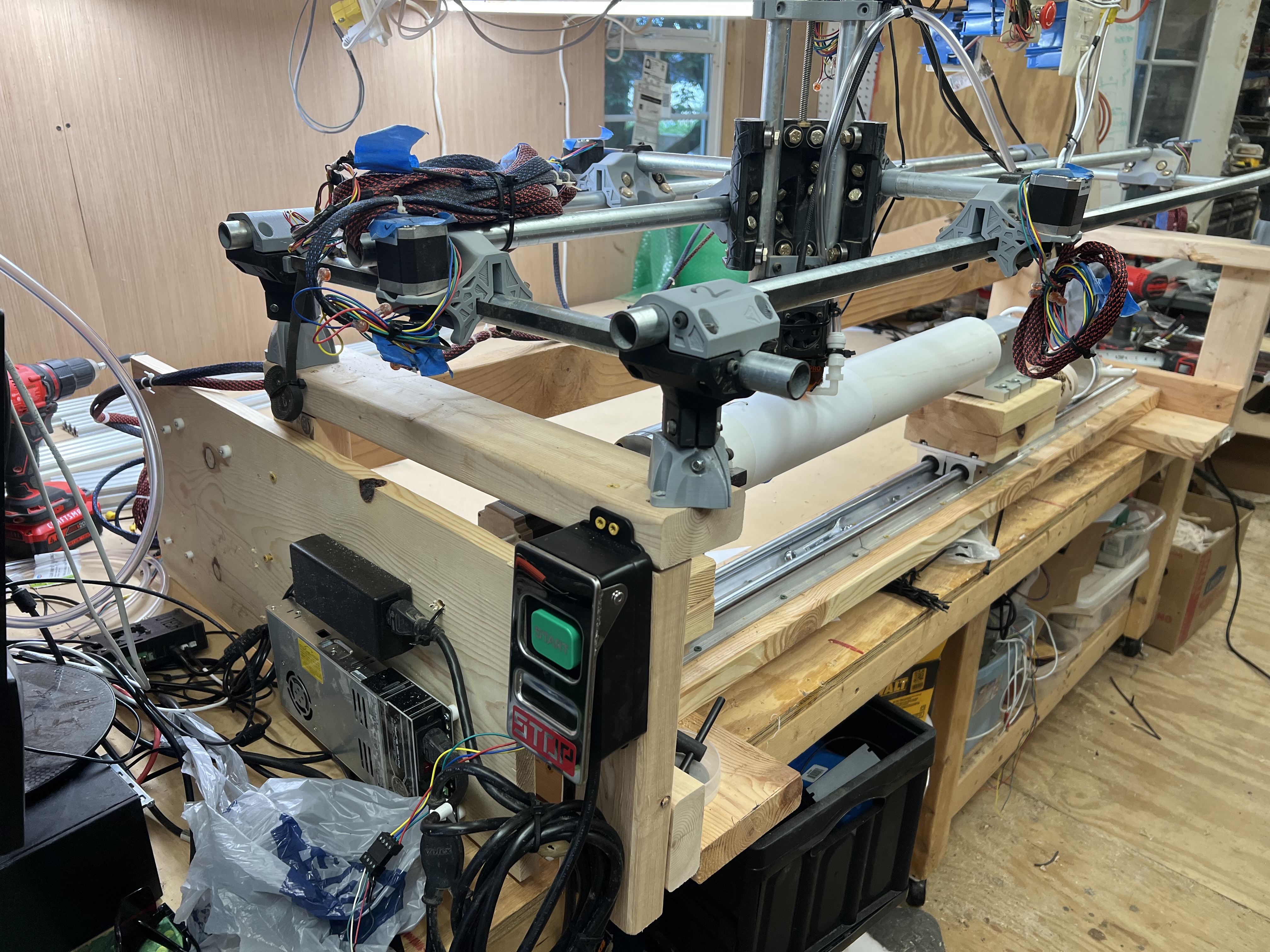

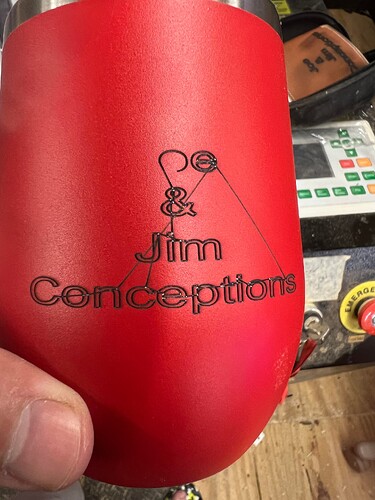

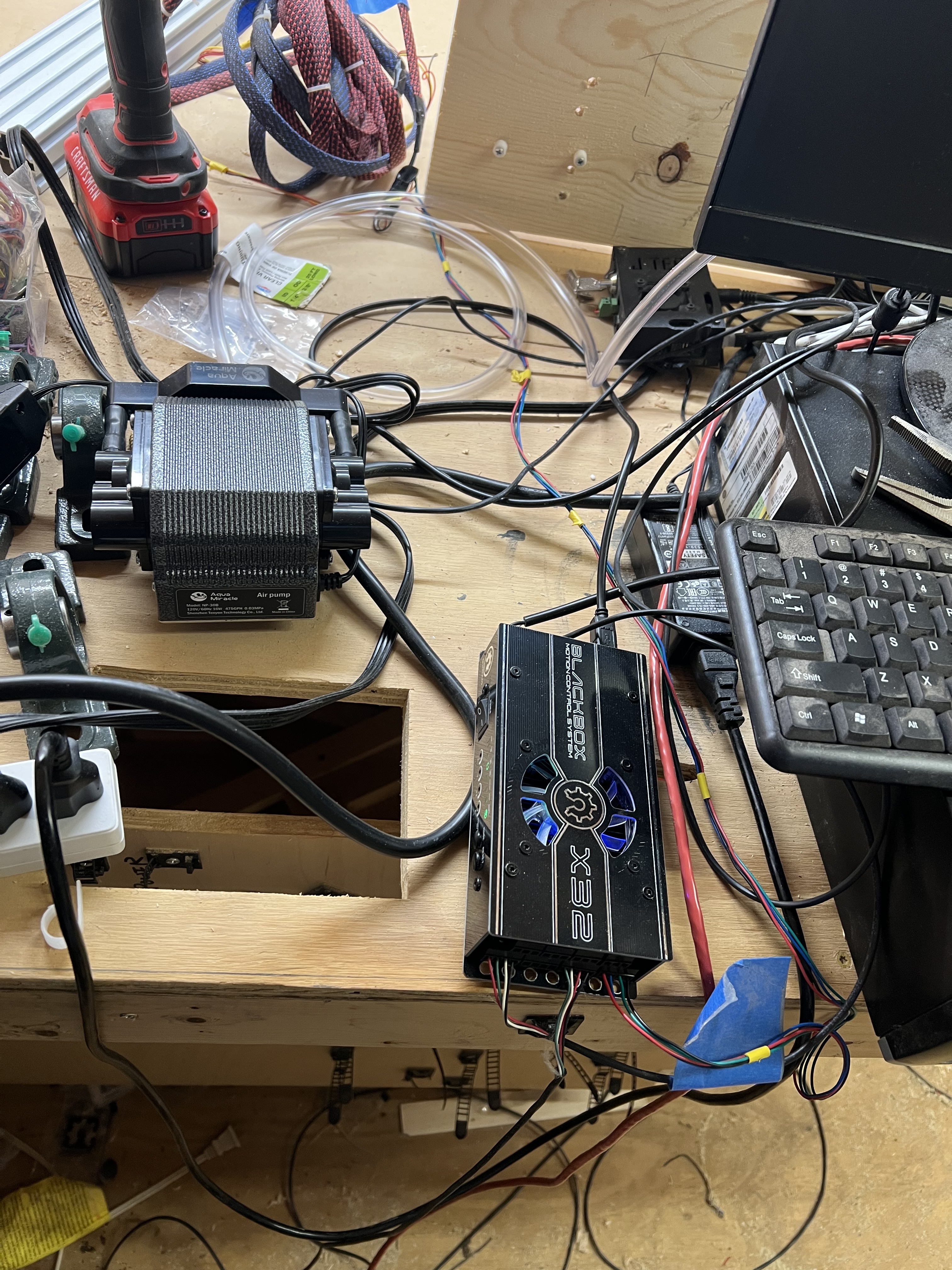

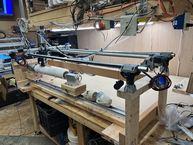

I made a Rotary laser using bits of a leftover MPCN project and a rotary attachment with a J tech Photonic Diode laser. I could not get it to run on the standard Rambo board that the MPCNC uses so I switched it out for a X32 Blackbox from open builds. Lightburn software will not run the machine so I use light burn to write the Gcode and then use Open Build Controller to run the G Code. The laser is not turning off when it does movements. I’m trying to figure out how to modify the G Code to make the laser turn off when it is doing a movement.
I think I seen that kind of lines being solved in a thread a couple of weeks ago…
Not exactly as you described but could be the solution for you too. ![]()
Try $32=1 in the Console window.
As @MikeyH advised setting $32=1, puts the software in laser mode.
Generally what happens is that the spindle isn’t stopped when the machine makes a move. A laser needs to be stopped before a move…
Your software has to support this mode or there must be some other way to configure it turn the pwm off when moving…
Good luck
Thanks for the advice. That did the trick
