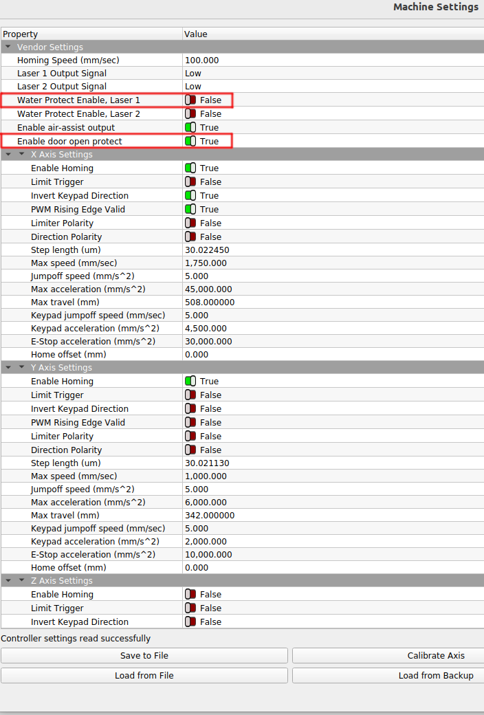

I am using Lightburn 1.7.08 on an OMTech Polar, only recently every job I send to the laser, pauses at least 5-10 time and have to press the red ring button to resume, very annoying, OMTech say it’s lightburn issue, is this correct please.

That red ring is a HALT indicator, and not an E-Stop, if you can tap the button to continue. That it is likely not something like a flame detector. If you raise the lid, will it go into a Halt mode? I would look for something like a flakey or maladjusted operations switch.

The early Polar models had no console, so the Ruida routed any failure to the red ring.
Without a console you can’t directly know what caused the failure.
Of course, the best suggestion is to put a console on it… lol
It’s likely either a delay in the way your coolant is checked or some other interlock that’s causing an issue.
The only real way to determine this, without a console, is to disable the fault ports in the Ruida. There are only two, door protect and coolant flow.
My Ruida failed to read the input of water protect for laser 1 after a couple of years.
The door is always open on mine, and door protect was disabled. I simply moved the water protect to the door protect input. I’m smart enough to know when it says Door Protect error on the Ruida console, that it’s my chiller… :face_with_spiral_eyes:
You can use this to help determine which input, if any, is causing this…
From what I’ve seen of Polar posts, the door protect fails quite often… not having one, I wouldn’t know for sure. But, I’d start there, cheap gamble…

Omtech made a suggestion that I should check the coolant to ensure it was at least 2/3 full, and that my friends was the solution, due to the coolant being low ish, the laser kept pausing, now it runs like a dream again.
If you had a console, it would have told you this 3 days ago…
Great you figured it out. Wonder where your coolant went?
