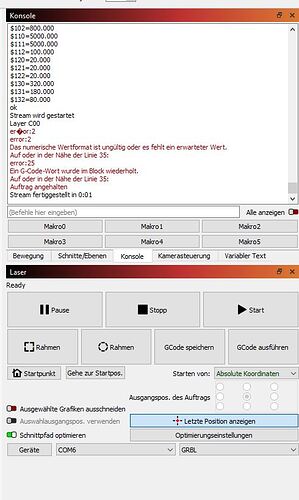

Hello, I’m new in laser-burning and I have a problem with my new laser. I bought it at ebay, its a 3018 pro. The Grbl controller is with the firmware 1.1f. When I start the laser with 100% at constant mode, it works, but burns all down. When I set 50% or something else, it stops with an error. It doesn’t matter what I burn, is it a letter or somithing else. I’m now try to solve the problem since one week and don’t find the right answer. Perhaps someone can help me?

The message is:
error:24
Im Block wurden zwei G-Code-Befehle erkannt, bei denen die Verwendung der XYZ-Achsenwörter erforderlich ist.
Auf oder in der Nähe der Linie 32:
Auftrag angehalten

I already changed the cable, but it’s always the same. It starts and stops. I think I should do a firmware upgrade to prove if it that can help. I will try tomorrow. Thank you.
Hello, I just made the firmware upgrade to 1.1h and could do some work without errors. But they came sometimes, when I did not restart lightburn but just import a new picture, then it could be there an error. It seems like it is a buffer isue. Is it possibil to clear the buffer trough the console? The board is an ATmega328p. Is this board generally good or s****?

Can you run $$
command in Console and return output here? Can at least confirm settings.
