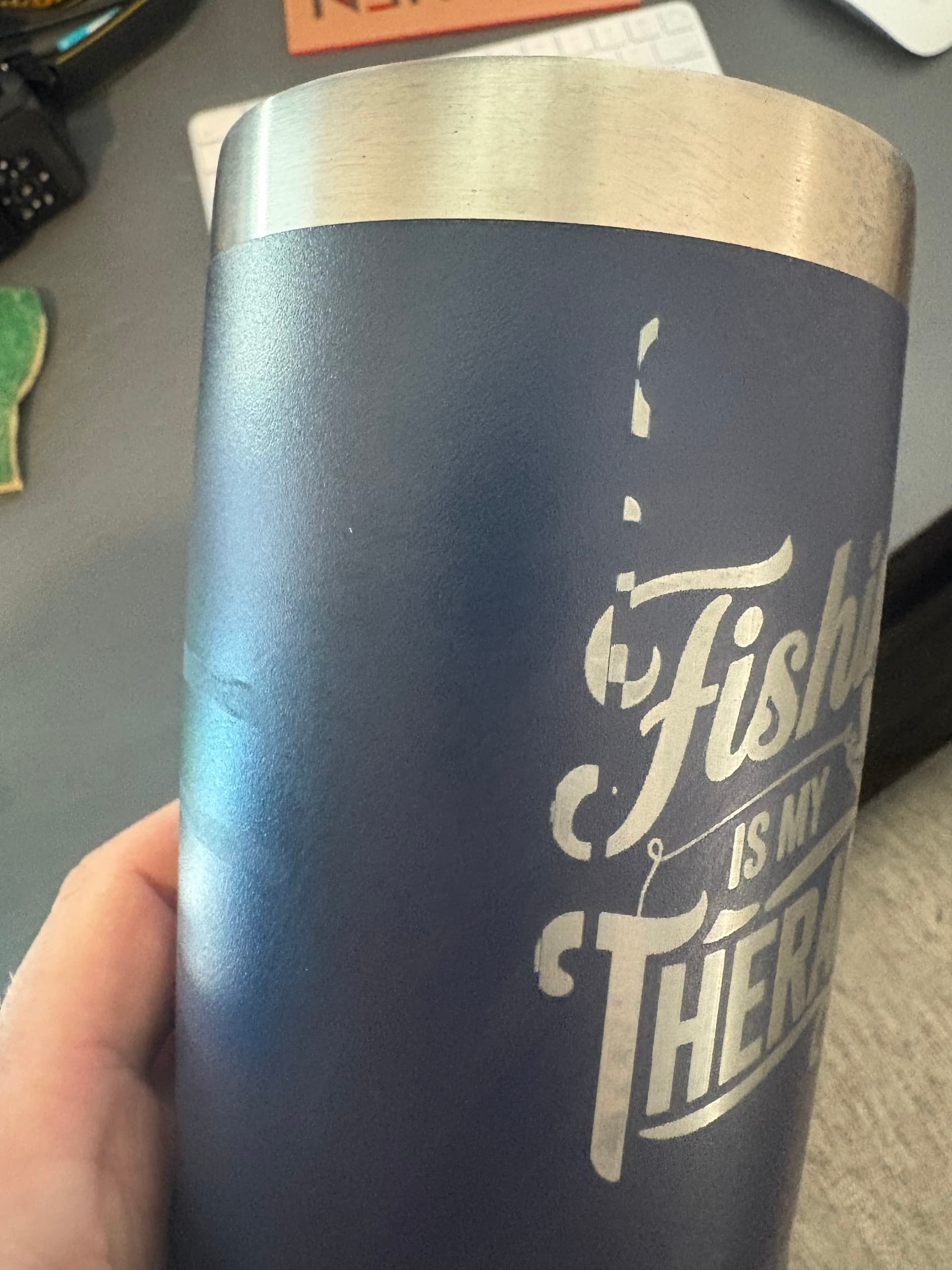

Here are examples of the issue I am facing. The machine will randomly shift the location of the engraving. As you can see on the navy tumbler, the whole engraving shifted up in one spot, and went back to normal after.

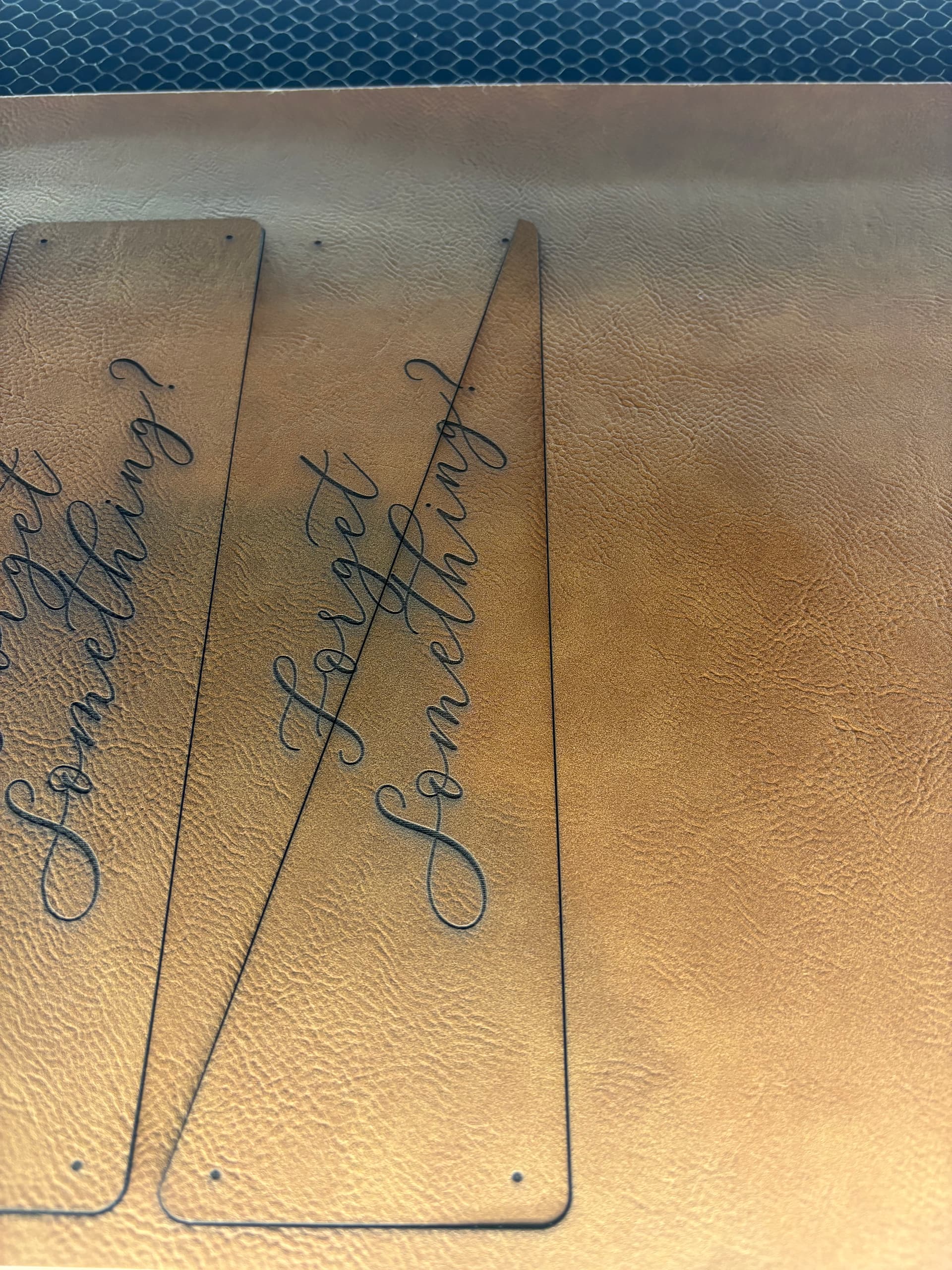

The other examples are when it is cutting, it will randomly cut wrong. No there is no hidden lines I am not aware of. The machine just does it. I moved to a new house, so I know something is off after moving the machine(as carefully as I did it), but I have no idea where to start.
I can engrave the same design in the same spot 15 time, and on the 16th time it may do something wacky. Its random when and where it happens. I am not sure if it is a belt issue, or leveling issue, or something even bigger.

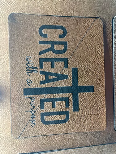

This is from USB cable. You can see the crab is not a normal cut and gets crazy without completing the crab.

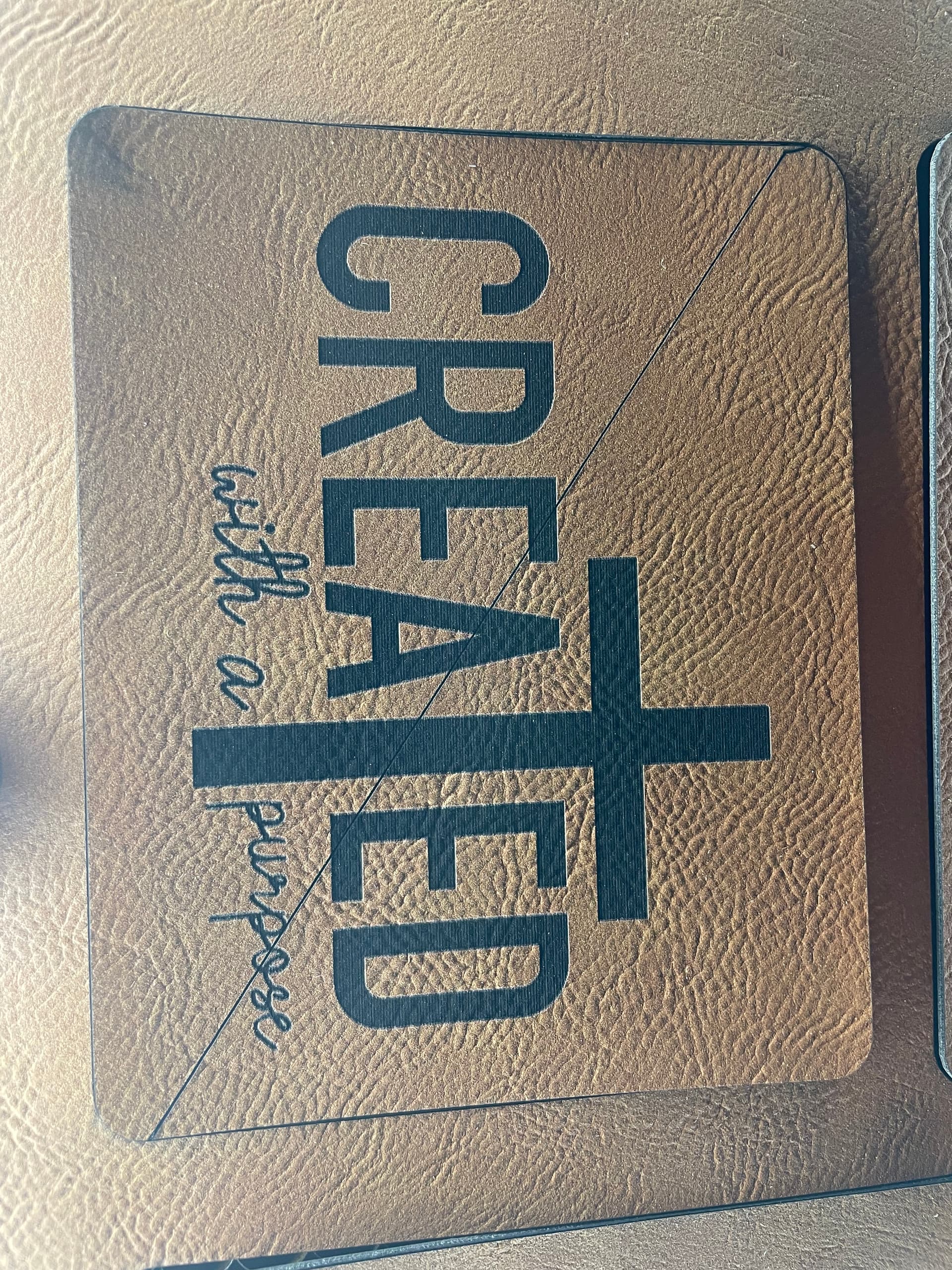

This is from USB Thumb Drive and both cuts look normal like they should.

Which tells you the data was corrupted between the Mac and the laser controller.
Apparently Apple products are much fussier than PCs with regard to USB connections, particularly when a USB 3 port meets a USB 2 (-oid) device. The usual solution seems to be interposing the cheapest possible USB 2 hub between the two.

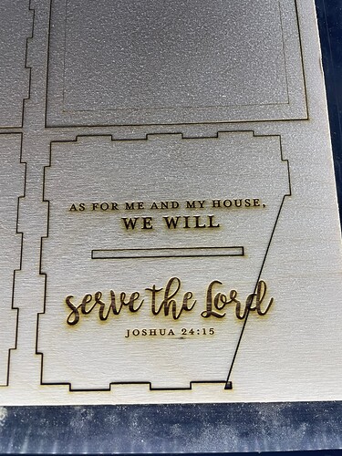

Concerning the pic above with the engraving “Serve the Lord”, How did the control board make the cut from the disruption in comms point ‘A’ to the rejoining of normal pattern, point ‘B’ in an almost point to point straight line.
Is there a plan loaded and followed by a procedure.
The Ruida commands can use absolute coordinates (which are distinct from LightBurn’s Start From: Absolute Coordinates mode) to position the laser head. When some commands are corrupted in transit, the next valid command with absolute coordinates will yoink the laser head to that spot, leaving a straight line from the trashed section, and continue as if nothing bad happened.
We see that a lot with GRBL-based controllers when part of the G-Code file gets trashed by a flaky USB connection.
Neither the Ruida nor the GRBL controller have much in the way of error checking, so other weird things can happen. Mostly, though, the errors just punch out sections of the shapes and leave an otherwise mysterious straight line.
So there’s no ‘if then - go to - else’ so no feedback, and its not smart enough to recognise garble and simply jog from point A to B.
