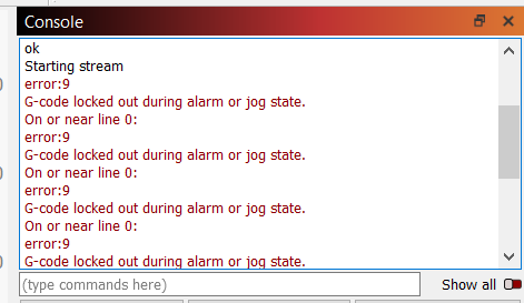

when I put an image or whatever onto the canvas and try to FRAME it it does nothing. When i press HOME is when it does the horrible loud noise and appears to struggle to move. It moves but very very slowly. it gives this error message:

But because i am glutton for punishment I pressed YES. When I press start to run the program it does nothing and I get this message
When I press HOME it gives that horrible noise and acts as if it is struggling to move and makes it’s way to the bottom left and still throws that error code 9 etc.
I added the other GRBL device and it does the same thing.
