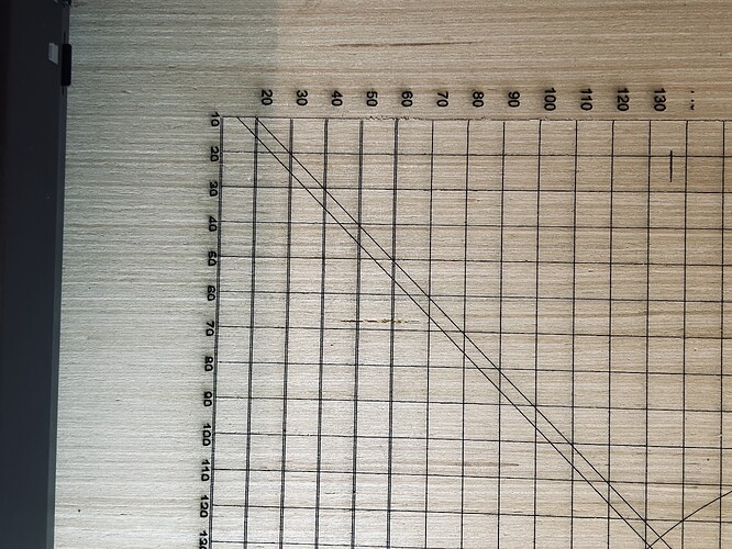

Couple of questions. 1. Why does my laser grind or belt slipping when it hits either the top or bottom limit bolts? Does the machine need calibrating and if so how is that accomplished in a hopefully easier way to understand? 2. Why are my diagonal lines not meeting in the corner? Thank you in advance
It should not hit the bolts. Could be a calibration error, could be operator error. When does it hit? What is your start from set at? A screenshot of your entire Lightburn screen showing your project that is giving the issue with the Cuts/Layers panel and Laser panel open would be helpful.
Under this category is improperly configuring the software for your machine or trying to burn parts larger than your laserâs physical workspace area.
Not meaning to correct @thelmuth, it should not hit anything. If it does, you lose accurate position information. That is why your lines are in the âwrongâ place.
I apologize for the delayed response. The dimensions of the wastebord grid is 380mm x 380mm. I didnât make it 400mm x 400mm so I would have room for the numbers but even with the numbers it is still below 400mm.
Because theyâre not in the corner in Lightburn. The \ line is corner to corner this / one is not and thatâs how it burned. Looking at the burn though you have some slop in your machine. See the squigles on the end. That doesnât account for going out of bounds though.

And I didnât even notice the line being off on my screen, feeling pretty ignorant right now. I appreciate you pointing it out.
