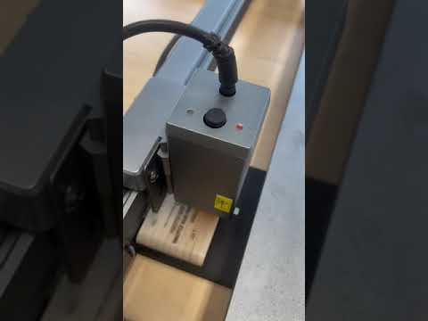

I did not use my Laser Master 3 for about 3 months, so I ran the LightBurn update, but now the laser is doing… nothing. I am unsure if it’s because of a hardware problem, or because of the update. It seems all is working and responding fine, but there’s just no laser beam:
Any thoughts would be greatly appreciated
Thank you!
(some laser engravings are visible, but they’re from previous tests)

Notice your Gree light is off now, so this means no PWM signal
Check your cables, unplug and replug to check any bent pin
Specially check the Motherboard plug if it start to pull the white female port back out of the frame.

Hi Gil, thanks for your input. No green light, correct. I checked all the connectors, all seems fine and no bent pins.
PROBLEM FOUND: I just noticed the cable to the laser head wasn’t directed fully upward. Something must’ve hit it during storage and slightly bent it. I set the laser to work, played with the cable, and the green light came back on…
Big thanks to everybody trying to help. I’m going to figure out if I need a new cable or whether I can fix it with some tape (to keep it in the upright position).
