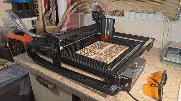

After a few cuts my brand new laser (Atomstack A10 pro V2 Black) suddenly did not ray (burning / firing), at the same time It is moving properly, fan works, two leds at laser module works (pwm is blue, power is orange).
Such bad behavior exists both: under WIFI via Atom Stack Mobile app and USB control via LightBurn.

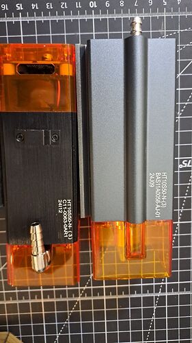

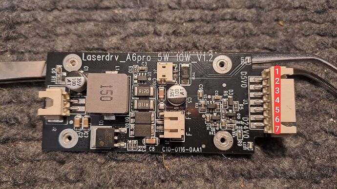

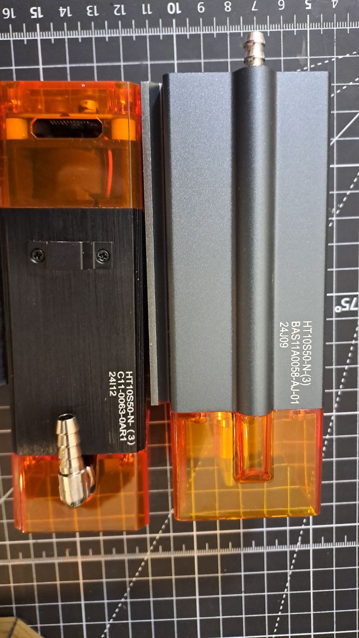

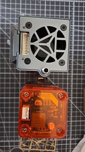

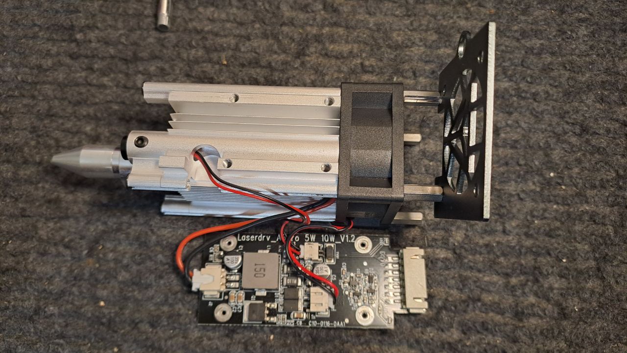

This is a Hero of this sad story:
Atomstack Laser Module Model No: M50 v2
10W, 455 nm, frequency =1KHz

That will not increase the PWM voltage. From the numbers you posted, if the laser is not lighting up, that suggests the module is bad or the connector is not secured.
Got warranty?
Thanks a lot for your time and advises!
I asked the new module from AtomStack team within warranty, waiting for an answer.
