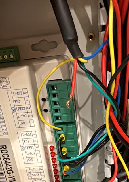

I don’t see a yellow wire in any of your photos?

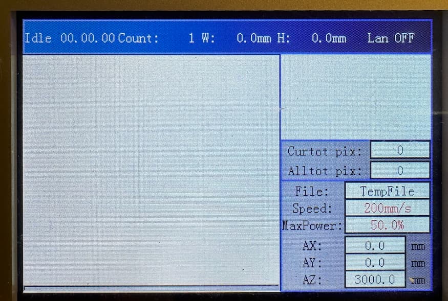

What are your X and Y axes values after a boot?
If it does or doesn’t boot correctly, it might help us with solving other issues.
There is a yellow wire in the bundle of wires coming from the LPS.
How do I check this? Is it visible on the control panel on the laser?
Check your machines console and tell us what the X and Y values are.
All zeros before and after running a cut cycle (without laser firing),
Does it boot up with these values? If it fails the boot routine, the X and Y axes are set to 10,000 or something large.

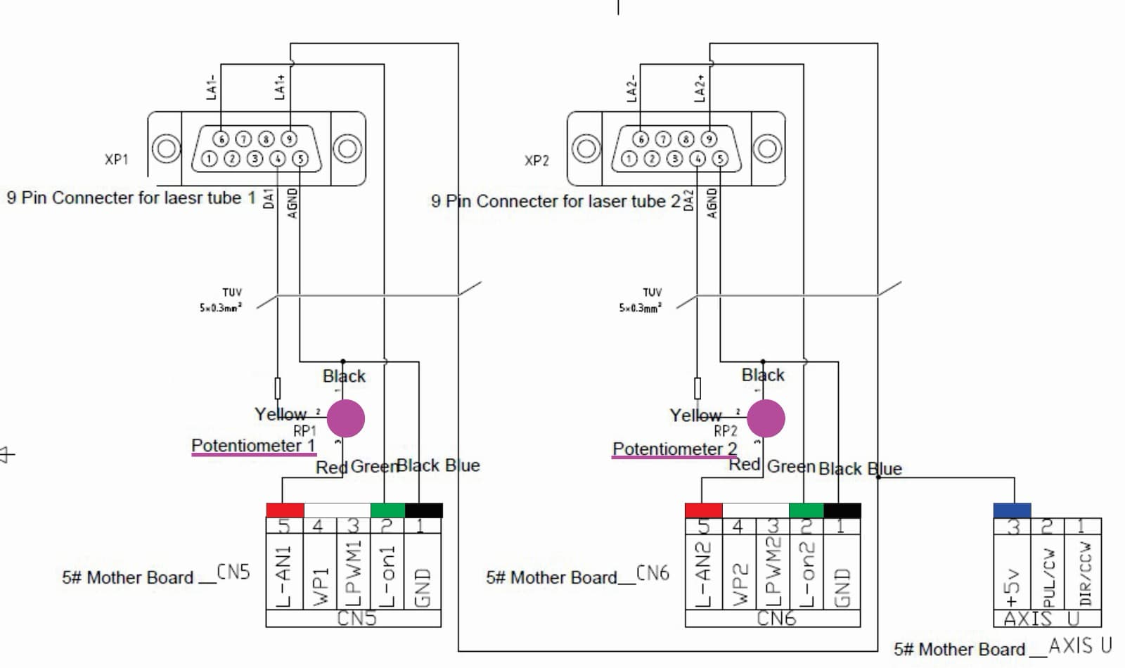

What we can’t see or help you with is the db9 type connector that goes to your lps. In my photo of the lps, each of the control pins are exposed and labeled.
Did you ask the vendor about this or about getting any information?
The control panel boots to zeros.
Thanks for your help! I reached out to Camfive about a wiring diagram for the LPS.
A basic schematic of the unit would be best. Showing the connections from the controller to the lps.
Does this help? I only have one laser tube.
The potentiometer is just a voltage divider for the analog current control signal. Ensure this is turned to it’s maximum. This will limit the range of current produced.
You can check that pin 9 of the db9 is pulled to 5V by the Ruida. This appears to be a positive signal for the lps to lase. It’s using pin 6 as laser enable.
If L-On1 goes low and there is a voltage on L-An1, then it should lase. Ensure the machine isn’t creating any error messages when checking this. The gantry should stop working on an error.
You should be able to check the yellow wire to see if the pot’s working.
Make sense?

Check the yellow wire how? This wasn’t initially hooked up to the Rudia, but Camfive said that if I wanted to take the Pot out of the loop to try and hook it up to L-ON1, just to make sure the Pot wasn’t the problem.

@jkwilborn It looks like the L-on1 at pin 6 is being used to sink the U +5V at pin 9? - I wonder why they didn’t just connect pin 6 to GND and then connect L-on1 directly to pin 9 as an active high instead of involving U +5V?
I would read it as LA+ as an active high input and LA- as an active low input. It appears both need to be active. Since the Ruida works with pulling things low, I think it’s the correct option…
If they wanted to use LA+, the I think they’d have wired LA- to ground.
I could change mine to be a positive signal to enable the laser using the H terminal of the lps… However, I don’t think they recommend wiring H to 5V and using L for the enable. I don’t think they mean both need to be active as I know H on mine is open.

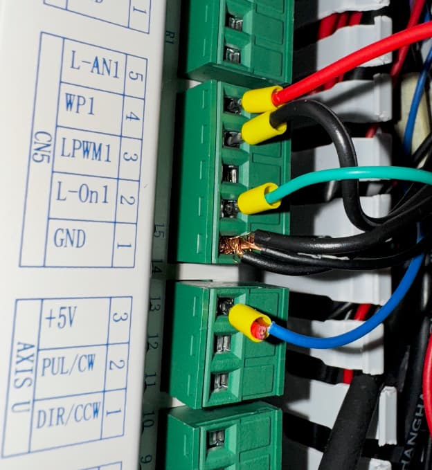

So, given the above information, is this wiring correct? What should I do? Im a bit of a noob so its helpful to talk colors.
Do I still need to check voltage somewhere? Check thge 5V DC current, bo going red to #3 and black to where? THANKS!
You can check the AXIS U:+5V against CN5:GND, same for L-On1, which should also be 5V when the machine is idle and close to 0V when active.
L-ON reads at 4.6V
#3 reads at 5V
That’s good, and does L-on drop to around 0V when a job starts that would normally fire the laser ?
And when that same test job is running and if it has the power value set to about 50%, do you get a voltage reading of around 2-2.5V between L-AN1 and GND (which should go all the way to 9pin connector(5)).
Check also that the 2-2.5V voltage from L-AN1 is going all the way to 9pin connector(4) - maybe test at the yellow wire after the potentiometer).
L-ON Drops to Zero on run
#3 5V DOES NOT DROP TO ZERO on run.
