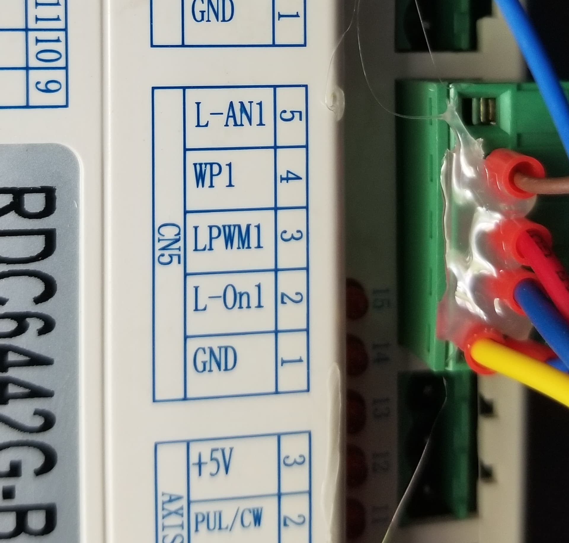

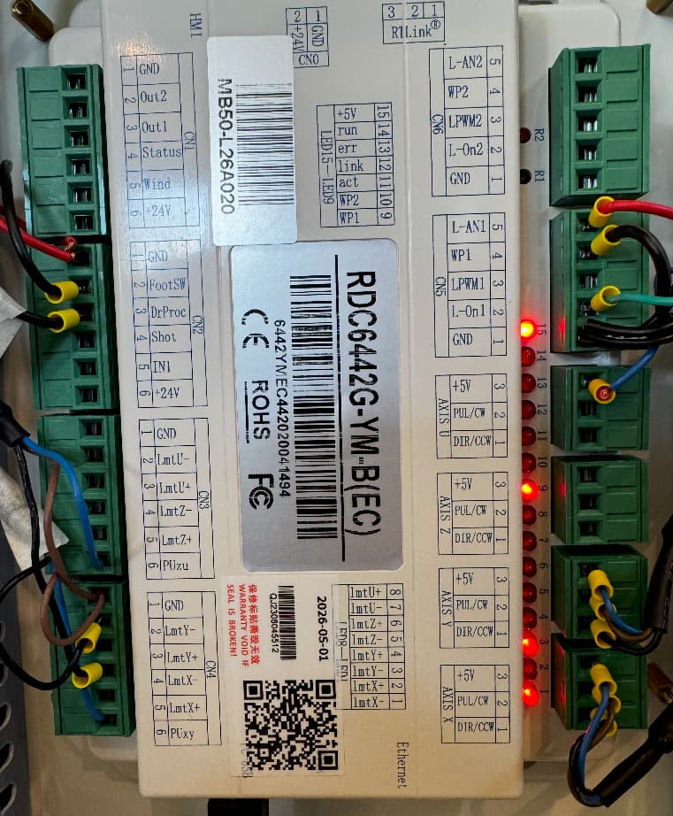

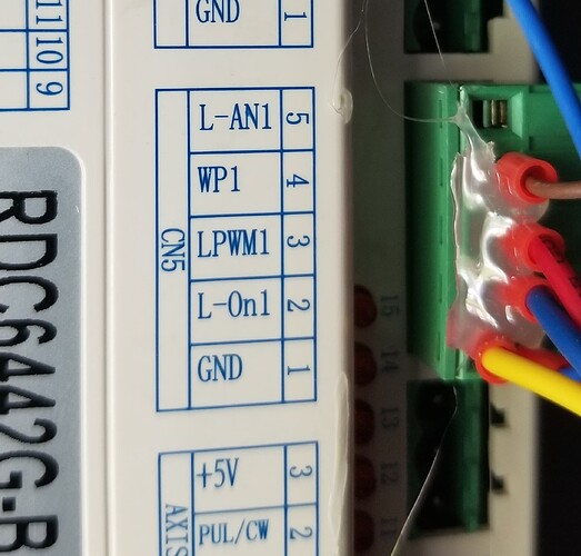

How did you wire the CN5 connection to your lps?
Use either L-AN1 or L-PWM1, but not both. I use L-PWM1 as it seems easier to deal with… doesn’t matter in the end.
Ruida LPS Description
L-AN1 IN* Analog tube current control
WP1 N/A Input for water protect
LPWM1 IN* Digital tube current control
L-On1 L Laser enable
* Use only one type of input, analog or digital.
Make sense?
Yes, I testedr by pressing the red button on the power supply and got ignition!
This is how Im not sure what each wire is but the tech guys at Camfive said it is correct…
Should I try switching to the LPWM1 output?
NO… It should work either way and you don’t want to monkey with something that should not be the issue. There’s some other obstacle in the way preventing it from lasing.
Can you check your lps to check how P on the LPS is wired up? A photo would be good… :folded_hands:

P on the LPS? Want a pic of the motherboard?
P is power, on the Laser Power Supply, I got it.

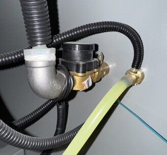

My chiller has a signal it sends to the Ruida. If this signal becomes inactive due to a flow or refrigeration issue the Ruida will halt the machine.
On some low cost machines the water protect is wired to P (water protect) on the LPS, you don’t want this with a Ruida. If the low cost machine coolant fails, the controller doesn’t know it and looses it’s position.
A Ruida will halt everything and remember where it was when the failure occurred allowing you to re-start the job where it left off.
I was wanting a photo that shows the connections to the lps..
Do you have a voltmeter (multimeter)?
My chiller is only plugged into an outlet on the laser, there is no comm wires, there may be a flow sensor on the tube or something like that but there is no comm line between the chiller and the laser.
I do have a miltimeter.
I think I did find an in-line flow sensor for the chiller.

Can you check these? It’s unlikely the Ruida has failed, much more likely it’s an lps.

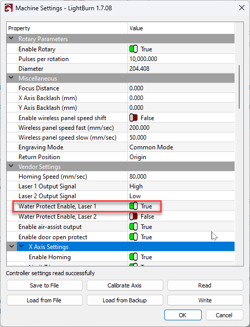

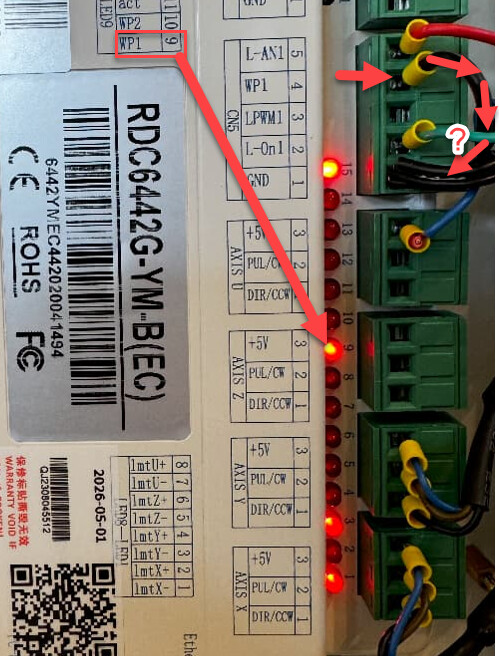

Is the indicator light at 9 still lit? (It should be if water protection is enabled)
It looks like you might have a have a short wire between WP1 and GND? I could be wrong it’s a little difficult to tell from the photo…?
…if that is not connected, that could be your problem - check the wiring at GND.
Note: It’s unusual to have this link here at all since it’s equivalent to disabling water protection in the Ruida Vendor (Machine) settings:
There isnt a short jumper wire there, but the water sensor is wired to GND and WP1.
#9 is lit.

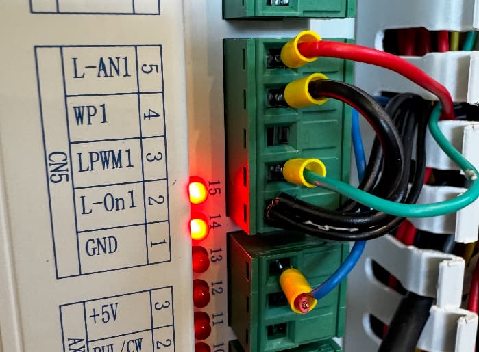

I heard from Cam5 that the red wire from the LPS is NOT connected to the Rudia, instead the red wire at L-AN1 goes to the potentiometer on the front or the laser. The red wire from the LPS, is completely disconnected…
Thanks so much for your help…
OK good, if #9 is lit then presumably you are no longer getting water errors at the control panel.
L-AN1 is an output, so if the red wire from there is is going to a potentiometer then it would have to also be going to the LPS (otherwise it would not be doing anything).
If there is a potentiometer in-line with the LPS, then you would have to make sure it was was not dialed right down when testing because you need to allow the voltage signal from L-AN1 to make it through to the LPS.
Is there a model name or description somewhere at the LPS? Do you have a wiring diagram for it?
The other consideration is that the L-On1 sometimes needs to be configured to be an “active high” output, (Machine Settings : Laser 1 output signal : High/Low). If you can get a wiring diagram that would help.

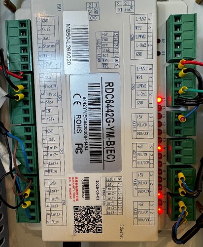

Does this boot? Likely not related to it lasing, but may give us a few more tips on where to look.
What does your machines console say for X, Y coordinates?
After mine boots, both X and Y home leds are off. After mine boots, you can’t get these to illuminate, even by going to a 0, 0 position. Both of yours are on.
Might indicate your machine works with positive values for an active state that @NicholasL was driving. So there could be a number of inverted signals you may have to deal with.. Most are generally handled via the controller configuration.

Interesting. I asked my camfive guy if we could bypass the potentiometer and he said to wire the yellow wire into the L-AN1 spot, I tried this and still no luck.
The potentiometer was all of the way up during my previous testing.
The LPS is a 750W High Voltage power supply with the model number GE-045310000029. I might be able to get a wiring diagram from Camfive.
My L-On1 is set to low, would it hurt to try high?
