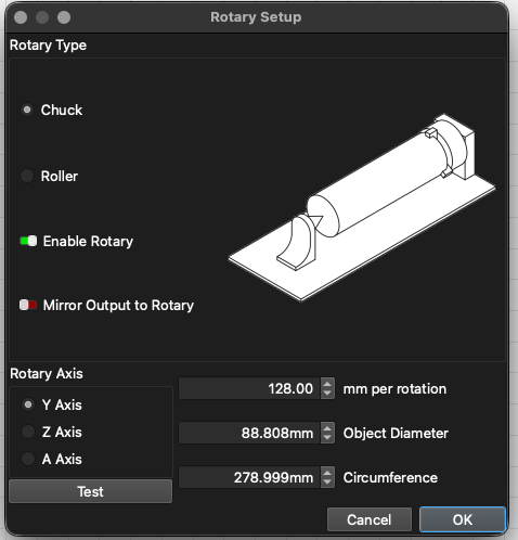

I am having issues with my chuck rotary tool.

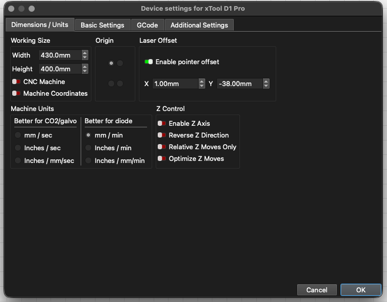

I replaced the original 10w laser module on my xTool D1 pro, for the lasertree k60 module.
Everything works fine on a flat surface. As soon as I switch over to my rotary chuck tool, the laser offset won’t work. The laser moves fine on the y-axis, and the rotary tool follows command on the x-aix or z-axis(not sure of the correct term there), but the traveling metal beam wont adjust the module above “the 38mm” off set that is needed to be dead center on the tumbler I am trying to engrave.
I’ve tried adjusting the x and y axis offset for both and still wont work properly.
Any one run into a similar issue before?
Your second image shows you have a Yaxis rotary. It should be aligned parallel with the Xaxis (gantry). The rotary is driven by the Yaxis commands.
Did you make any parameter corrections for the Ginormous 60w module you installed?
