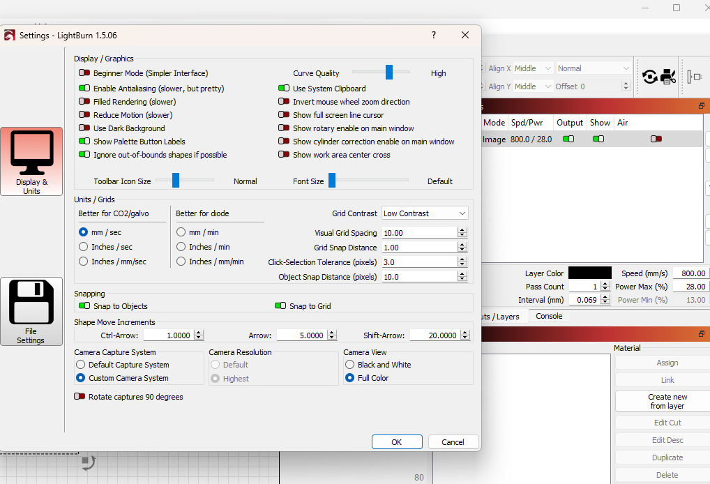

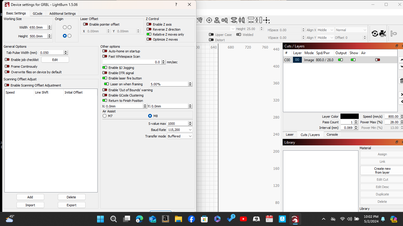

Hello, my laser isnt burning teak. Im using a yorahome 96watt diode laser and speed 800, pwr 28. I’ll share my settings. My laser was working previously when i was using the trial version, after the upgrade something changed after i added the machine again though this is my first time burning teak but cant see it making that much of a difference. Any advice is welcome. Thank you greatly for your time.
I am assuming that is a diode laser corrective?
IF i am correct
Any chance that you should be running in mm/min and not mm/sec?
800 mm/sec is extreamly fast for a diode laser
Also 28% seems very low power for woods
Yes, it is a diode. Ill check if it is mm sec or min. I was running it at 2500 and 25% power previously to the new install and it was burning wood excellently. Thank uou for your reply.
Definitly was 2500mm/min not mm/sec
Thank you, that would make sense.

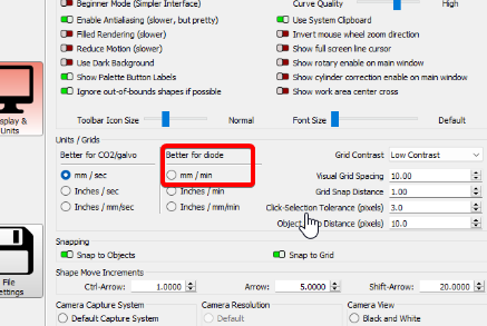

Make sure you change here
Should fix most issues
Thank you so much that fixed the problem. It was set for CO2. God bless you.
