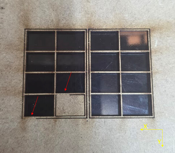

Laser not cutting at the start of a line/curve randomly
I’ve been getting these strange areas where at the start of a cut it is ‘late’ to fire and is generating these missed areas. Now I’ve been around and checked the the flow switch is operating correctly, no lose wires but it seems to occur as seen with the circles at the same point which I would assume isn’t ‘random’ but there is some correlation. Now on the piece below it you see it hasn’t performed this at all and as such was cut correctly.

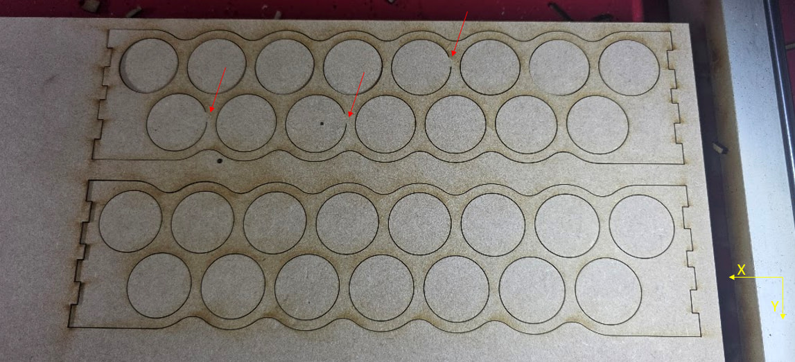

In the other image where I’m cutting out window sections for a model you see it has done the same but with straight lines and again at the start of the cut.
I’m starting to wonder if this may be software related due to the commonality and repeat areas it is doing such.
Would anyone at all have a hint or maybe solution we can work with to see if I can possible troubleshoot this? It is driving me crazy.

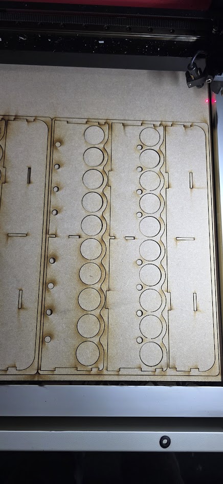

The other interesting thing is that I design/create the build file on one pc and then post the designs to my shared folders and open them on the pc that is in the workshop. The speeds are always different and I need to change them but the power % remains the same, so for instance if I open this file now it shows the speed at 40/60. If i open it at the machine the speed is 1800/60.

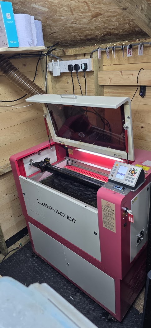

So this is a HPC LS3060 which I’ve brought it back upto a new standard recently after taking hold of it. It’s had a new 80W tube installed, new 80W PSU, new cloudray controller, flow switch all the usual age related items. The school it was from I’ve spoke to them before and it was a low hour machine already but it was old electronically.
Image of the machine now back to a modern standard.
I’ve done a little more research and tried these, so I’ve lowered my start speed to 3mm/s from 10 and it still occurs. I’ve also added a laser on delay of 5ms and it still occurs.

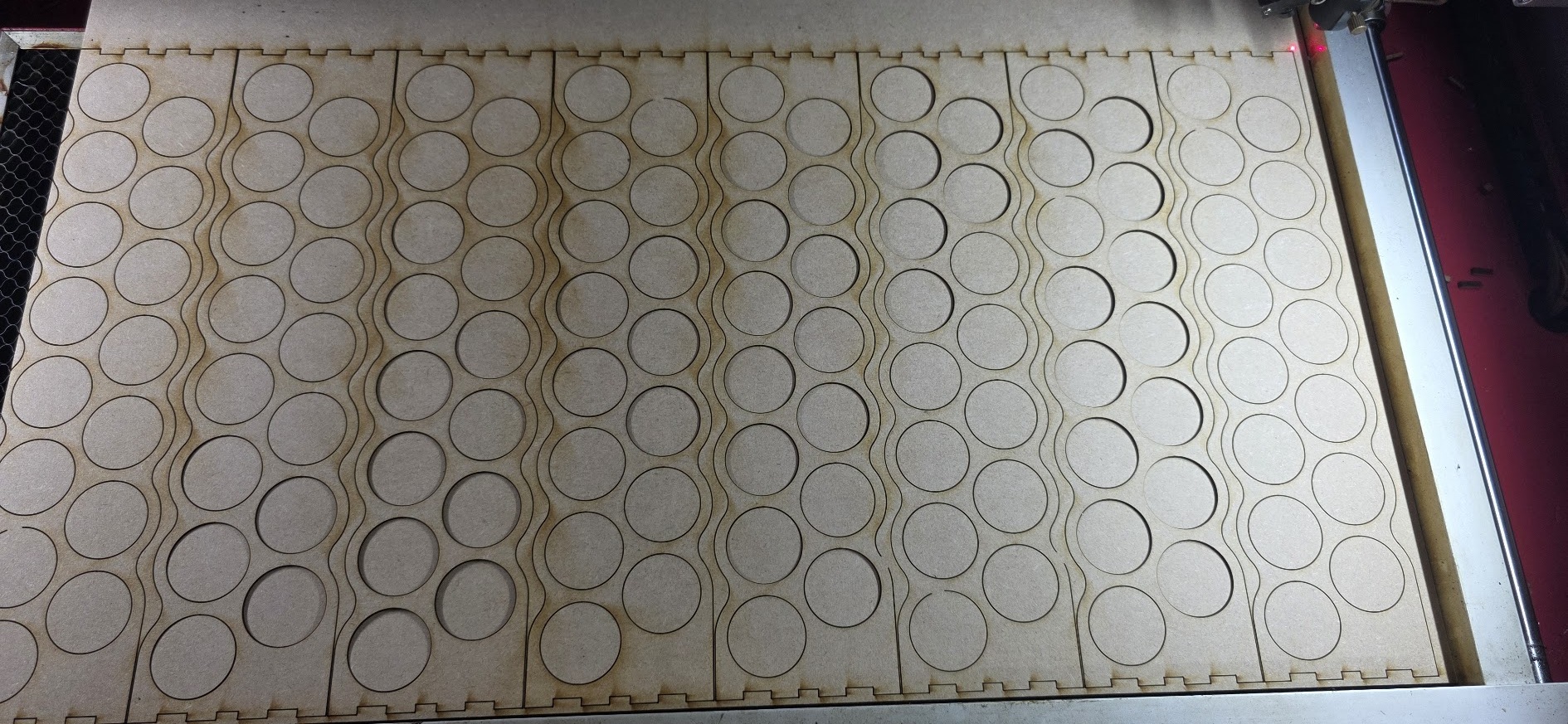

This is the full sheet results of the above file for reference and you see it is on the circles mostly but some edges.

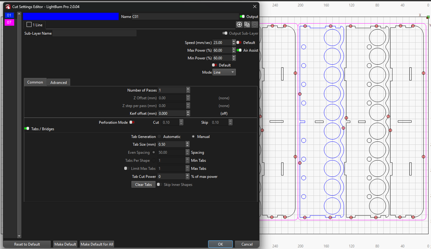

The file you provided seems match your second picture.
On my system, the circles start (and end) at their top.
The file has Automatic tabs set, with one 0.2 mm tab per shape. The tabs are on the bottom of the circles, opposite the start/stop point, and there is one tab on each large outer perimeter near the top of the shape.
Your picture does not show any trace of the tabs and the orientation seems to be reversed:
  • The perimeters gaps are near the bottom
  • The circle gaps are near the top

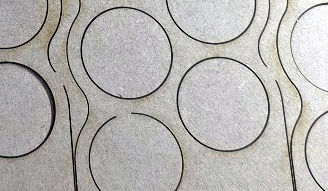

Even without visible tabs (some circles appear to fall freely), the laser tube seems to be shutting down (correctly) at each tab and sometimes failing to restart (obviously incorrectly) after the tab.
Verify that by running the same design on cardboard (because cheap) until it fails, then scrubbing through the Preview to verify which direction the laser head is moving at each failure. If those failures match the position of the tabs, then that’s useful evidence.
Assuming that’s the case, I suspect the power supply is developing a problem: it sometimes does not fire the laser tube correctly after a brief interruption.
Because it does fire correctly when the tube has been off for longer durations, like after the head moves from one shape to another, you can (probably) work around this for a while by turning off the tabs.
If you really need tabs, making them longer than 0.2 mm may give the power supply time to recover.
Replacing the power supply is relatively inexpensive and straightforward, so if you really need short tabs, I’d try that first.
I suspect the power supply is failing, rather than the tube, because the supply controls the voltage and current to the tube. However, it’s all basically guesswork.
@ednisley Thankyou, so we’re good on the issue of parameters being different now.

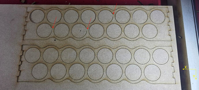

For some reason this particular file has them turned on now on my other designs they are turned off as I have manual ones placed to ensure the kits stay together but the issue is persisting on those too but not in the places where I have put tabs as the tabs seem to correctly be produced.
For instance another kit type here with the manual ones only three of the circles on the right have experienced this issue -

My guesstimate of where the tabs were in relation to the start of the circles could be off by 180°, so it’s entirely possible the misfires occur at the circle starting points in addition to tabs on the perimeters. That would invalidate my guess about the tube not firing after tabs, but that’s what more evidence will do for incorrect notions.
What does the Preview show at the places where the misfires occur?

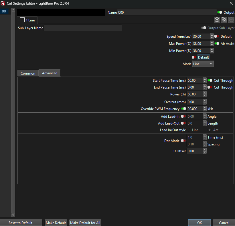

@ednisley So, I did some more messing around last evening and some more today with parameter sets and changes. I do bring some progress at least, I reached out to cloudray and not yet received any response but I do have some news.
I manually added a start pause to my cuts for this layer + power % to 50% and over rode the fq to ensure it definately is at 20khz. Since doing this I’ve rarely experienced the issue, now it hasn’t fully cured it but I may only get say 1 piece still having the miss firing issue at the start of a cut out of a few kits so It has drastically improved the results.
Would these findings present you with any additional ideas or confirm thoughts as to the issue at all?
That definitely shows the tube is not firing immediately when commanded. Waiting 50 ms gives it enough time to (almost always) fire, which means something is going wrong at 0 ms.
You could guesstimate the delay times using an array of squares. The length of the gap on the side of a failed square corresponds to the firing delay, using the RepRap calculator to figure how long it takes for the laser head to travel that distance along a straight line from a standing start.
Removing the tabs shows the problem happens after the laser has been off during the move to the shape and, after the tube lights up, it remains lit until the end of the path. You can verify that by using the Preview to see which way it moves along the shapes.
The Override PWM Frequency should have no effect, because the high voltage power supply filters the PWM input to extract the power level. That filter has a cutoff around 200 Hz, so pretty nearly any PWM frequency will work fine. Disable the override and I expect nothing will change.
It’s either the power supply or the tube and I’m still thinking “power supply”.
