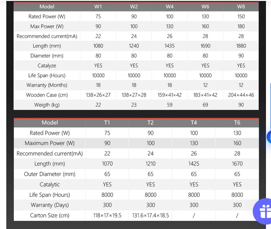

This is from Cloud Ray and gives you an example of the expected lifespan of these tubes…
Unless Velvor has a special tube made, you can probably ask Cloud Ray the life expectancy of their tubes… I’d buy one of these over one with a 2k hour life expectancy… IMHO…
