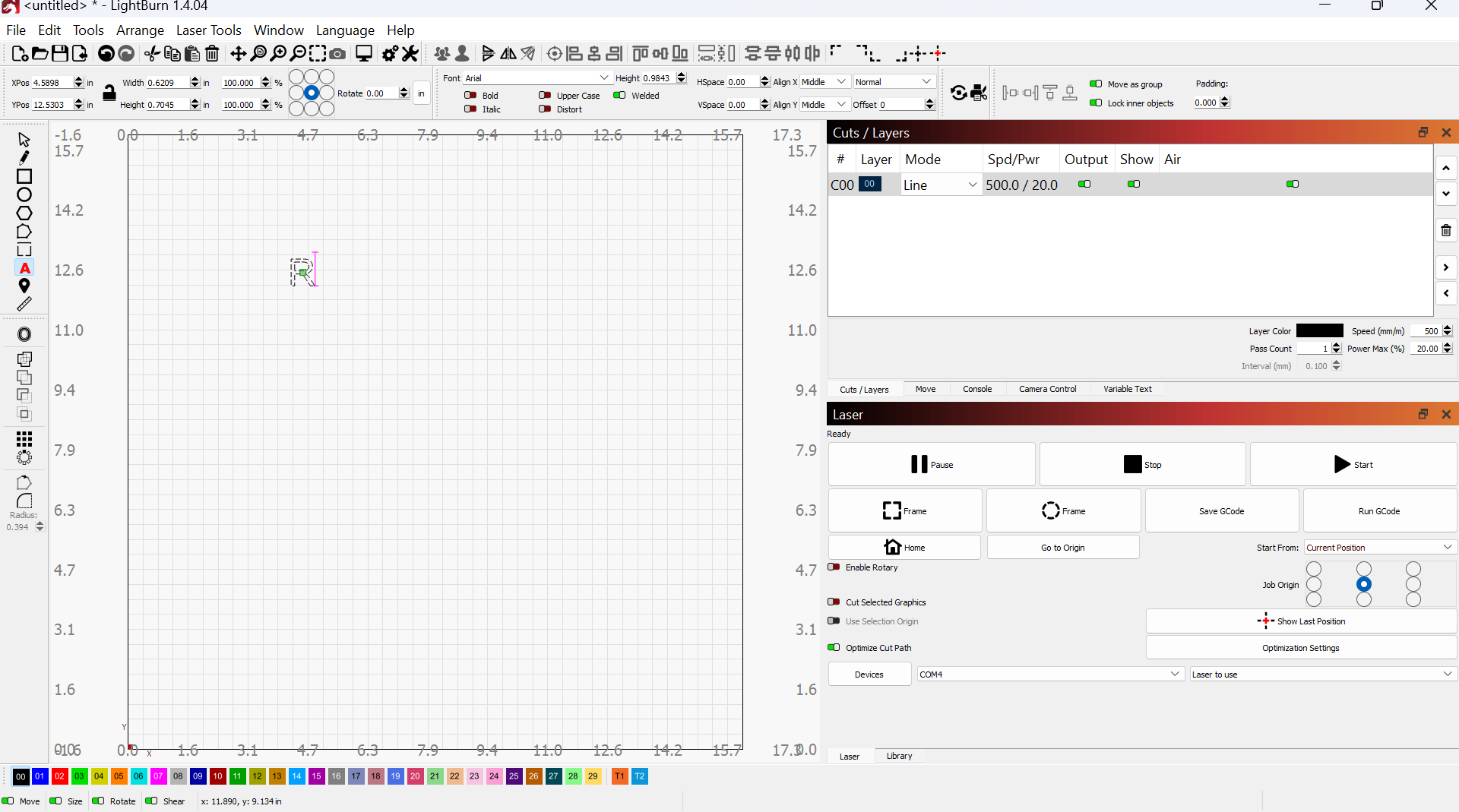

I am new to this, but I’ve got my settings at speed of 500 mm/m as recommended, I am trying to just engrave a simple letter R to practice. The laser lights up and starts to burn, but is just sits in one spot and burns a dot.
I am at a loss at to what to do. I have tried watching videos and reading the manual, but I have to be missing a step. When I try to ask for help on a Facebook group I get no answers. I just need to know what my settings should be, what are the steps to take to engrave words?
Please help me before I cry! I’ve tried for 3 days straight to figure this out and I am about ready to give up and send it back.
Can we get a full screenshot with cuts/layers window open with your project?
Can you control movement from the “move” tab?

Here’s what I see. When I click on the arrows in the move tab, it will go left to right, but not front to back
What happens if you engrave a square?
Also have you homed your laser?
It won’t engrave at all. It just sets in one spot and just burns a hole. After doing some research on this through Amazon and other people that bought the same thing, everyone is having the same problem. There were 5 other people that said there’s doing the exact same thing and they just sent it back. So that’s what i’m doing.
