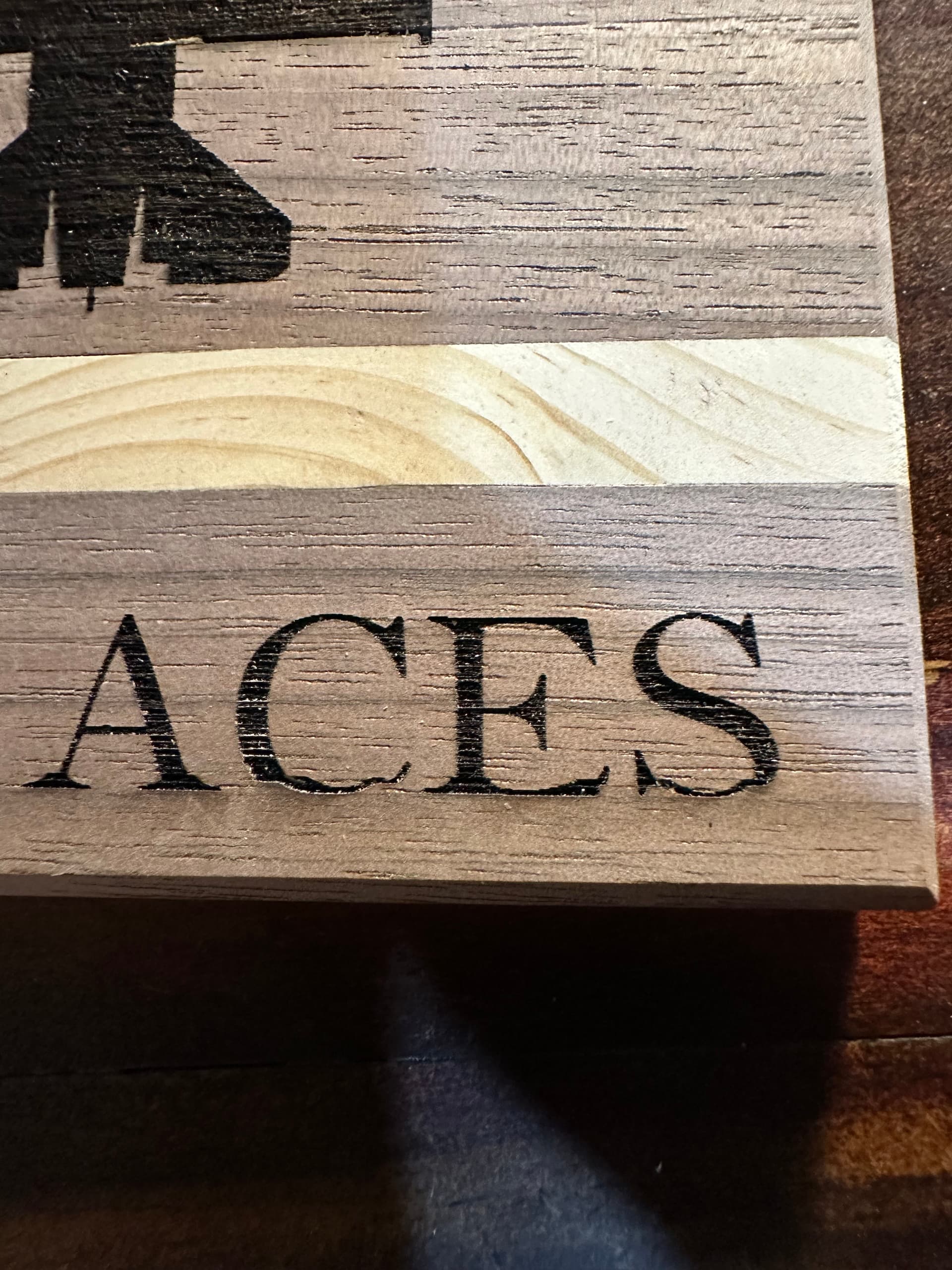

The bottom of the text is coming out looking odd and not as depicted in Light Burn. Any ideas? Can laser speed be an issue? Thanks!
CP.lbrn2 (76.3 KB)
That generally comes from mechanical problems in the Y axis drive train.

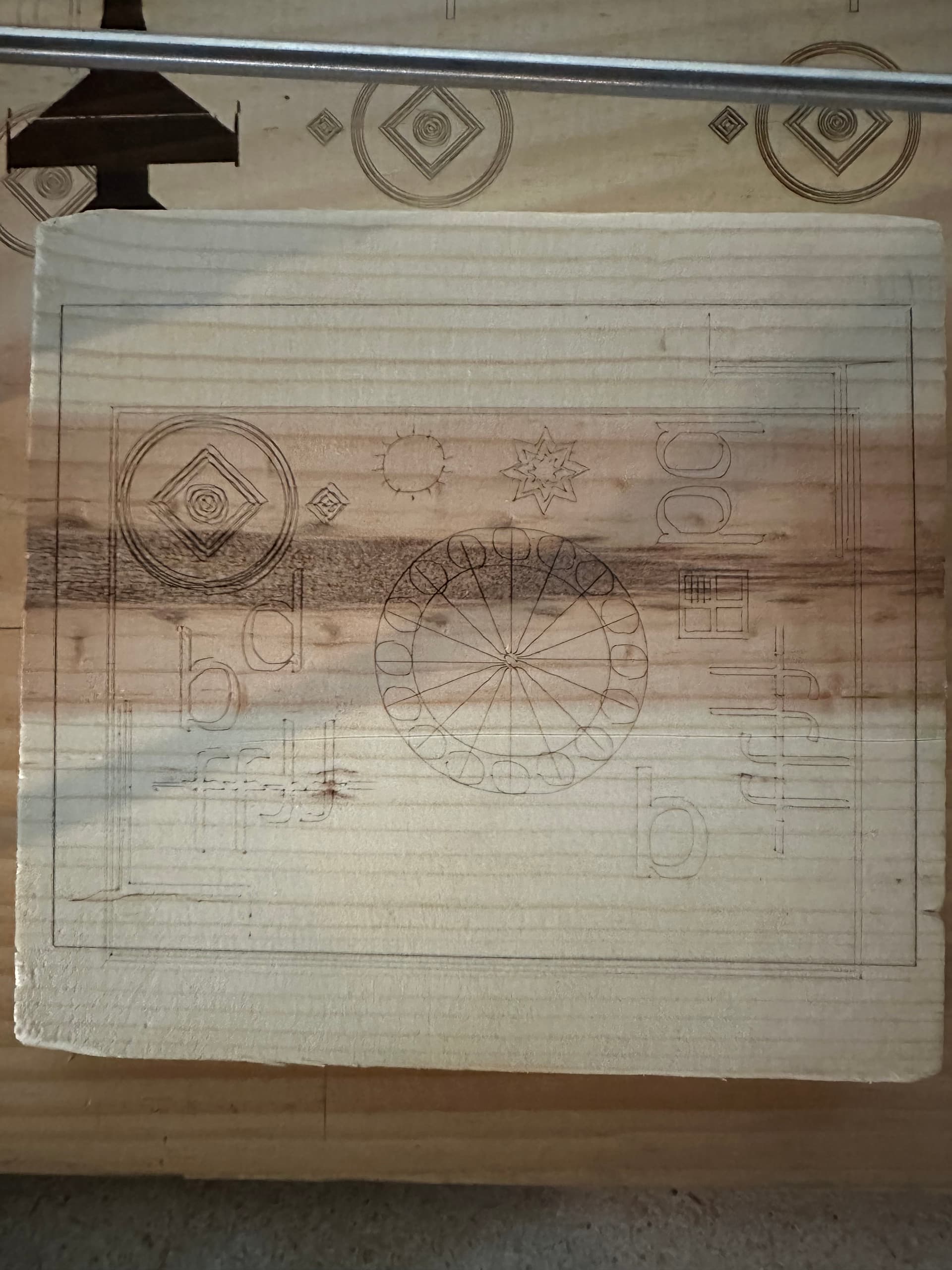

Run this test pattern for a quick check of the machine’s mechanical integrity:
Scale it uniformly to fit the platform and run it as fast as the machine will go in Line mode with optimizations turned off and power set to mark a sheet of cardboard.
Upload a photo of the results, because the differences from the design will show what needs attention.

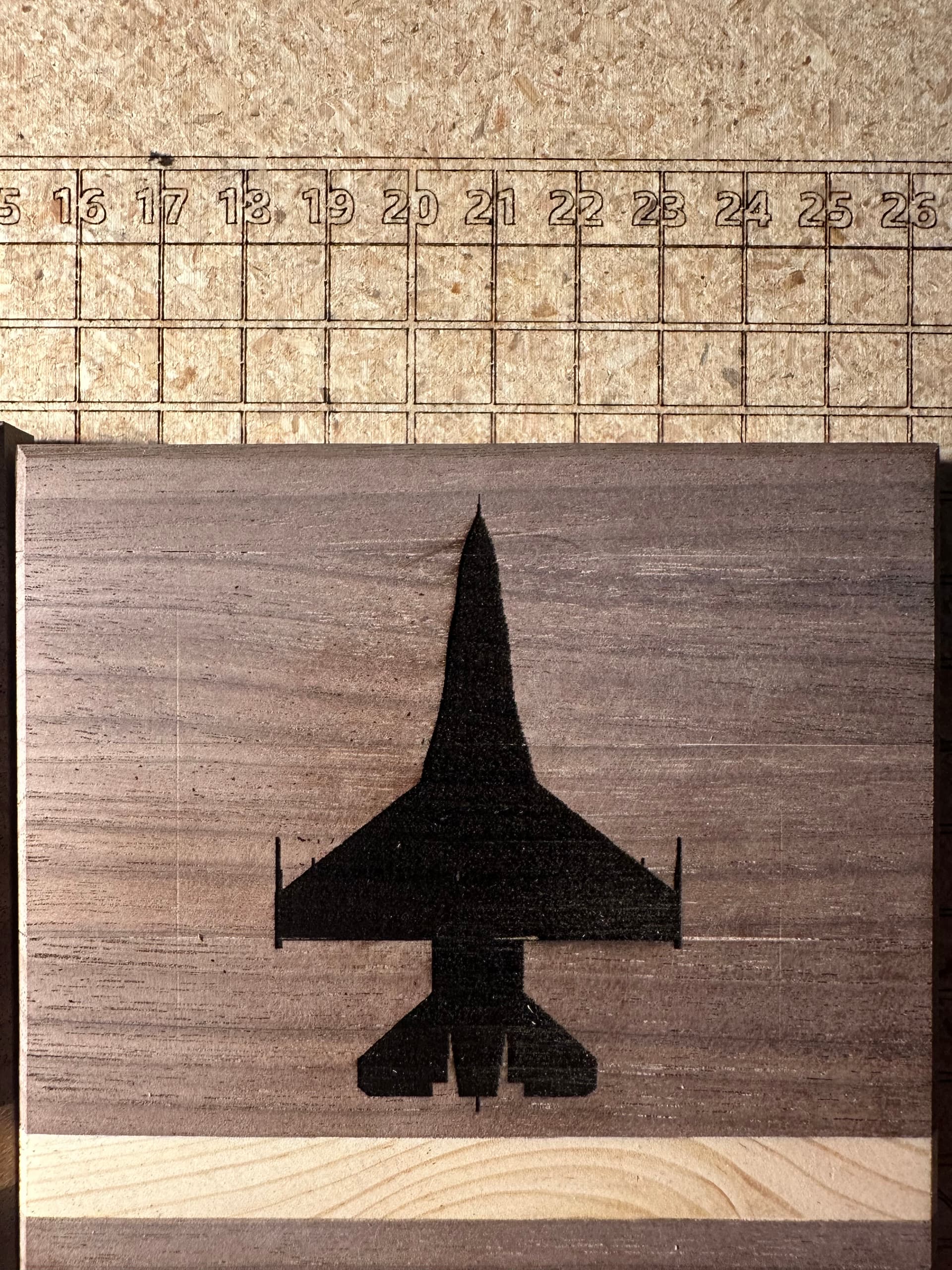

Okay thank you! Could belt tension be a causal factor? I’ll run the test, what exactly should I be looking for to asses mechanical integrity?

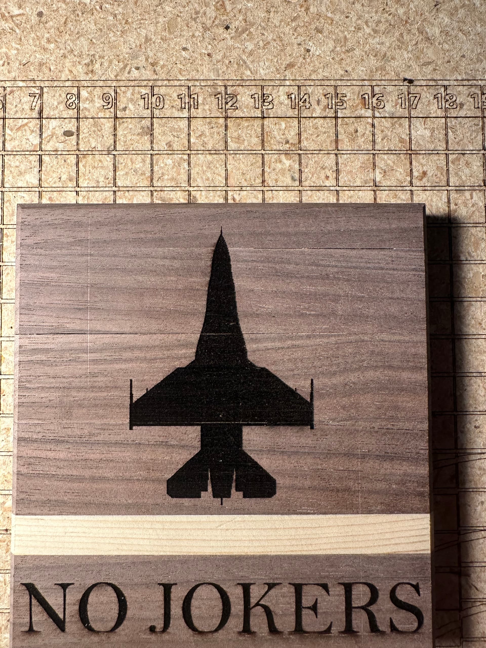

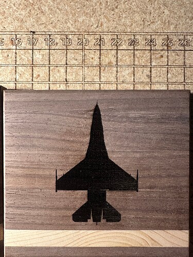

Also could the same test assess what is going on with engraving this image? It engraves incorrectly about half the time and I have no idea why. I have attached the correct and incorrect engravings. You can see the wing of the plane is “bent” which it is not supposed to be.
Perhaps, but diode lasers hide their problems in many other places.
Let’s keep it simple: run the test pattern, take a picture, let’s see what it shows.

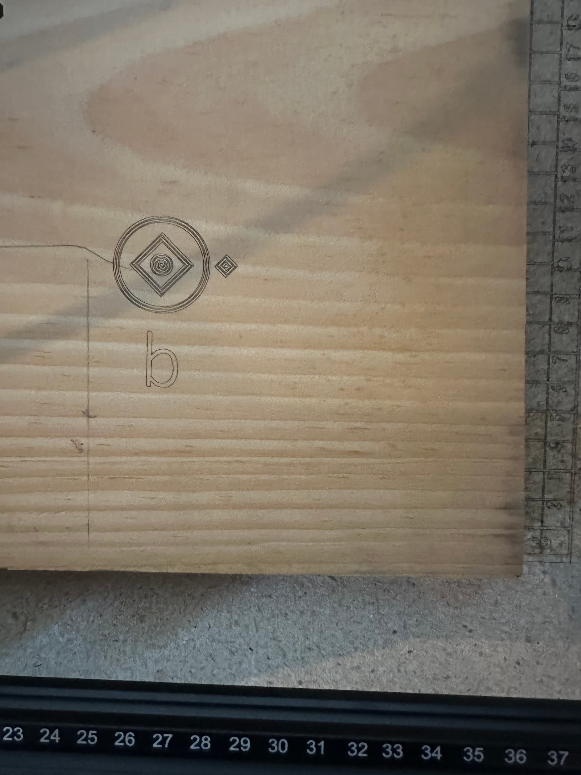

I ran the test, it did not come out great but I relized my Y axis belts were quite loose. Tightened them up, ran it again and every time it stops mid job and I get an error.
If the first picture shows the results after the belt adjustments, then it has far more mechanical problems to be corrected.

Apparently, the test figure shakes your machine in ways it doesn’t normally get moved, which is the whole point of the test figure.
Start by anchoring the legs to the table, so that the frame cannot move. If it’s on a large “waste board”, just screw each leg to the board.
The LM2 User Manual may have other suggestions.
After the frame is secured, run the test and see what happens next.
