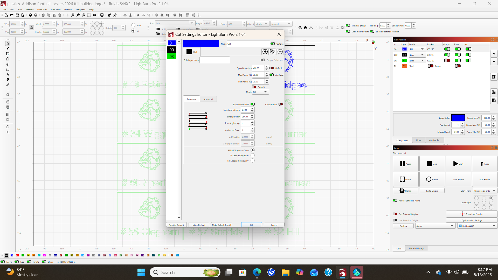

I am engraving on plastic. My speed is 400. Max and minimum power is 70. This is what I have used in the past.

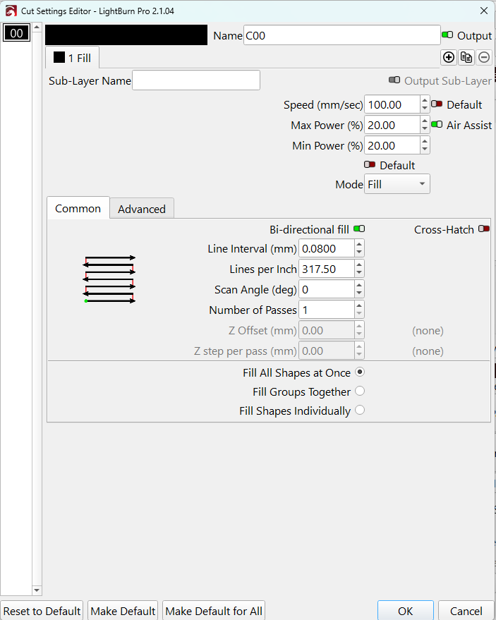

Here is a picture
Here is a picture
Hi @Donnie10
Those settings look normal. Could you click the Advanced tab in that same Cut Settings window and post a screenshot of it as well? I’d like to check whether Override PWM Frequency is enabled.
Thanks for replying. The PWM was on disabled. Should it be enabled? If so, what setting should I use? When enabled, it is on 20.000 currently.
