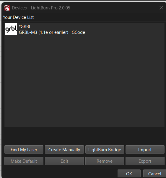

Hiya, yes, I looked in all sorts but I think I may have come up with a solution (I’m trying it now as I type) I’ve deleted the machine and reinstalled it as GRBL-M3. I noticed when I looked at Laser GRBLs Gcode it started with M3, yet the Gcode for lightburn started as M4.
I’ll try it in a minute and let you know.
Thanks again :slight_smile:
That seems to have done it, so in summary. If you have a Creality Falcon 2, make sure you select
as your device.
If anybody has something else to add, please do.

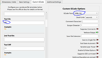

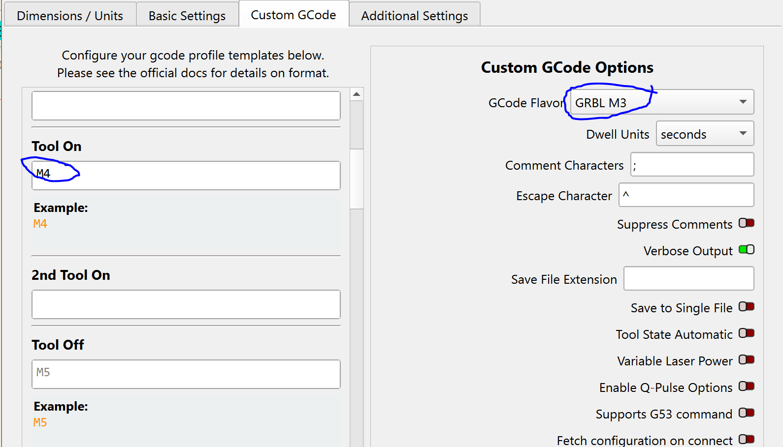

You can try creating a Custom GCode device as GRBL-M3 Flavor then change Tool On to M4 and test.
Official Lightburn doc:
thanks for the advice, its seems to work now.
I think this is more of a setting issue and while it is working, you are getting limited function.
The Falcon 2 firmware is based off of GRBL 1.1F and the standard GRBL device in Lightburn can work with 1.1F and newer. The M3 device in Lightburn is meant to support machines with firmware based on older versions of GRBL before 1.1F. (The previous information can be found in the Lightburn documentation.)
If you are part of the Creality Falcon Laser group on Facebook, I believe there is a lbdev file in the file area of the group that can be loaded into Lightburn. I have an older Falcon laser that uses the standard GRBL device and found that if I used the “Find My laser” it loaded the M3 device. With the M3 device, the constant power setting was not available in Lightburn.
