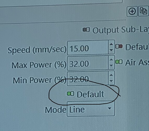

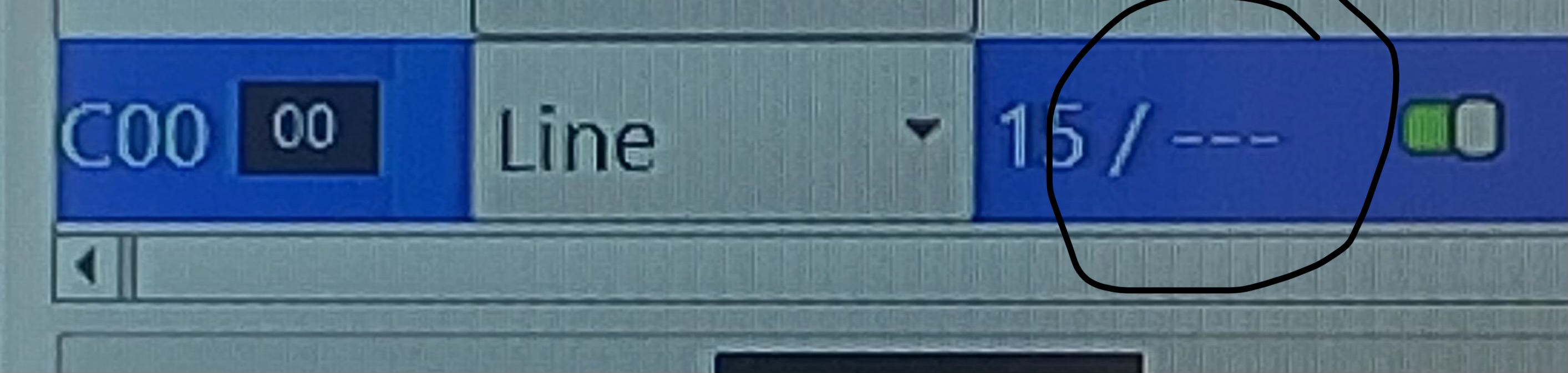

Sorry, I should have included photos… it is in light burn. As long as it’s selected, everything cuts. But, it blurs out the power. If I unselect the default, it will run through the project, it just doesn’t fire the laser.
Hi @Jayme0811
By using the Default toggle, you’re likely asking LightBurn to use universal defaults, which in this case probably have sufficient power or speed set to run your project. If you have not setup your own defaults that is.
We have a guide to using default layers here, it even has a video.
This is one of those little UI glitches:
- The
Defaultswitch forSpeedis immediately to the right of the numeric field - The
Defaultswitch forPoweris directly below theMin Powernumeric field
The tooltips correctly identify the switch functions, but their different locations imply they do different things.
The overall window isn’t resizeable, so it’s a deliberate layout choice.
Maybe have a UI tweakist move the Power switch up-and-over for consistency with the Speed switch?

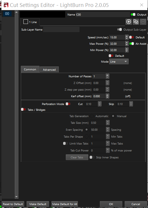

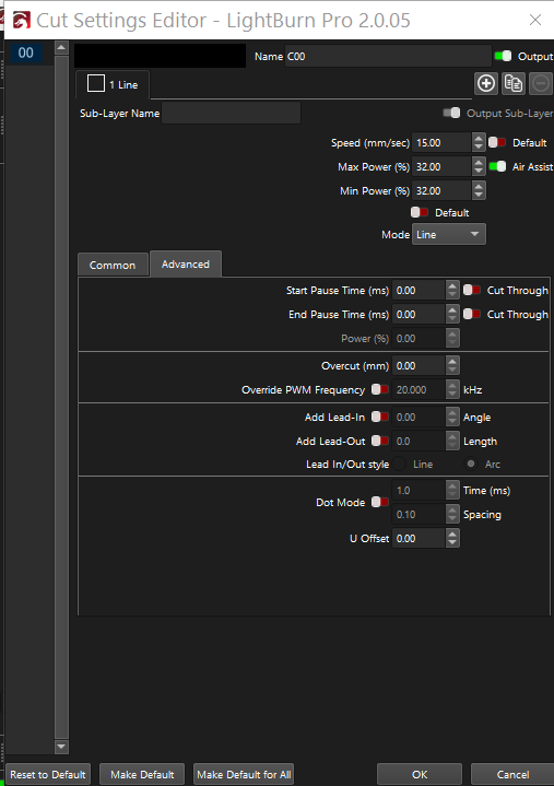

The laser continues to only fire if i have one of the default switches (Power or Speed) toggled on. For the past two years that I have used my laser and lightburn, I have never had to toggle this switch on and have been able to use both the speed and power necessary to cut or engrave my material. If I have the default on, it cuts through, albeit, a little chared. But, If I engrave with the default on, it burns too much. I tried to upload a video so you can see what I am talking about. but it won’t upload. I don’t know if pictures would be helpful, but if you think they might, I am happy to try and upload pictures instead.

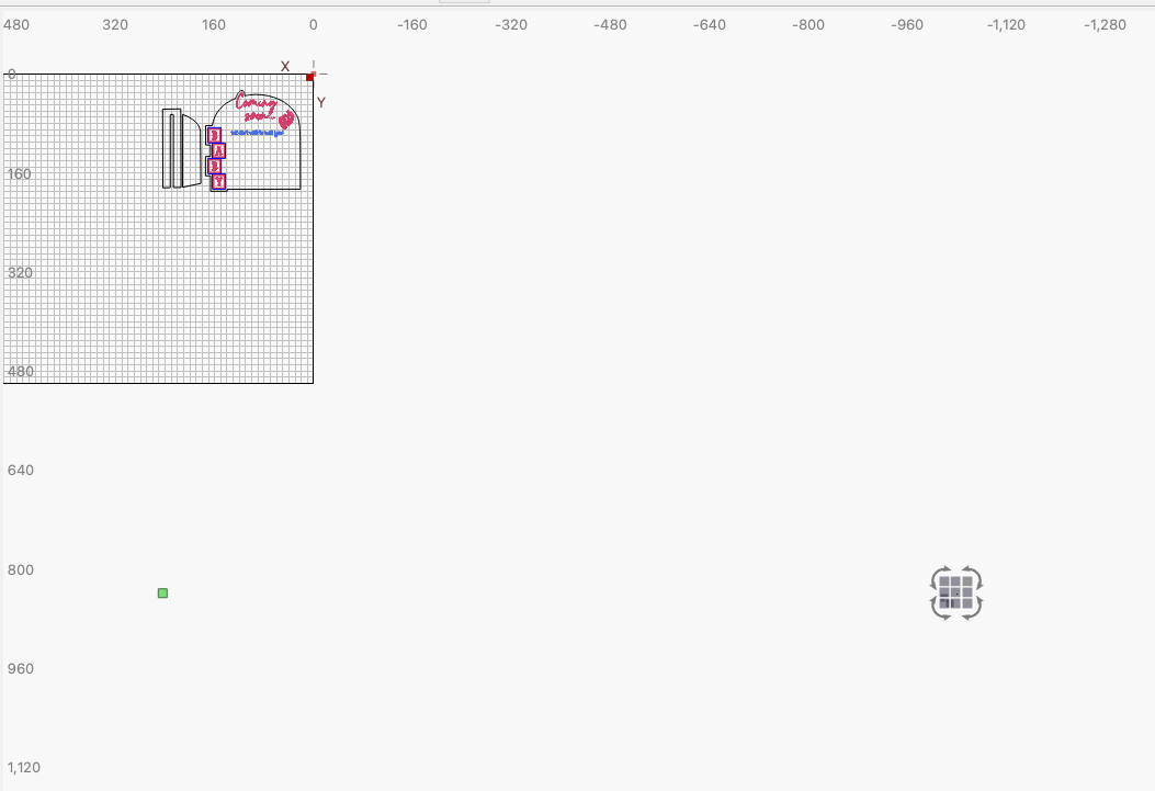

Not sure if this will solve all your issues, but you have an errant shape way out in right field. See screenshot below.
Thank you! This was just the first file I grabbed; I’ve tried several different ones with the same outcome. But, I did remove the extra element at the bottom of the screen. Thanks so much for trying to help!

There’s nothing obviously wrong with the file, so it’s likely two non-obvious settings interacting.
LightBurn’s Universal Default settings are:
- 100 mm/s
- 20% power
However, that doesn’t tell us what the defaults are for your setup.
Do this:
- Start a new file with
File → New - Draw a square of any convenient size
- Put it on layer
C00 - Repeat 2-3 for layers
C01,C19, andC20
Those squares will now have the default settings for those layers. Make a screenshot (please, not at cellphone photo) of the Cuts / Layers window showing all four layer settings and attach it to your reply so we can see what’s going on.

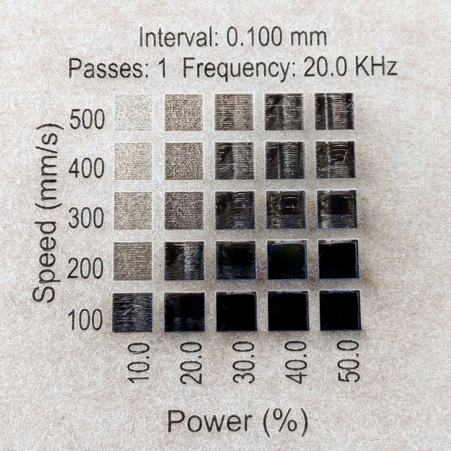

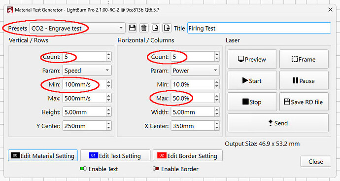

Start a new file, then run a Material Test to show how the machine behaves over a range of settings:
- Select the
CO2 - Engrave testpreset - Hit the
Edit Text Settingbutton, then:- Select
Fill(rather thanLine) - Set the speed to 200 mm/s
- Set the power to 10%
- Hit
OK
- Select
- Tweak the rest of the settings as shown
Lay down some cardboard and Fire The Laser:
Your 100 W laser will torch more of the lower right squares through the cardboard than my 60 W machine, so keep an eye on the laser and a hand on the water spritzer.

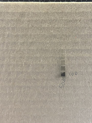

Upload a good photo of the results along with everything else.
Taken together, (IMO) it’s a hardware problem, not a settings problem.
The Material Test shows the tube does fire, but a 100 W laser should torch cardboard at any power while running at 100 mm/s, which means there’s not much energy reaching the material. The question is whether the tube is not producing much energy or something is dissipating that energy along the way.

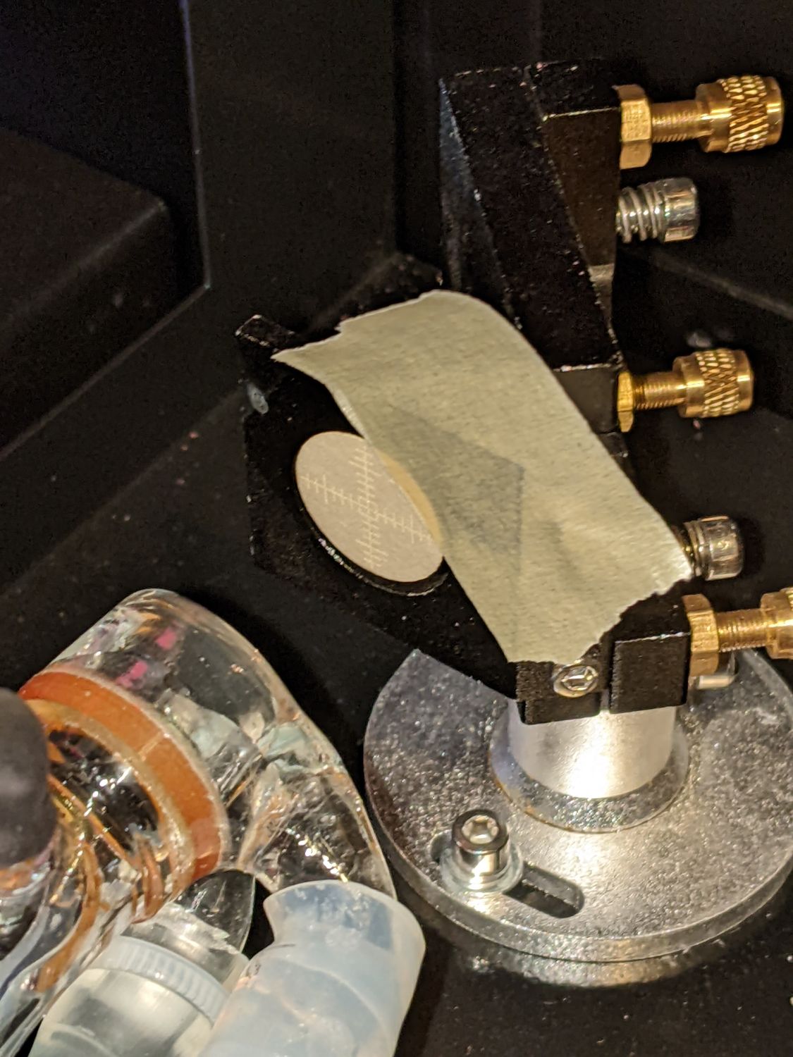

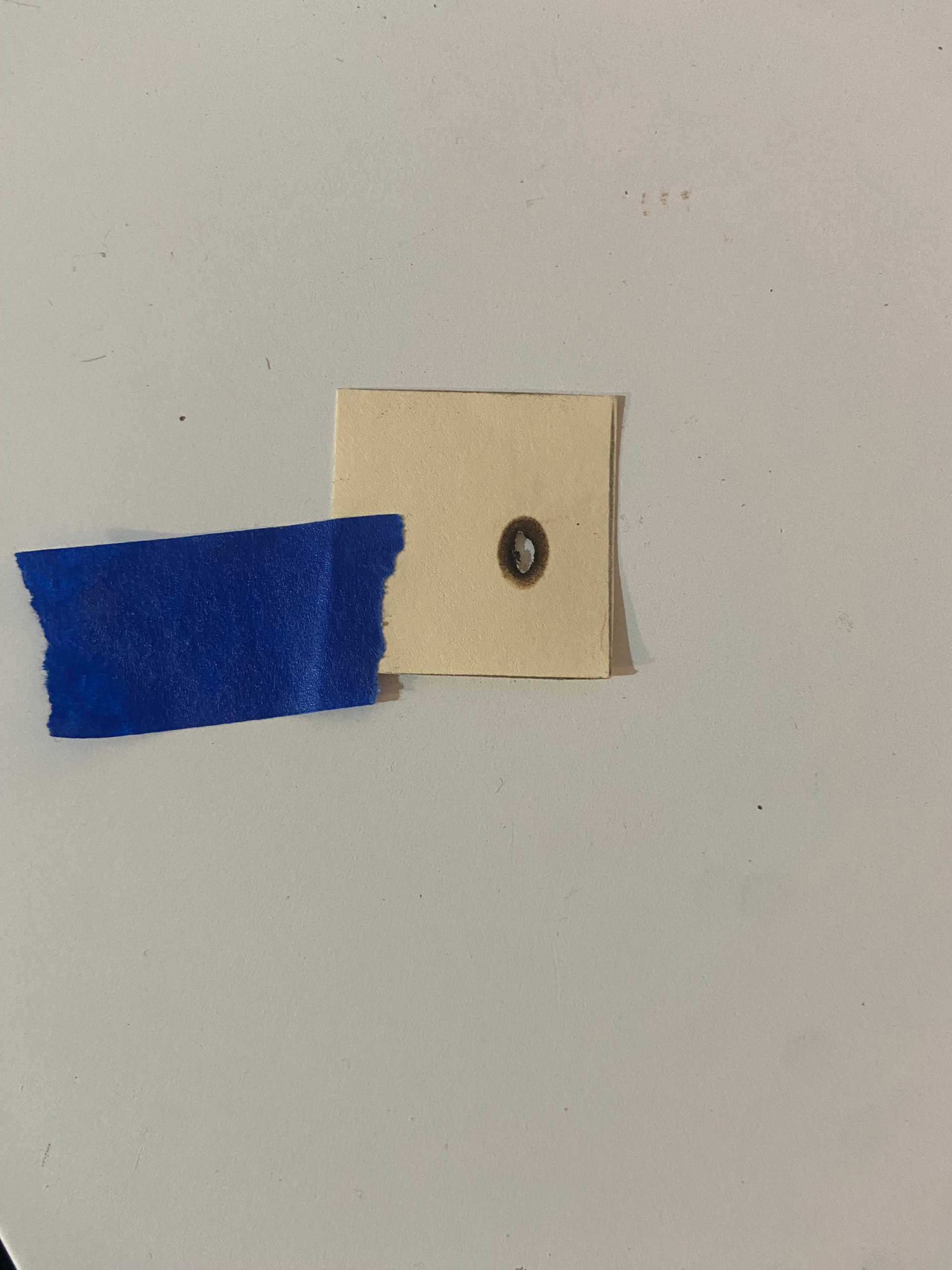

Start by cutting some one-inch squares from a manila file folder or similar heavy paper. Tape a square on the entrance to Mirror 1, which is the one in the back of the machine just beyond the end of the laser tube. I made round targets, but there are few style points for this task:
The controller on the machine has a button labeled Pulse (or something similar) to fire the laser; as always, with the water chiller running and the lid down.
CAUTION Close the lid over the laser tube before firing the laser. The beam should be nice and tidy, the high voltage should be well contained, but close the lid. ![]()
Press the Pulse button quickly, open the lid, and see what happened to the target paper. What we need is a brown scorch, not a crispy hole burned through:
If the briefest pulse you can manage blows through the paper, that may be good news. If it’s weak, repeat the pulse enough to make a visible mark. Then take a picture for show-n-tell. ![]()

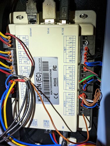

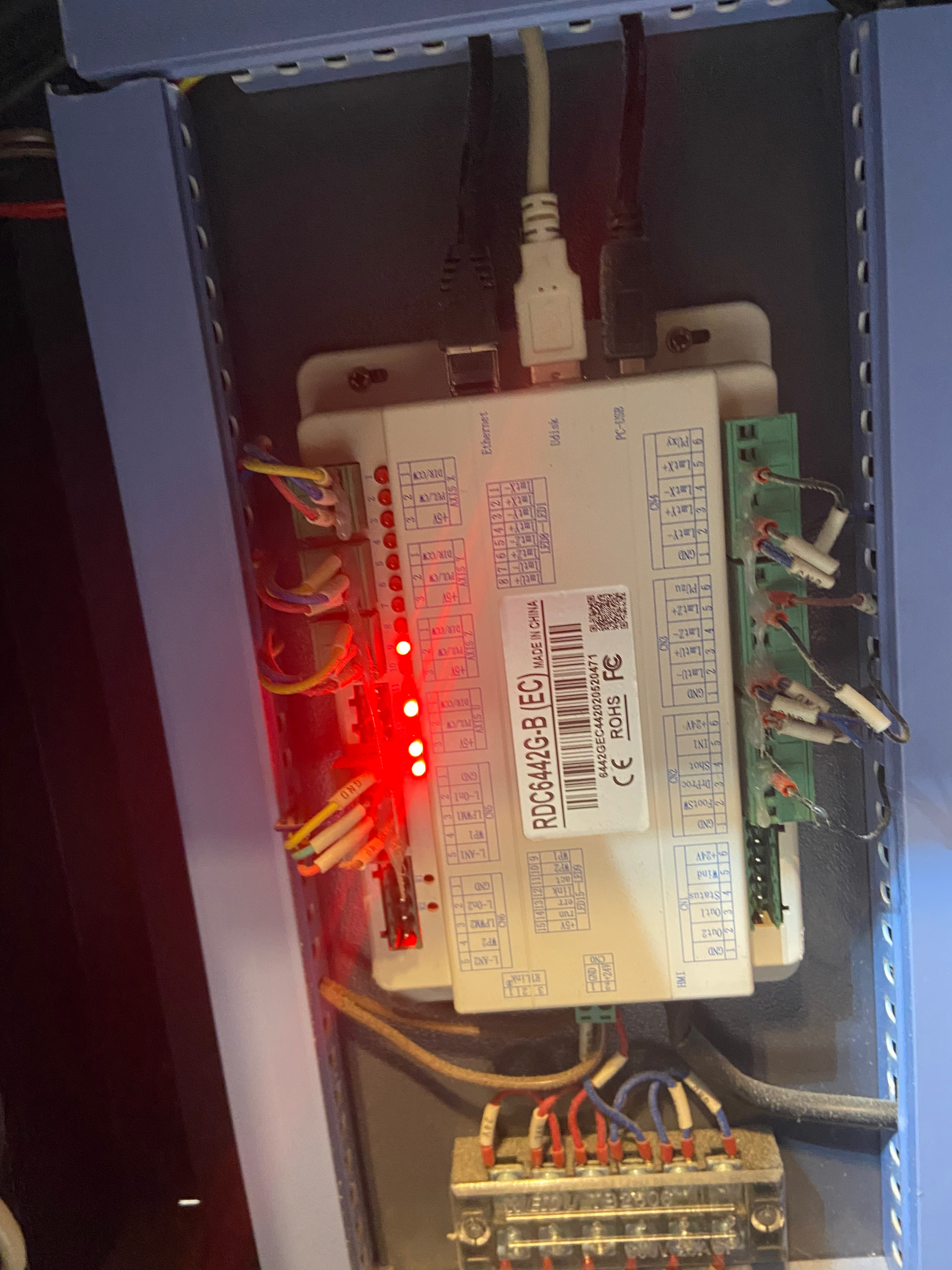

You can set the Pulse power and duration for consistent results, although how you do that depends on which controller is in the machine. Open the electronics bay on the side and the controller should be visible, typically hidden by a tangle of wires:
Tell us the model or show a picture.
Knowing the model, you can then find the manual online, perhaps at:
It will be difficult reading, but it’s a start.
Hi Ed! Here is my show and tell for the day! ![]()
The laser blew through the file folder with just a brief tap on the pulse. Hopefully that’s a good sign… and here is my controller.
The oblong shape of the scorch suggests the paper was against the mirror, at a 45° angle to the beam. Is that correct?
The tube appears to be producing plenty of power and the beam shape looks good (assuming it was at 45°). That means there’s a problem between the laser tube and the nozzle.
