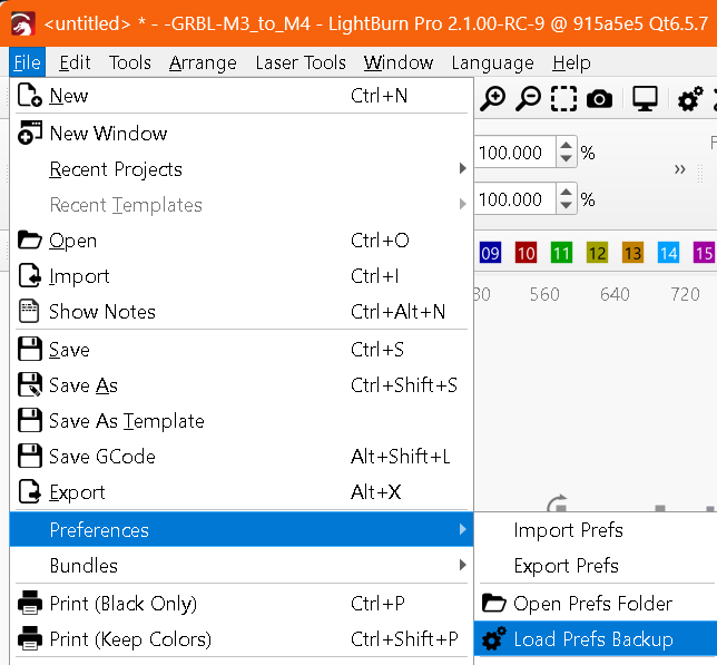

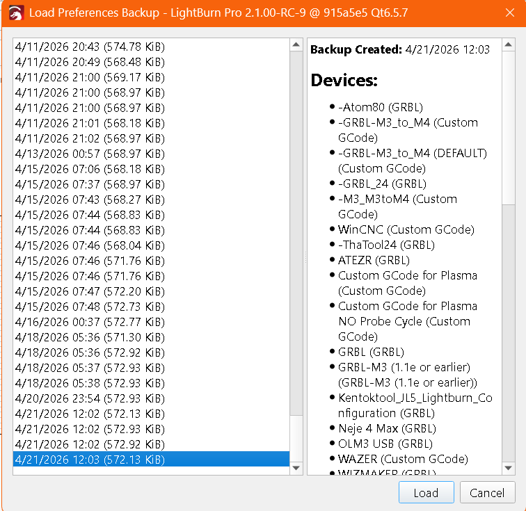

Try loading a prefs file from the Backup when it worked.
In future when the same thing happens try resetting the connection first by right-clicking the Devices button.
