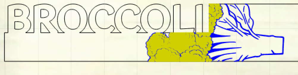

Hello,
This has happened to me a couple of times, and I don’t know what’s going on.
I have the laser set to Absolute Coords. It seems like the laser jumps down for some reason, and I can’t figure out why.
The artwork is together as a group. Why is it doing one layer lower than the other?

Hello Gary!
Machine: Omtech 60W Red & Black
Operating System: macOS Mojave
Connection: USB
Lightburn: I am not running the latest version. I am trying to find the version, but can’t find it.
This is what it’s supposed to look like:
For this cut, I sent out the engraving first, and didn’t send out the cut with it.
It started engraving from the top (pepper) and worked it’s way down fo finish with Bean.
You can see the fill was done properly, but then when the line came into play, for some reason it knocked everything down.
This is not consistent. I have done a lot of cuts with these layers, and it’s random for when it decides to jump off. When it does, it ruins the entire piece.

Post the file if you are willing and we can review. Is your system able to scan fill at 400 to 500mm/sec as you have it set. That seems aggressive. Have you been able to repeatedly scan at those speeds with this system?
Yes, so far 400 to 500 mm/sec has been working out well. I have produced a lot of these etchings with no problems, but every once in a while the laser will jump off like this and I can’t figure out why. I actually deleted the design that was acting up and started over, but the next time it does it I can email over the file. What’s your email?
support@lightburnsoftware.com and include a link to this post for context. :slight_smile:
You may have the accelerations set a little aggressive / fast, causing it to jump, but you can check what is recommended by your manufacture.
