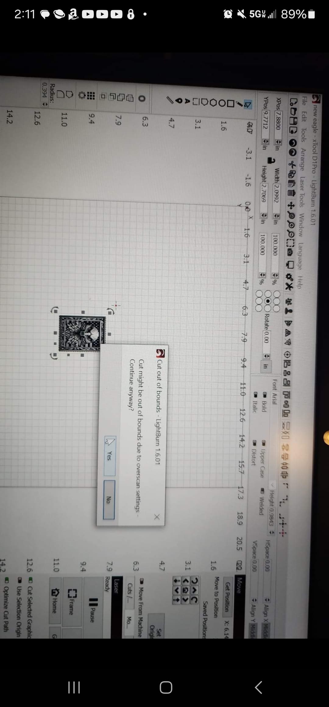

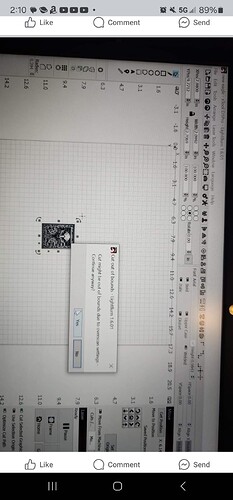

Laser will not engrave or make lines. It says cut might be out of bounds due to over scan settings. I have made this image multiply times with no problem. I even resized it down to 2 inches by 2 inches. It still says the same thing. Also when I move something to engrave it isn’t moving properly. It is not the laser I used the old software and it moved fine.

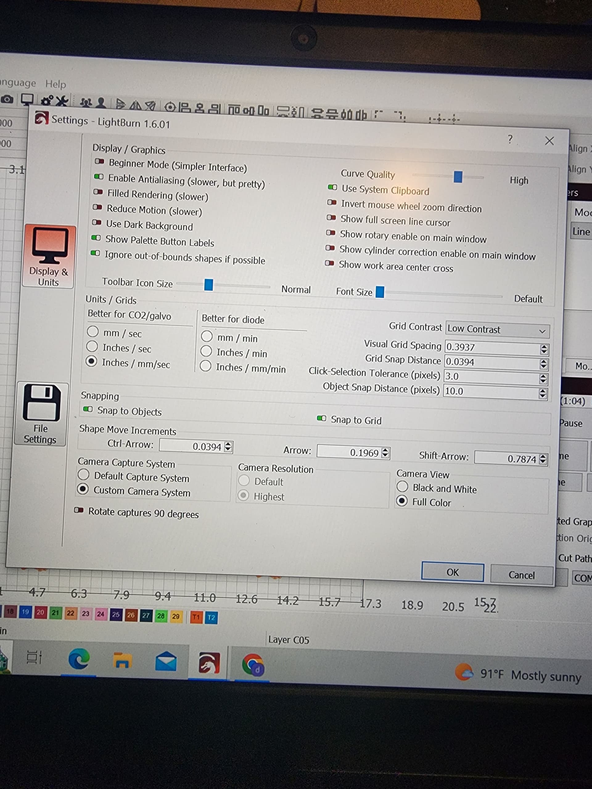

Post a picture of your cut settings.

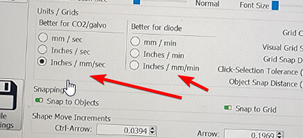

inch/mm/sec, i thikn you wnt inch/mm/min
Can you post your cut settings?
Is possible you used a too high speed and the overcscan is going out of bounds
it would not even let me start to engrave
