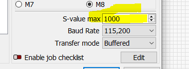

Can you type $$ into console and paste results?
Also in device settings what is this set to?
Thank you for replying. The S-value max is 1000.

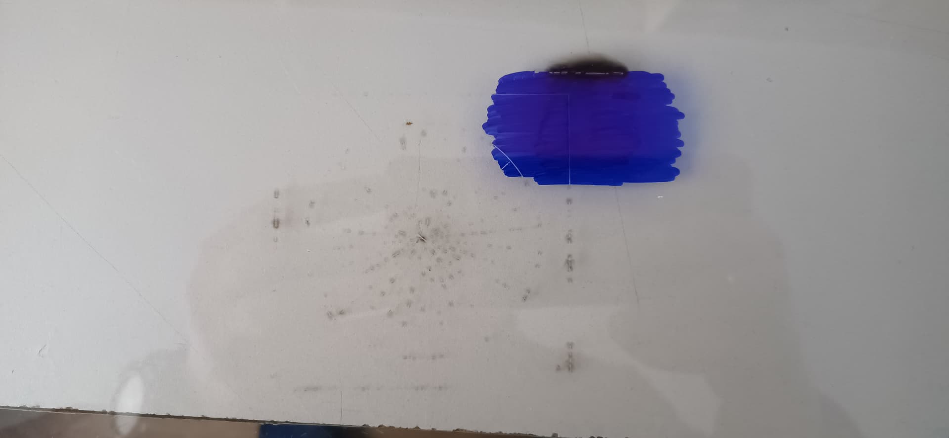

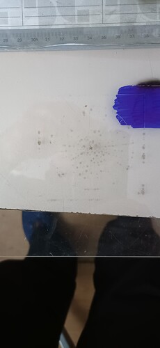

I used the file you send me. It didn’t engrave it on plastic (barely scratch it) but at 60% power it “engrave” it on cardboard. It should have burn the cardboard but it barely cut the upper layer. The only place that cut the board was the center of the cycle because it passed many times. I will send photos on weekend
This is one of the files i try to engrave.
Card Position 2.gc.txt (118,9 KB)
These are the results i told you about.
As you see the plastic is almost intact. But if i use Neje Software with 40% power it will cut the plastic like butter.
And in Neje Software cardboard was on fire at 30% power
