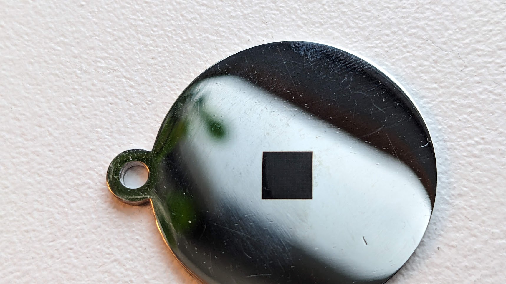

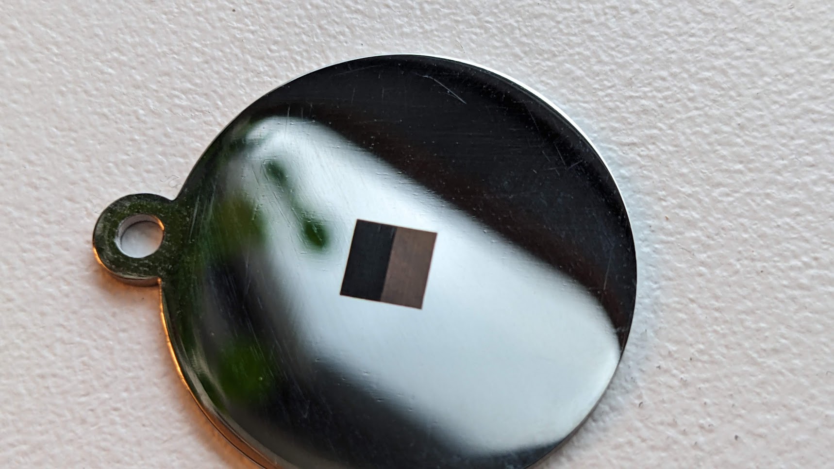

HI, I have an atomstack S10 pro (X7) that has been working fine for some time now. but recently I had a batch of lasering that isnt as expected. I have changed nothing in the settings (makes me think its the laser) but its like its not outputting at 100% all the time.
I ran a test peice at 85% power, just a black square, worked fine one side, the other looks like 50% of it is at half power or somthing…?

The speed is very slow 180mm/min and overscanning is switched on.
Also, as noted in the OP, the front and back squares are both from the same file, no changes made in-between.

Some questions:
  1. Which side was run first? The full side or the half side?
  2. Are the photos in the orientation that it was burned? Was the scanning run horizontally? Uploading the .lbrn file would reduce ambiguity here.
  3. How often do you see this problem? Is there a pattern to when it shows?
Without additional context I tend to think this is a hardware issue. Make sure the cable from controller to laser module is not loose or damaged in any way. If this occurs readily enough you may want to measure PWM voltages at the controller to make sure the signal to the laser module is correct.
If you’re absolutely certain you made no changes to the settings (*), then the problem is in the hardware or the material.
If the problem appears on the same material, then it’s in the hardware.

Thanks for the reply, I use the machine for daily production runs, I’m the only person that uses it and im certain I haven’t changed aything. I kinda think its the machine, its been doing a lot of work and its only a cheap thing, maybe time for an upgrade!
I’ll keep testing a see if I find anything.
