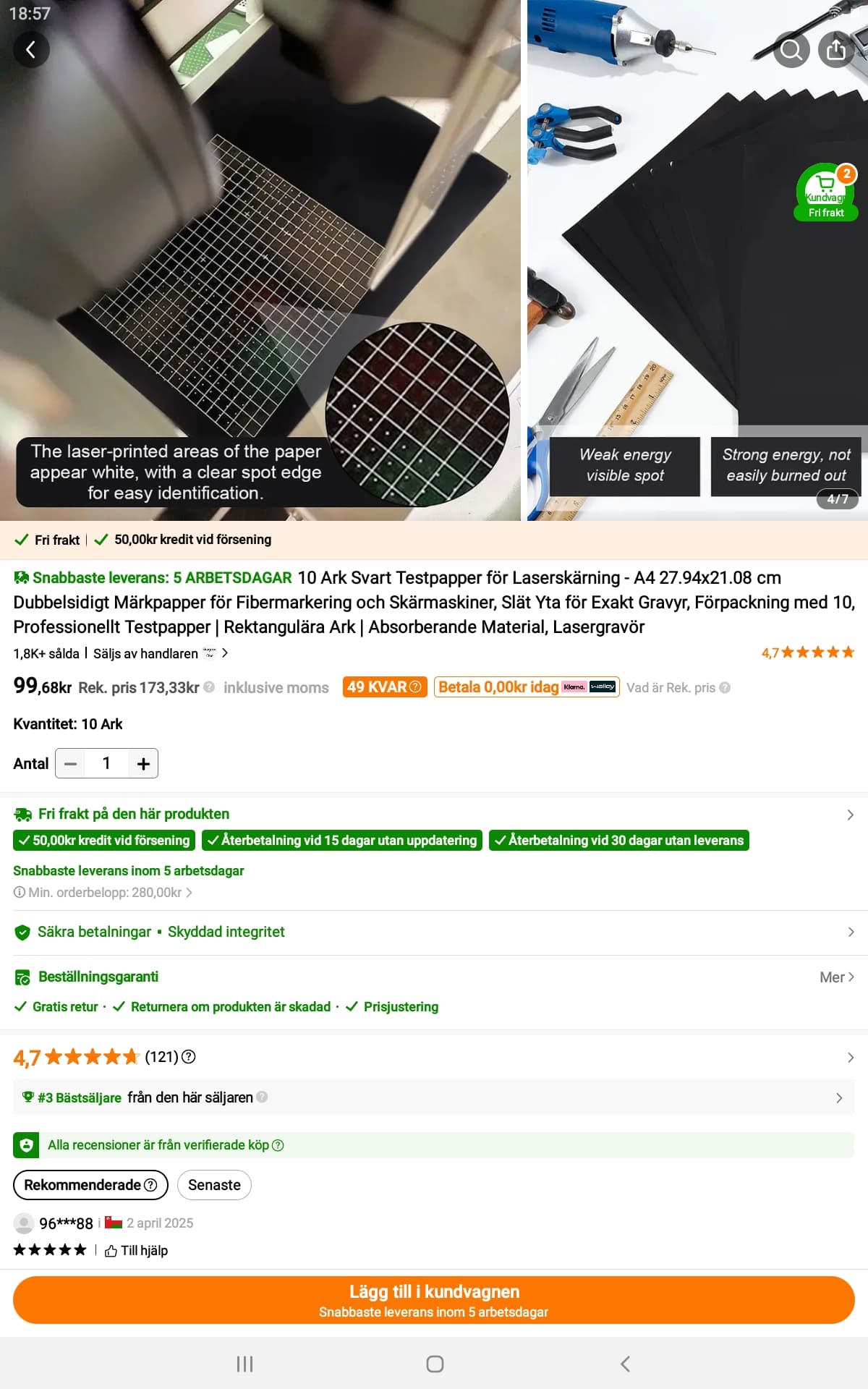

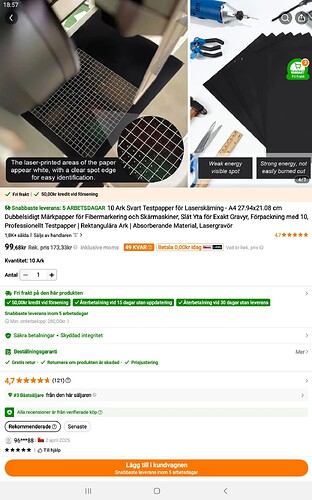

Laser paper question
Does anyone knows what the paper is use for
i included in the post.

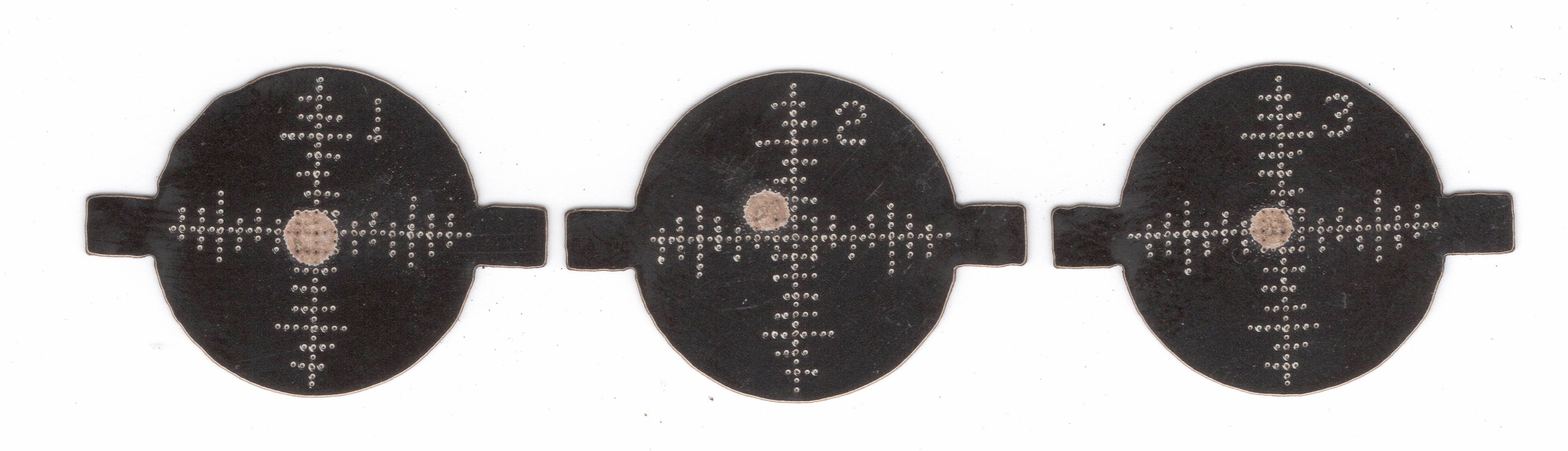

I’ve made CO₂ laser mirror targets:
The black layer is either present or ablated away, so it doesn’t provide much information on the energy distribution across the beam and I cannot retire my manila paper targets.

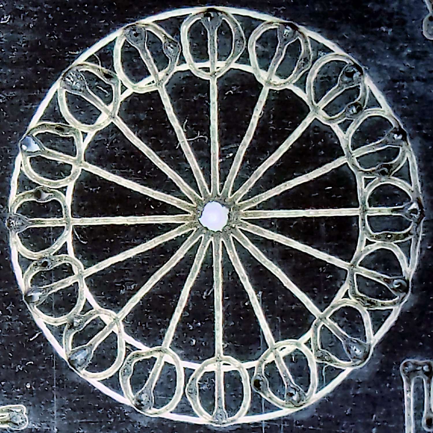

Tiny test patterns showing mechanical wobble:
Those are 1.5 mm circles inside a 10 mm OD outer circle.
