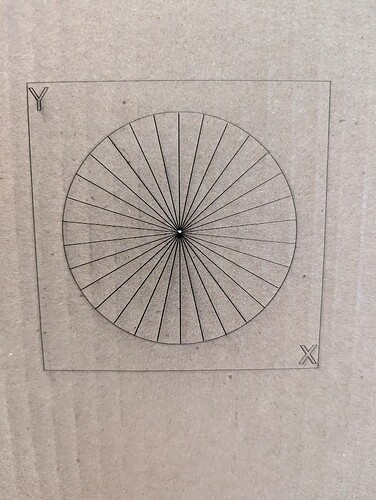

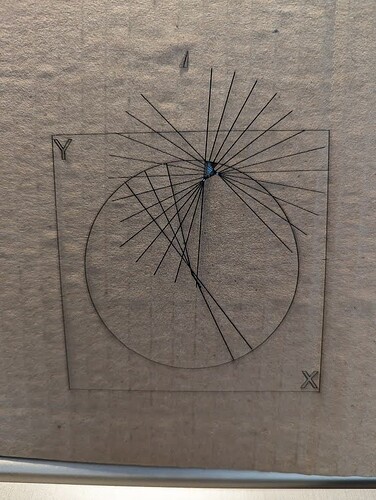

Once all that is done and firmware updated, try running this on a bit of cardboard
Dot Test with Angle.lbrn (46.3 KB)
Definitly you have a massive issue hardware wise somewhere
Can you recheck belts and cables?
GO over everything and take pictures if you want a 2nd eye on them

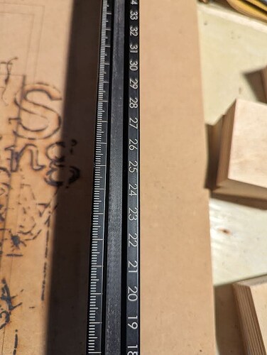

Visual guide on belt tension
hard to describe whats “tight” and isnt in words
Belts
they look find actually
So i can only imagine is something in the X (left and right)
or a cable that maybe is a little loose and as machine moves gives you a bad contact
I did everything that you told me to do and did another test.It came out [erfect!
I also tried the laser pointer tool and frame functions and they also work correctly !
