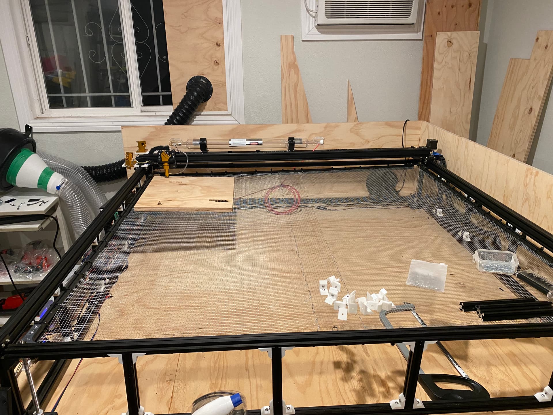

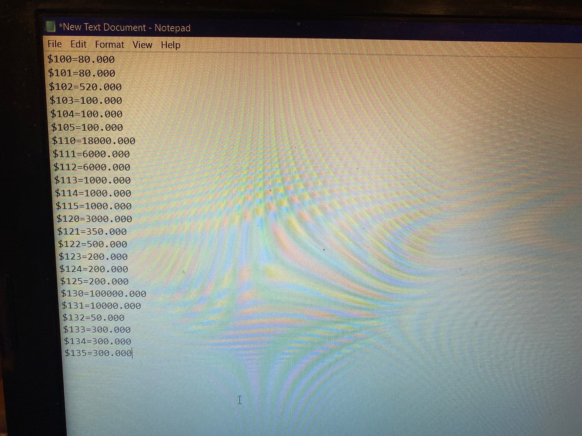

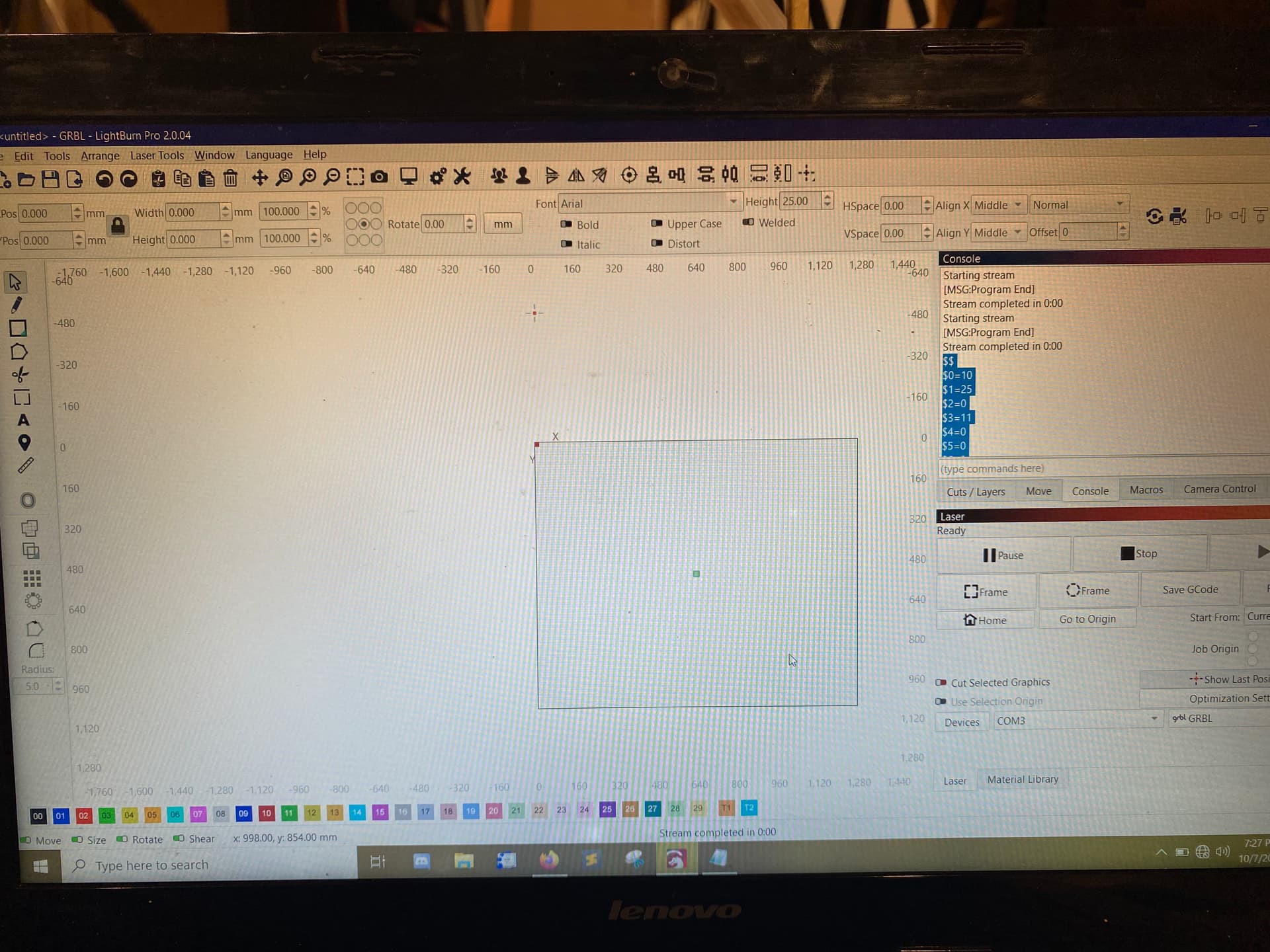

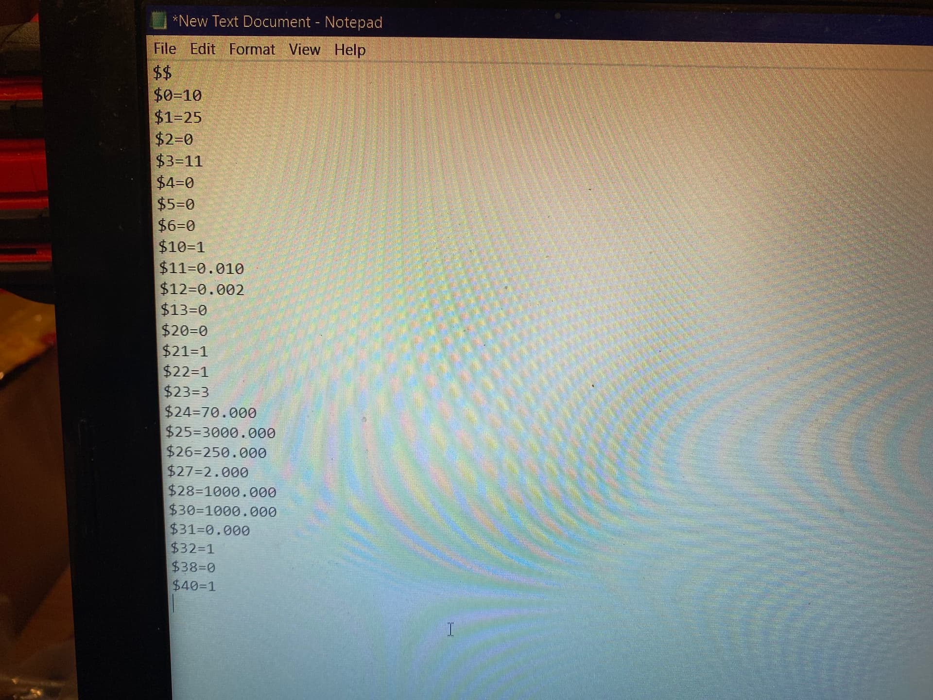

Hello, I just started learning lightburn and ran into an issue where my laser position is way out of bounds. I was wondering if there was a way for me to set the top left corner of the grid to be aligned with the laser position. There might be a better way and I’m more than happy to listen and learn. I will post a picture of the software, machine code, and I’m doing a DIY laser cutter with the limit switches to the top and left.

…$130 and 131(X,Y mm max) show some strange values… what are the measurements from your machine and what have you written in LB?
Which position does it report, once homed? Which firmware do you use? Standard grbl? Then $3 is incorrect.
First, connect via LaserGRBL and make sure that the movement arrows are working correctly (by setting a value for $3 between 0 and 7. Next, configure homing direction. Then check that the homing position sets a correct position (0,Ymax) in your case.
Once homed it goes top left. I use standard GRBL and arrows do work properly.
Which arrows? In LightBurn? Those do not count because you can change this in settings. LaserGRBL sends native commands, try that first.
I understand that it homes back-left. Which position does it report then?
