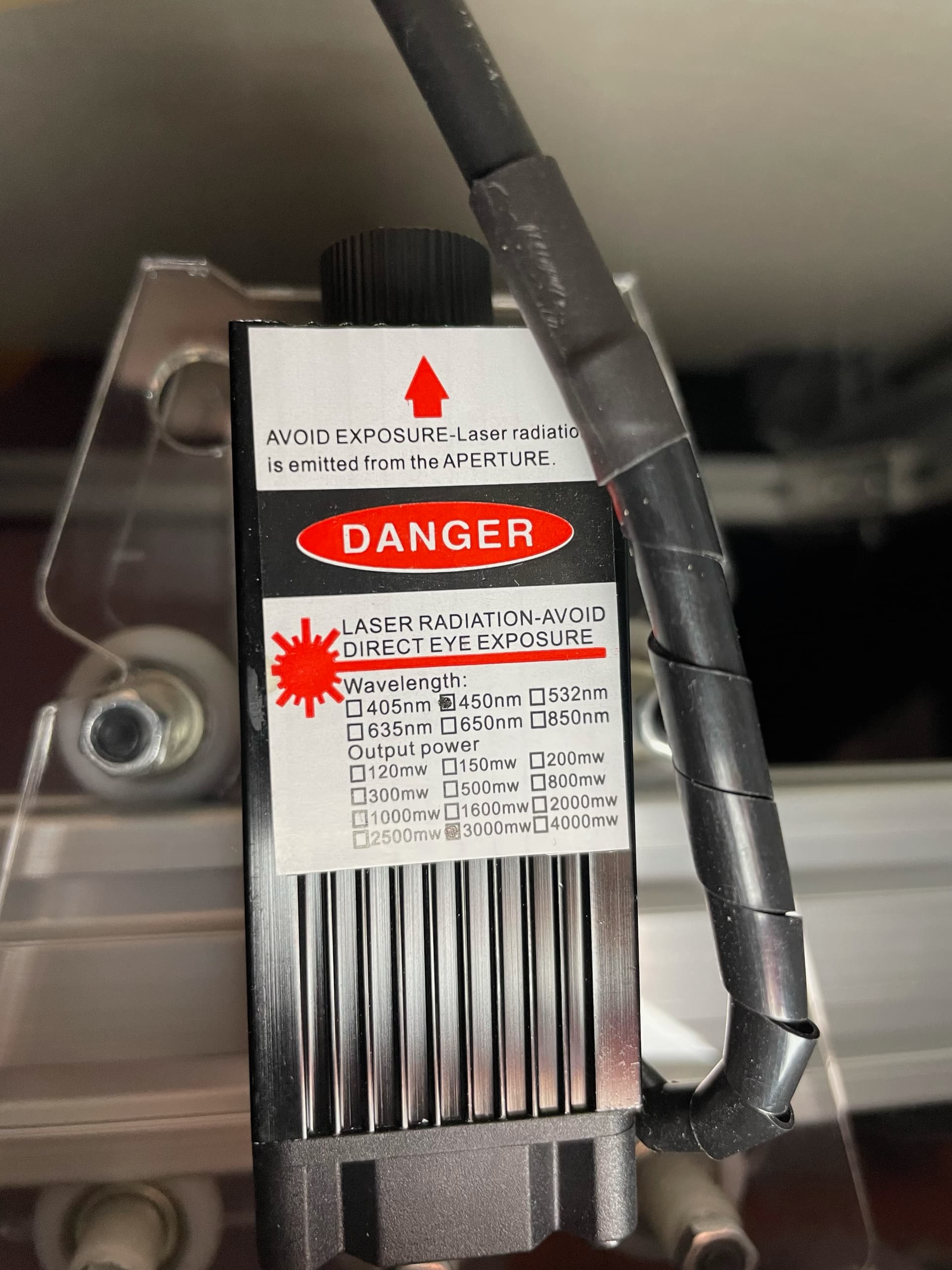

Trying to adjust the power settings on my Universal Engraver 3000mw CNC (grbl firmware).
When I set $30=1000 (to match S-value in device settings) the laser fires at such low power that it doesn’t even leave a mark. When $30=1, the laser works at full power, and adjusting the speed or power doesn’t alter the result.
What am I misunderstanding here? What other setting should I be changing?
Using latest version of Lightburn that doesn’t have the minimum power settings button.

I suspect you’re just moving too fast for the engraving to make a mark. If your laser is indeed a 3W laser you’ll need to run relatively slowly to get any kind of mark depending on material.
- Change $30 back to 1000
- Set power to 80%.
- Change speed to 1000 mm/min.
- Test
- Keep reducing speed by 100 mm/min increments until you get the level of burn that you’re looking for.

You really only have 3 controls for how the engraving will work:
- Focus - make sure your focus is very tight. Is your laser variable or fixed focus? Fixed focus is a lot easier to manage since you only need to manage height from material. If it’s variable focus you need to make sure you have your focus procedure dialed in as it makes a huge difference in ability to burn
- Power - the higher the power the more intense the burn. I asked you to set to 80% because overheating the diode can shorten the life. However, you may need to go even higher if you’re not able to get a proper burn at lower settings
- Speed - As speed goes down, effective power goes up as you’re exposing the material to longer periods of the laser.
100 mm/min is quite slow for typical engraving speeds. This would be a more typical cutting speed. The low power of your diode is likely also contributing to this.
Are you able to upload the .lbrn file here that you’re trying to burn as well as a photo of the results you’re getting so far?
I am using spruce or pine applicator sticks.
I believe my laser is variable. I am able to turn the head on the focus to make the dot turn into a line and visa versa. I’ve set it to the smallest dot possible.

Okay. That’s good and what you’re looking for.
This is some sort of mechanical issue. From the text engraving it looks like you may have some issue with backlash as well.
I suggest a full mechanical review of your laser.
For the line waviness, I suspect the wheels on your laser assembly that sits on the gantry may be installed at an angle or possibly the rubber on the wheels is somehow damaged or distorted. It could also be that the rails that the wheels ride on are damaged or have debris in the groove. Carefully check for anything that would cause the laser to wobble.
It could also be that the laser head assembly is loose because the wheels are not properly tensioned against the rails. You can adjust the eccentric nuts that are on the wheel axle to adjust the gap in that case. I don’t think this is the issue here.
For backlash make sure that all the pinions that are on the stepper shafts are well secured. If there is any slip of the pinions on the shaft it will cause inaccurate movement. Tighten the grub screws that secure pinions to the shaft. One of the screws should push up against the flat portion of the shaft. There needs to be no loose movement here.
Also check belt tension while you are reviewing. Belts need to be taught with no slack, but not stretched.
Make sure that the laser head has very smooth and free movement to all corners of the machine. It should be very easy and with no hitches.
As for power you may need to just go slower. I suspect your laser is just very low power but I’m not familiar with the behavior of your specific module. But 3W is fairly low.
One thing I noticed is that the height of the text in your design is 1.413 mm. But hard to tell but your photo makes it seem taller. Are you able to get dimensionally correct burns otherwise? As-in 100 mm square in design is 100 mm square burn?
