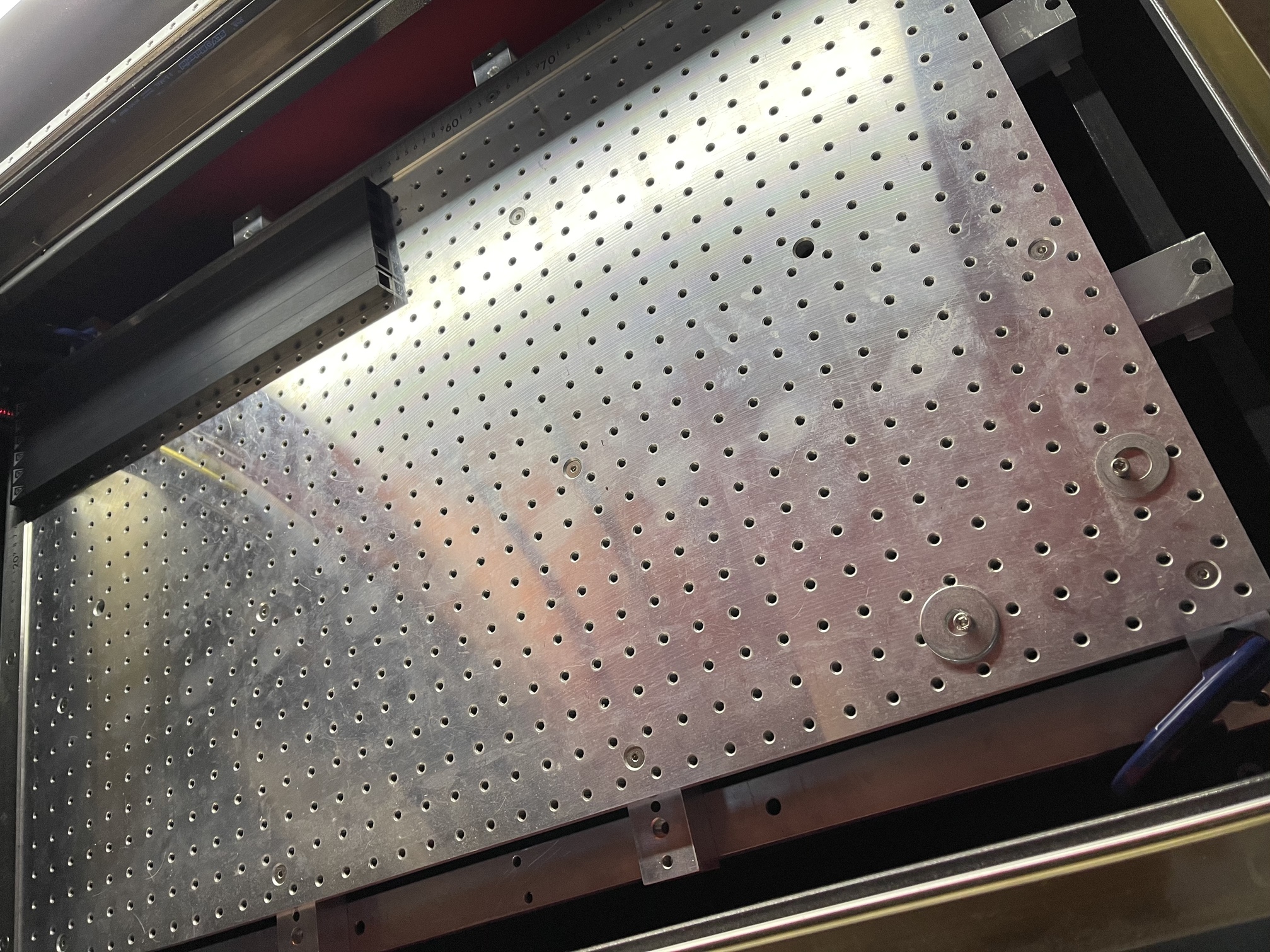

Our CO2 laser has a cut area of 600mm x 1000mm, with the tube mounted at the back along the Y axis, coming down the left side, then going down to the focusing lens. When the focusing lens is closest to the tube, the engraving depth is slightly higher than when the focusing lens is at the far-right, front end. So, when I engrave a 5mm square in a piece of 1/8" plywood in the top left at 10% power, it will engrave about .015" deep. In the front-left, it will only be about .011" deep, in the rear-right, about .007" deep and in the front-right, only .003" deep. Attempting to engrave a large piece is useless since it will be over-engraved in the back-left and under engraved in the front-right.The bed is trammed to the focusing lens within a few thousandths of an inch in all corners. Mirrors are properly aligned and centered to the beam at all 4 corners. My only guess is that the air itself is dissipating power, and the farther it has to travel thru air, the more power is lost. Is there any way to set up LightBurn to compensate for the power loss so that I can engrave something in any corner of the machine and get roughly consistent results? I’m running a Ruida 6445 controller and a 100w tube if it’s any help understanding.

This is what our focusing tube looks like… I don’t have a picture of the mirror alignments, but if I tape a paper target over the mirror entrance, it’s perfectly centered on the hole. If I remove the focusing lens (Lower 1.5" of the assembly, just below the knurled nut in the center, and tape over the bottom, the beam is still round and centered coming out of the tube. This picture was after I upgraded the bracket with a stiffer than stock one.

I’ve had that issue engraving anodized aluminum. I found that the issue was the flatness of my bed and it’s being out of parallel with the laser plane. I machined a new aluminum bed and shimmed it carefully to the gap between the bottom of the laser tube and the surface of the bed. Best upgrade ever. Now I get the same depth everywhere
If you don’t have jack screws, that’s the best you can do. Adjusting the individual jack screws can be a PITA, but at least it’s a one off job.
