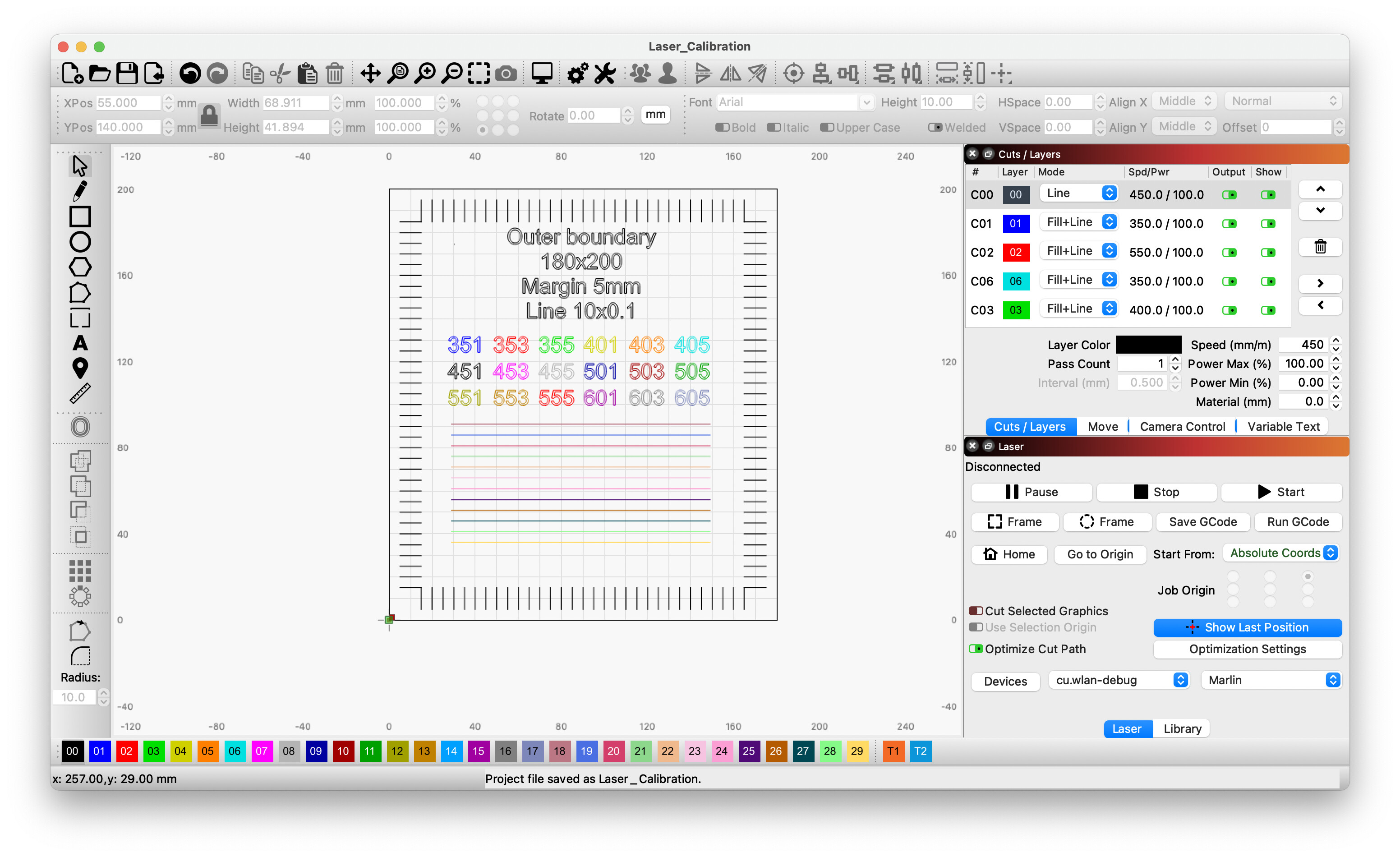

Laser Profile & gcode doesn't match
Have you tried actually burning the design? I’ve found that most of the commonly available gcode viewers somehow don’t handle laser gcode correctly.
Thanks, Man. I burnt the code. It was accurate. I checked the code line by line. Then I realized that the code doesn’t have any error. Somehow the viewer isn’t working correctly. Do you have any suggestions for better gcode viewer?
Not really. Your best bet honestly is using the Preview in LightBurn. It does a really good job of showing you the laser head path.
Report back if you do find a good external viewer. Others here have expressed a similar need.
