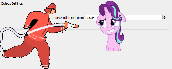

On radius’s the software sends pulses to laser and results in needing another pass to cut through. Do I have a setting wrong?

Ralph - is that what yours is set to? 0.05 is the default, and too low can “fire hose” the controller with data. 0.01 is probably too low - I don’t think I’d go below 0.025, and the 0.05 number is chosen to roughly match the RDWorks output.

I literally laughed out loud by my ridiculously low setting that I have had configured forever.
