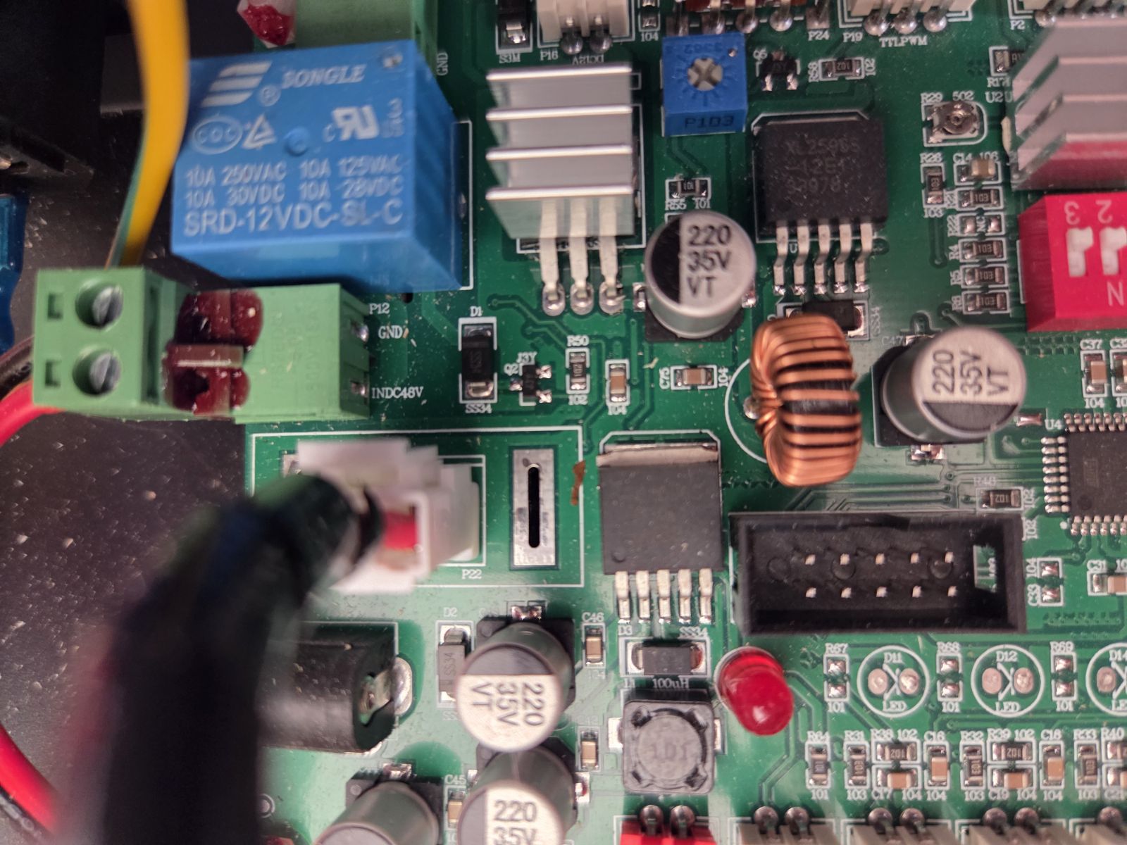

Hi Jack,
I was asking this info for my brother who owns this table. He said he has been over it and there is no identifying stickers of names or numbers anywhere.
he sent me pictures of the control PCB.
Maybe you can identify it and if it can run a 40W laser. I think he is looking at an LED laser from Laser Tree.
Thanks,
Kevin
If you upgrade and need more current, your motherboard is unlikely to be able to supply this extra current.
You can add an extra power supply for the laser itself, the pwm from the control board should be fine.
I don’t recognize the board, it has a mechanical relay, which most of these for lasers do not, so I’d think it was for a 3 axes cnc machine. But these type of machines are not what I generally work with, so someone could possibly identify it.
He’ll have to find out what kind of board it is to really find out anything. It appears to be compatible with a 48V supply, higher than most lasers in the hobby world use.
Mine runs off 24V, but they claim it can work with 36V, but don’t recommend it.
Thanks Jack. Have to see if he wants to run a secondary Laser Supply for 24volts
