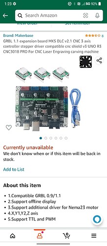

Am I right in assuming you have an Arduino based board? If so, you can easily use a pre-compiled firmware from LaserGRBL.
You can even use LaserGRBL to install the firmware.
You probably want to use the firmware marked “v1.1h, custom, XY Homing 20190830” as that eliminates Z homing.
Flashing Grbl Firmware – LaserGRBL
This the board im using. Ill try the lasergrbl firmware first as I really want to to configure my own. Just dont have time for that. Thanks.
